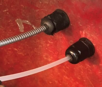

Running the cable is easy enough. I use cable glands instead of grommets in the firewall. Glands seal completely. You can get plastic or stainless steel cable glands. They're inexpensive, and Amazon sells them.

ranger how do you use the cable glands on a manual choke,the process

Pick the location you want the cable to pass through the firewall. Drill the hole to the required diameter for cable gland. Insert gland from engine side. Thread on the nut from inside cabin. Pass choke cable through gland. Once you're done fitting choke cable to carb, tighten the taper nut on gland to seal it up. There's nothing hard about it.
I've got two cable glands here. Left is choke cable, right is vacuum gauge line.
