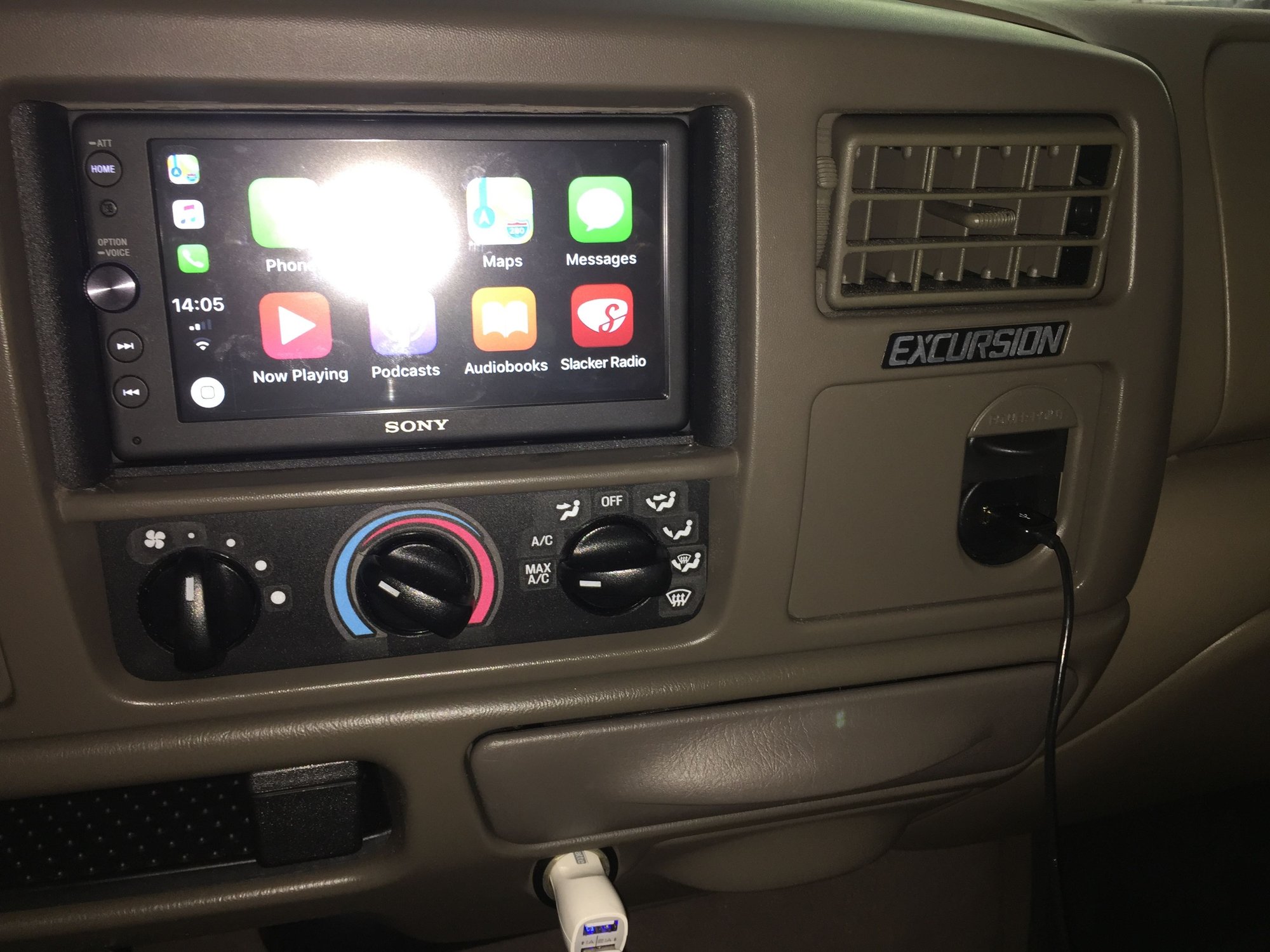

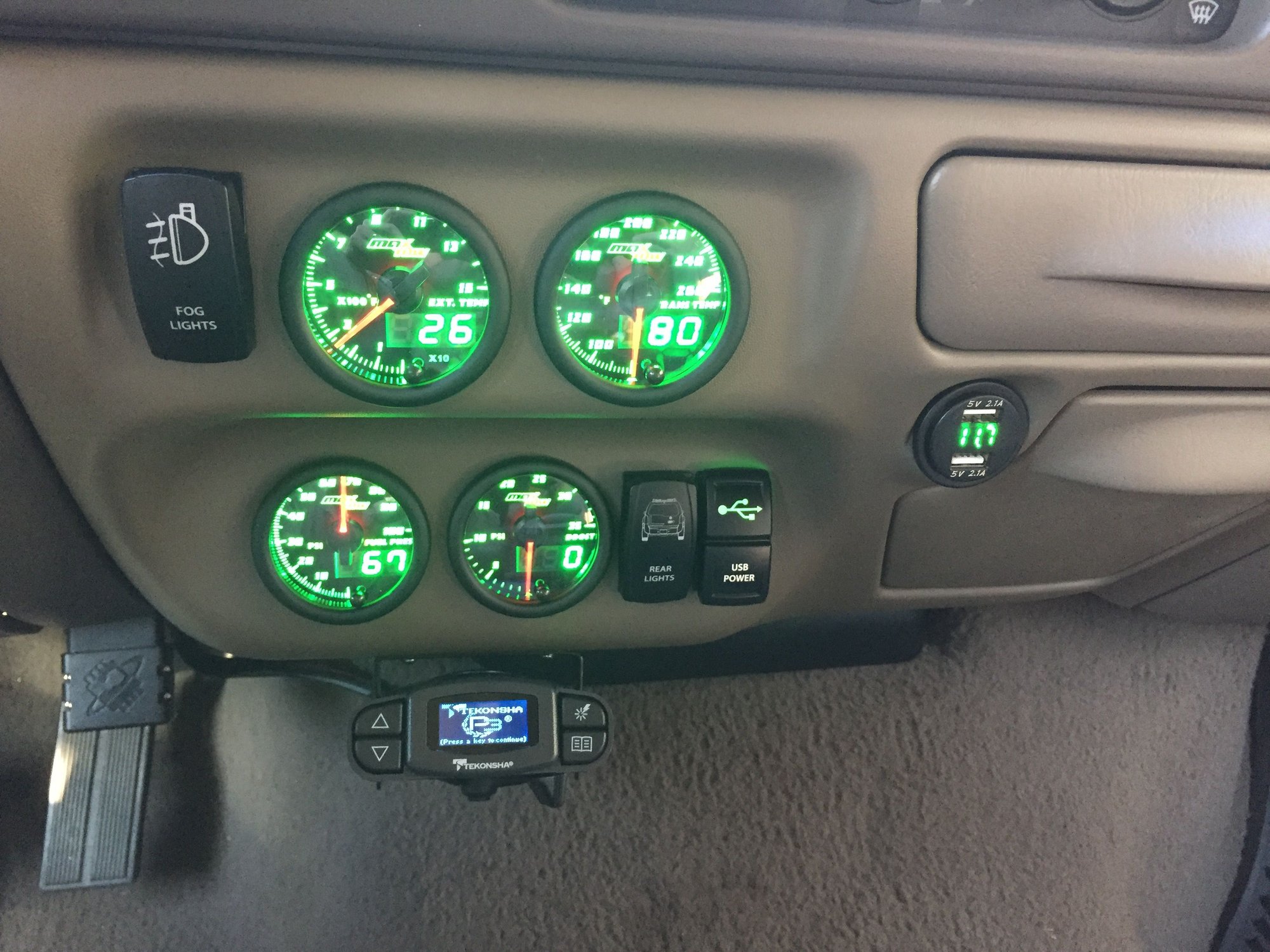

I did something similar when I installed my head unit. However, this is just a USB extension that plugs into the back of the head unit. I plug in my phone and get my Apple Car Play. Much better music and driving directions than a BT connection.
I installed my voltmeter USB charger in the other cigarette lighter hole when I did my F650 dash and gauge install.

you know these trucks well. I did a thread not long ago about I/S labeled relays. Quickly, Cletus jumped in and reminded us how them are for starters, not glow plugs(he had a great thread between the 2), anyway, taking into consideration, i pulled the Frank Fritz move, into bundling the wires onto 1 relay, the AIH relay..Within completing, and KOEO setting and led switch NOT flipped, i had a faint led illumination..long story short, the blue wire for the AIH remains "hot" at 3.xx volts, thus, keeping led lit...ill take a gander later with multimeter and my uvch plug w/wires readily at my disposal for testing..
Army..looks killer, man. Ia lso have the manual f650 in my auto 02. Now, seeing your setup, gunna order anutha and afix in same location..contrast well with other gauges.
