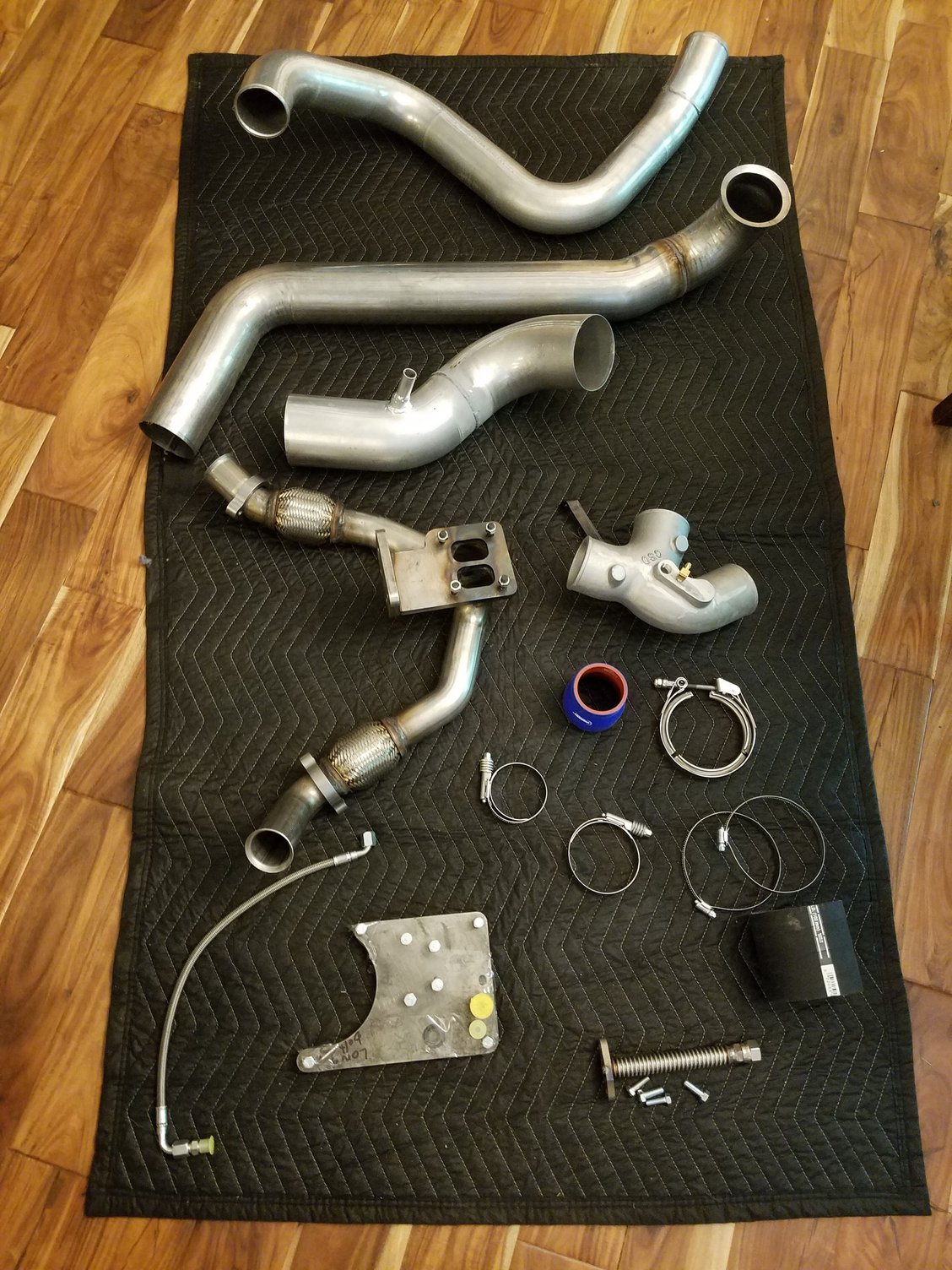

Originally Posted by Silverhks
Oh, I was thinking the Y was included in the kit
It is included. See the parts I received with my CSD kit below.
Now I'm really confused LOL
You can buy a 'kit' with everything needed to install a T4 style turbo from Carson OR you can buy the individual parts. I suspect Brandon wants to buy the turbo mount/up-pipes and then save the coin and DIY the rest.
