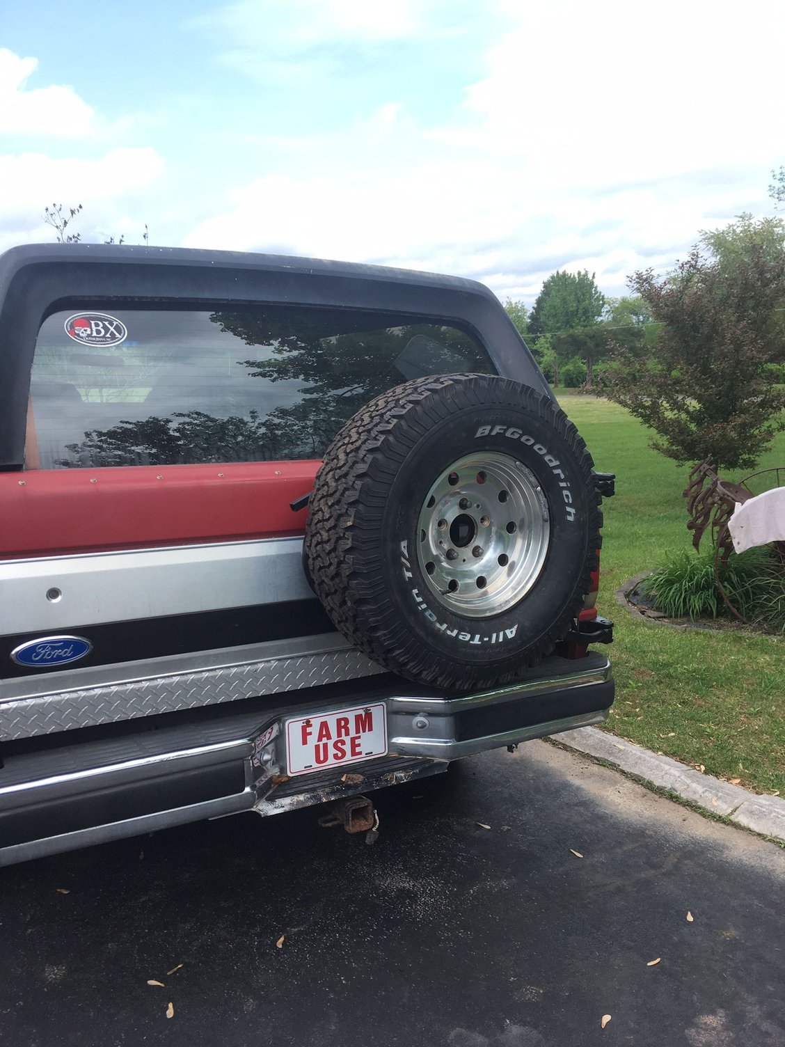

Those who are keeping up: got the new 32x11.50x15 tires on, though it's kind of hard to tell a difference in the photo. Got the fullsize BFG spare on too. I went to DMV and got a title, registration, and plates. The truck also (amazingly) passed the VA safety inspection and...... wait for it........ my parents insurance company actually insured the thing.
I bought this BFG All-Terrain for 60 dollars - it has been garage kept and is brand new!
What's the date code on that tire ?
Sorry - should have said "looks brand new". The date code is 2015. There is no weather cracking nor dry rot on the tire to speak of and it still has the rubber nubs on it. I like the look of these "KO1" type rather than the new "KO2" tires that BFG is making.

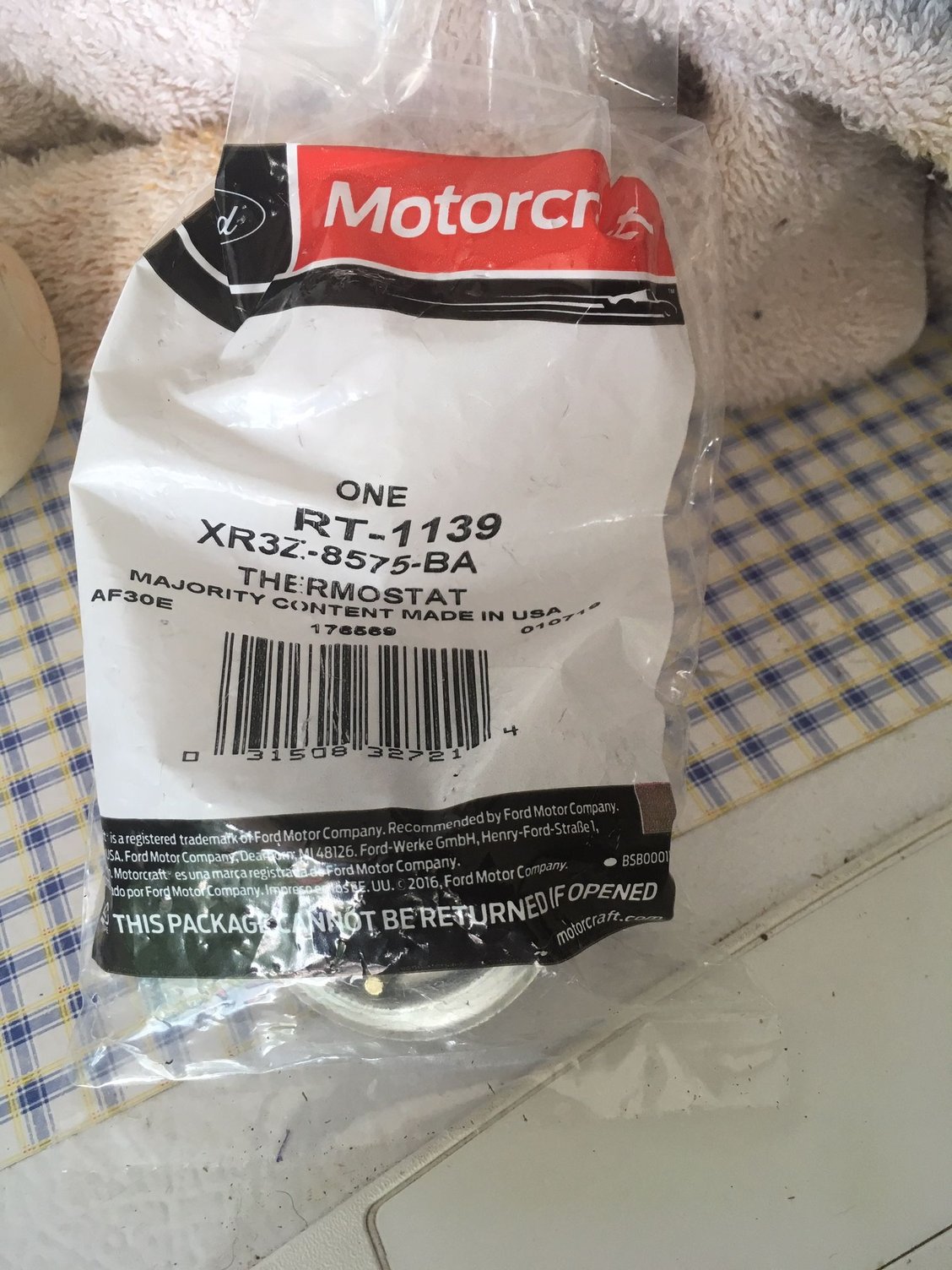

Got some parts!
Motorcraft 195 deg. thermostat. I listened to everyone's advice and chose Motorcraft when it came to thermostats. Now I can flush out the old nasty coolant and install the new thermostat. Maybe that'll help the truck warm up quicker.

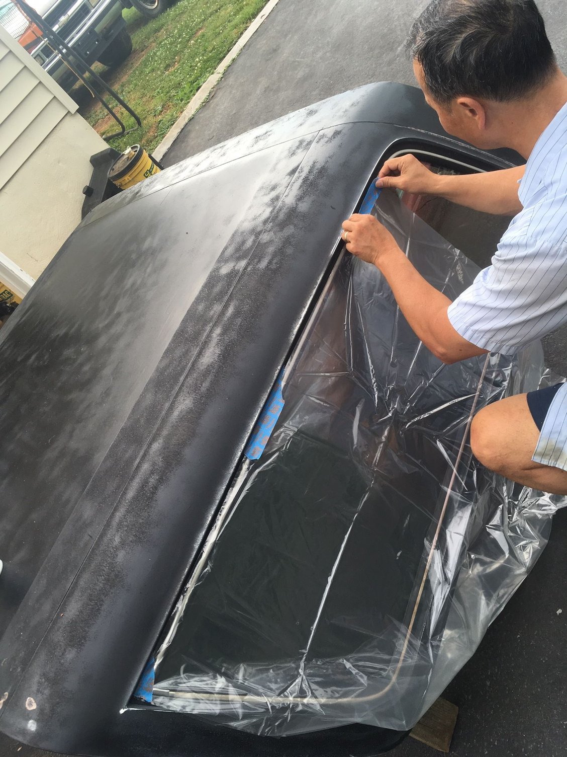

Here's what we did today:
Quick question: what is up with that square on the roof? It is smooth - doesn't feel like fiberglass and it isn't flaking off like the rest of the fiberglass on the top. Just curious.

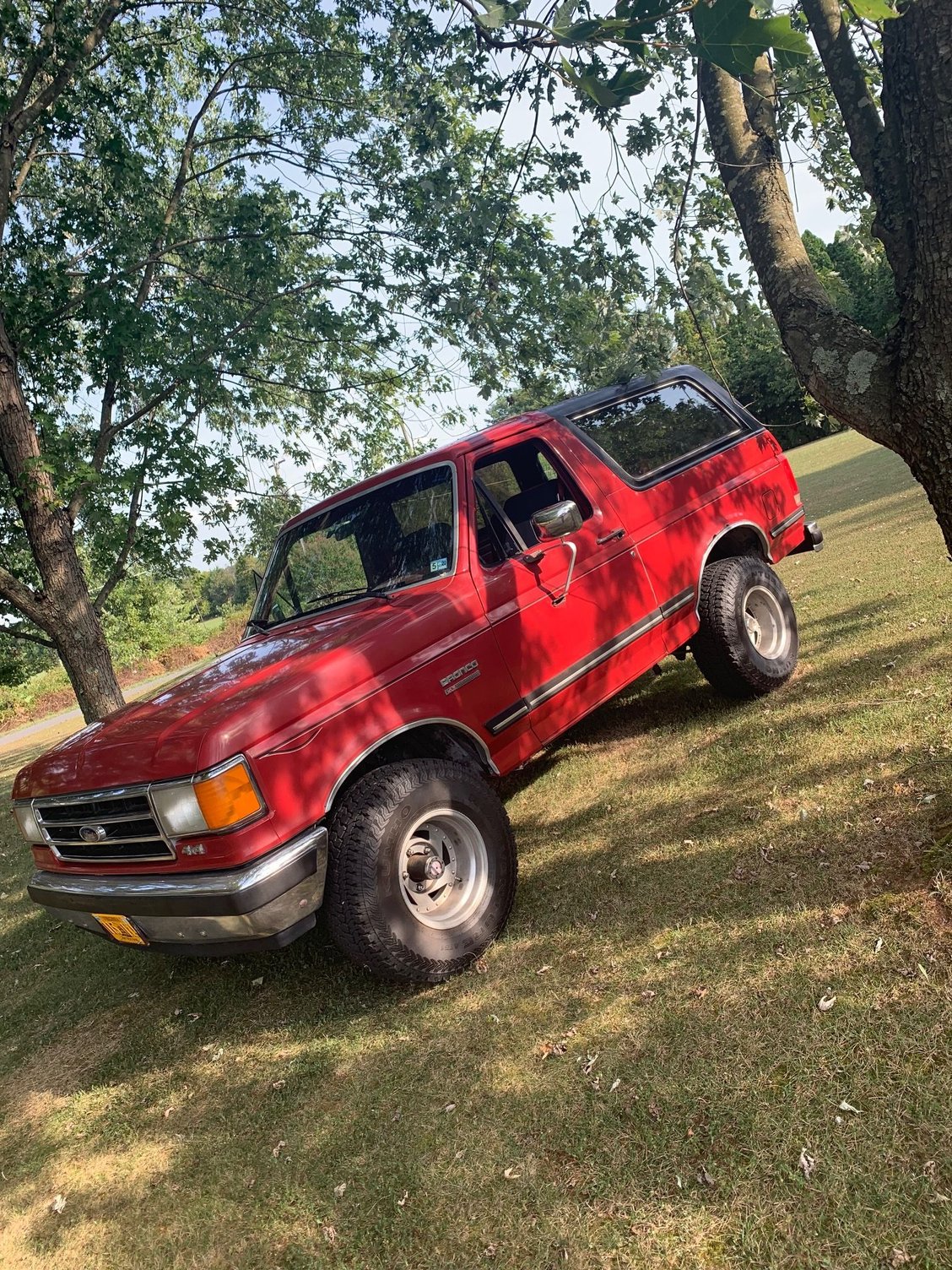

Well everyone - I just wanted to put the final capstone on this project for now. To recap: My little brother had wanted an 8th-gen Bronco for a while, but my parents did not have the money to spend to buy him a car. In a real "pay it forward" move, I found a 1988 XLT with the 351W, not running, for $1000. A little nitpicking and haggling, one smashed Dodge grille (funny story) and $750 later, and "The Red Baron" (that's what Andy calls him, it is apparently a "him" too)

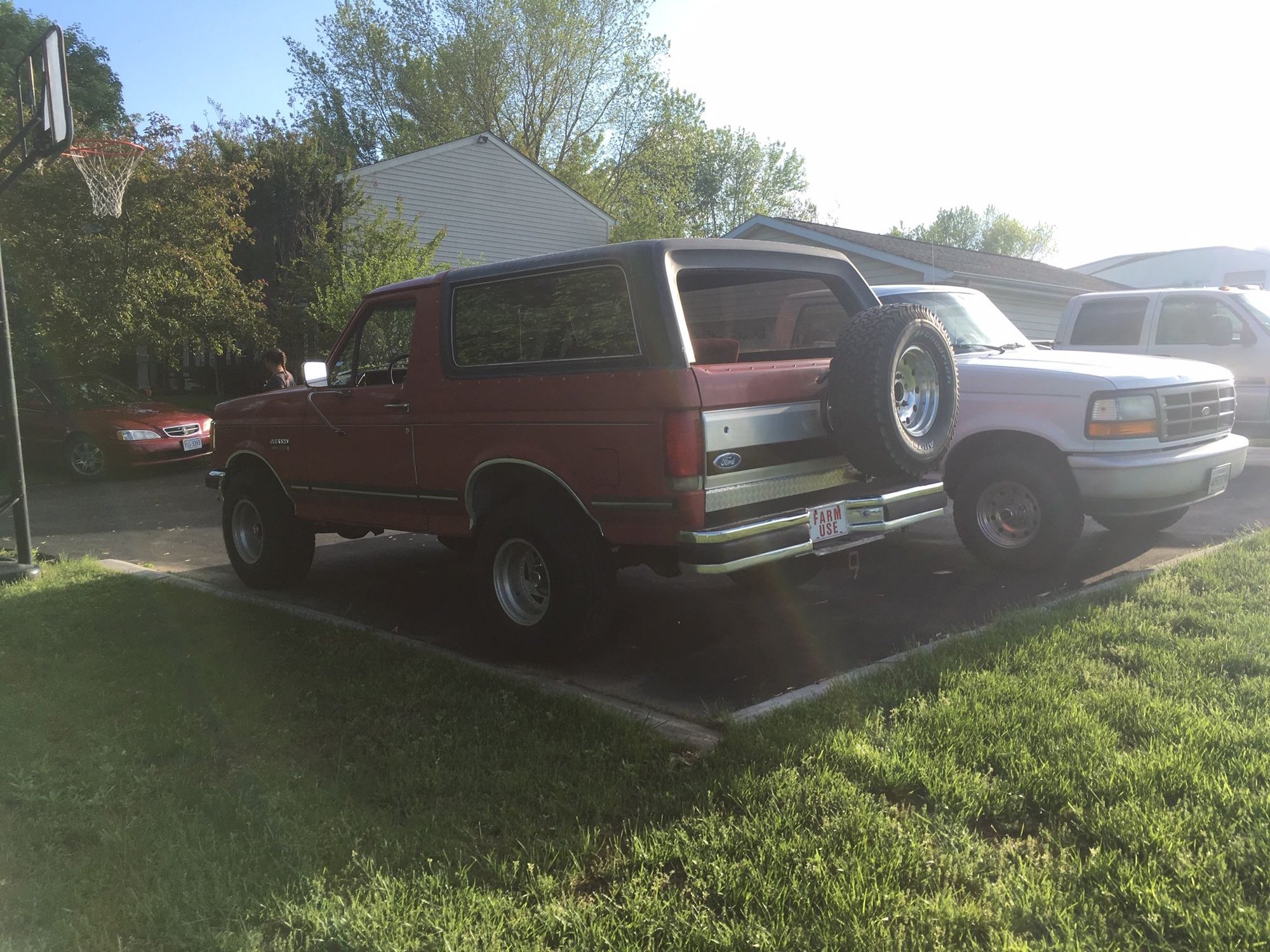

Just a quick look back at when we got the Bronco:
This was after we cut enough foliage away to even see the truck - weeds were almost over the hood!
I had read somewhere that most old cars just want to be run again when they're parked, and some TLC is all they need to run down the road again. Fixing the Red Baron taught my little brother a lot about how old cars work, and taught him some respect for things given to him. Heck, even my "Ford hating" Dad really pitched in to help fix him up and he learned a lot about old Fords too!
So without further adue, this is a picture of RB I took after work today, after Andy had just drove him home from the gas station:
Here he sits after a wash and 2 coats of wax.
After taking the summer to fix up the RB, I can understand the saying that old cars just want to drive again. The Bronco cleaned up very nice and the more we drive him it seems the better he runs. f course, it still has its issues. We need to replace the alternator and steering box, and he leaks a little oil and sometimes ATF (as any teen male's first car should). He's a real head turner at the local saturday night car show - a unique V8 4x4 in a world of blaise Jeeps that all look the same.
So, thanks for everyone who pitched in to help me, Dad, and Andy get the ol' RB to be a fairly reliable daily driver. I'll continue to update every once in a while with any extreme updates but for now, consider this project to be completed!
