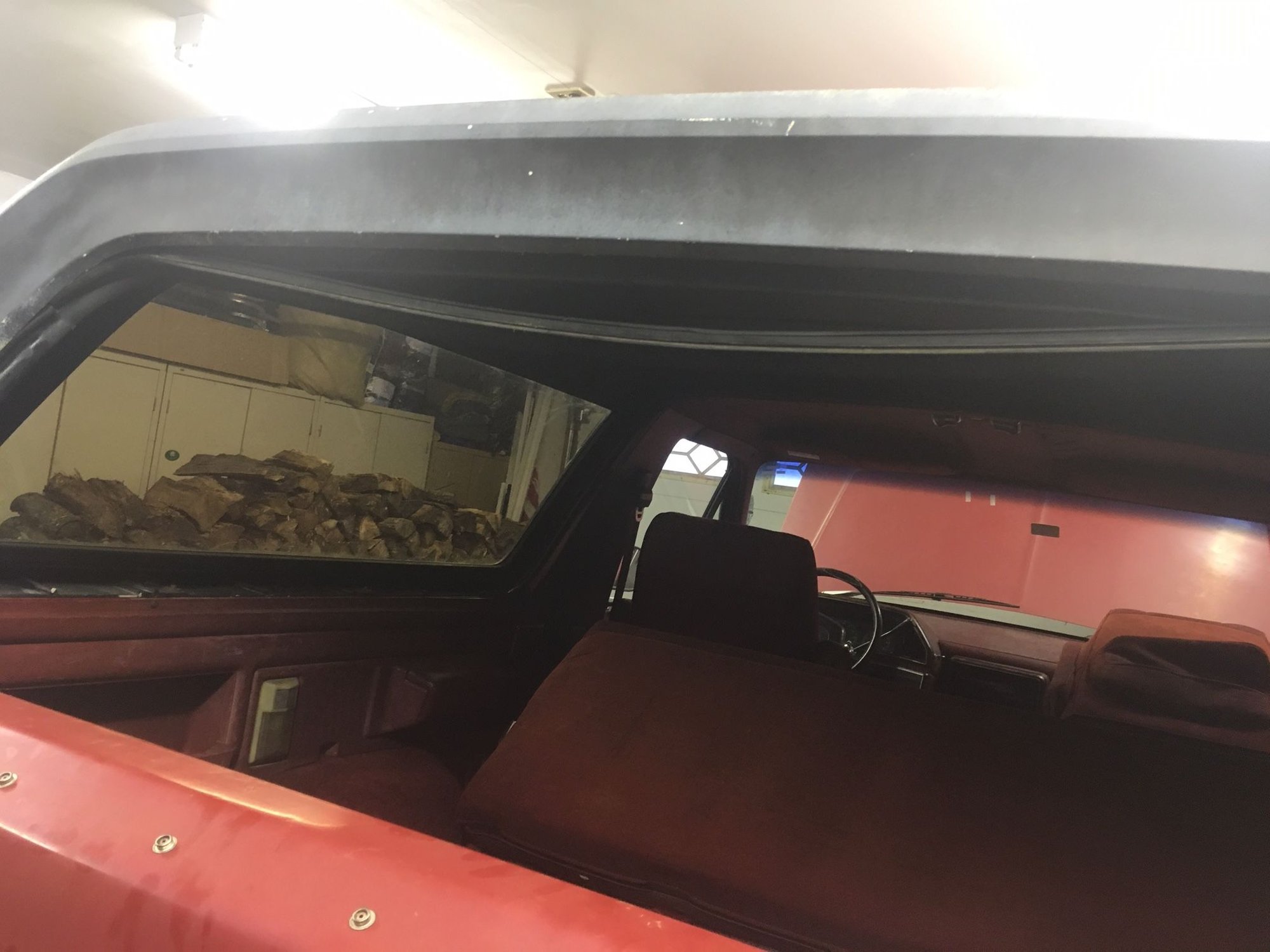

We're back in business guys! I've got three weeks to work on both this bronco and my truck before it's time to start a whole new semester. First things first: the new plugs, wires, cap and rotor are like night and day. The bronco fires up great now - also probably helps that Dad has been driving it around and has run a tank and a half of fresh fuel through it. One discouraging thing - as per Vinny's photo I found the little cord that hooks to the gear indicator. It's stretched out and it looks like the indicator itself is stuck. How hard is it going to be to get that piece out to see what's up?
Also, the "Ford hater" of the family went to the pick a part specifically to look for bronco parts. He found a 1996 to cannibalize he means well so I appreciate him doing so - even if all the parts might not fit.
A very important piece - our Bronco is missing the rubber all around the back glass so he pulled out a fairly intact and supple piece. He also got the trim out of the back of the '96, which of course will not fit!

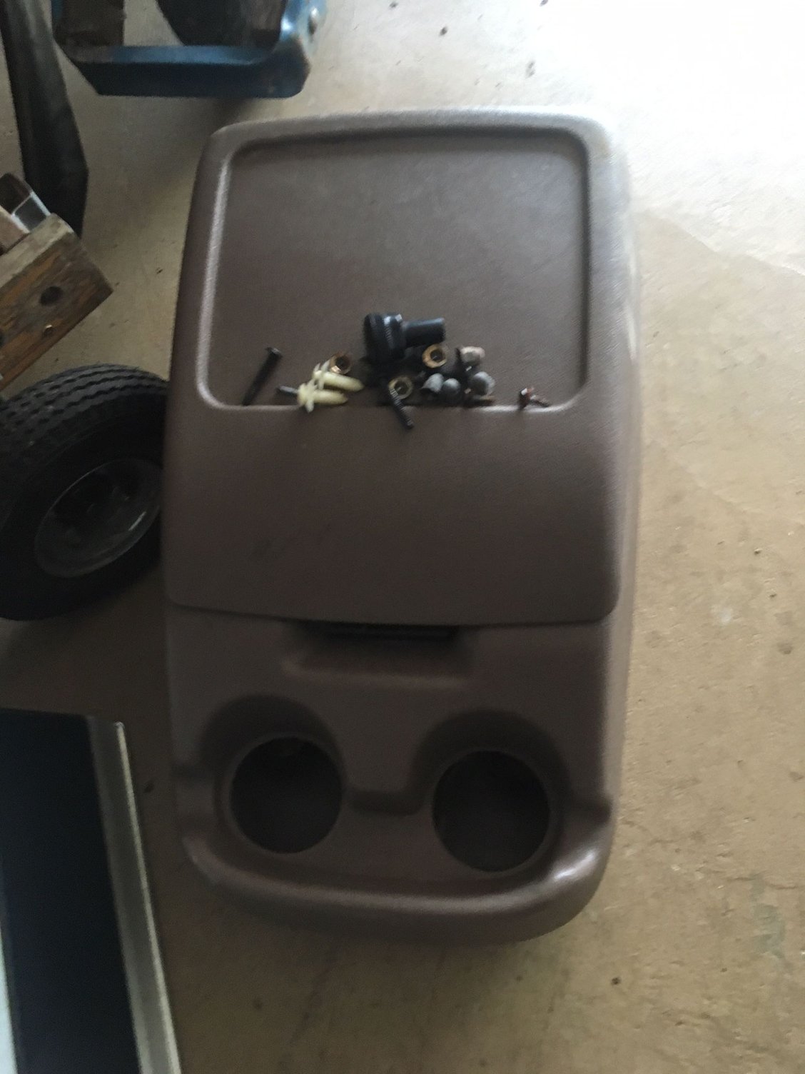

A mocha-tan 1996 center console to replace the smashed up 1988 one. If it bolts down we'll leave it.

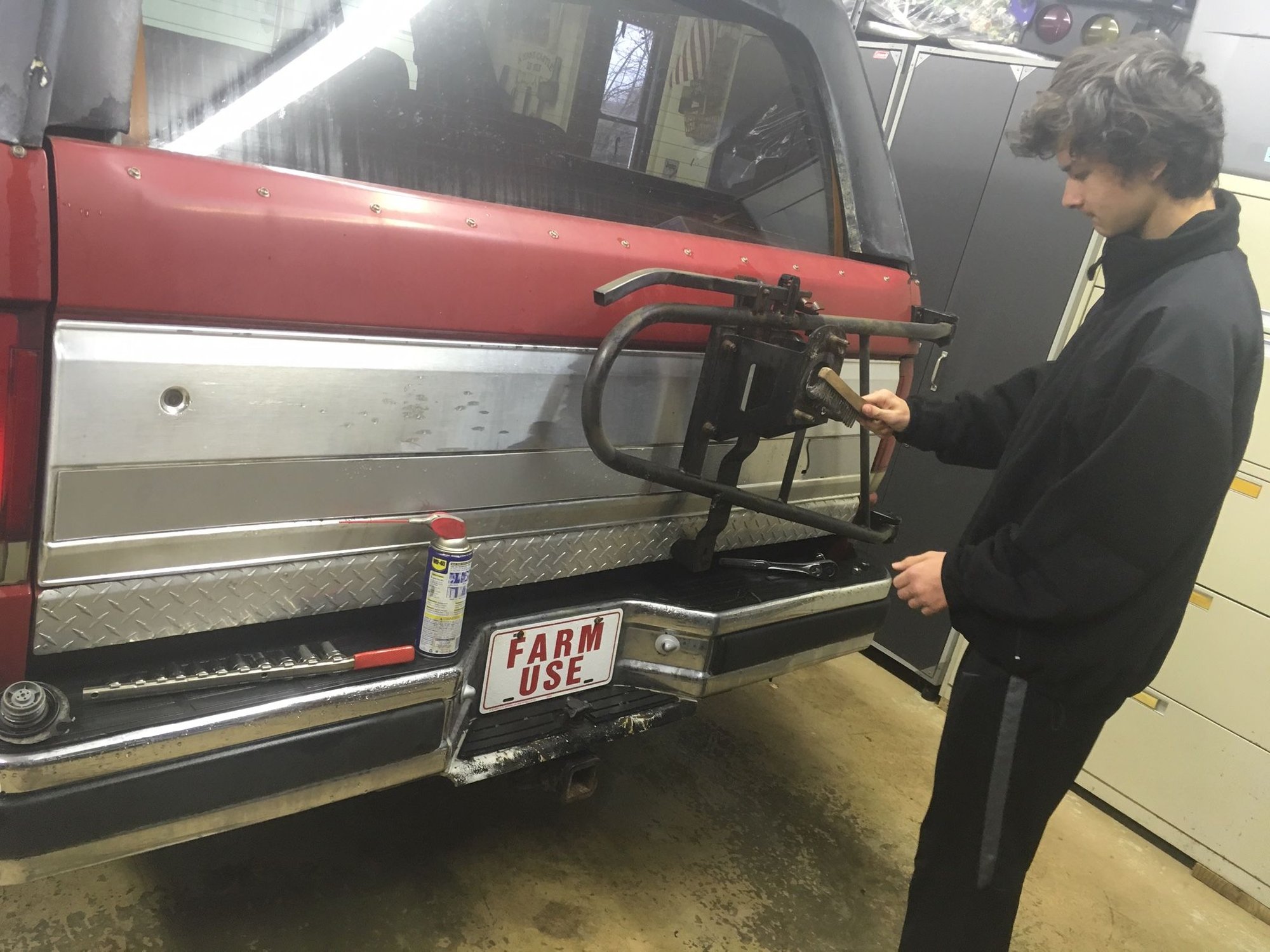

The most important piece! Our tailgate trim was missing entirely - rather than pull the black piece off he robbed the whole silver piece.

Andy gets some work time on his own car - cleaning up the studs on the spare tire carrier.

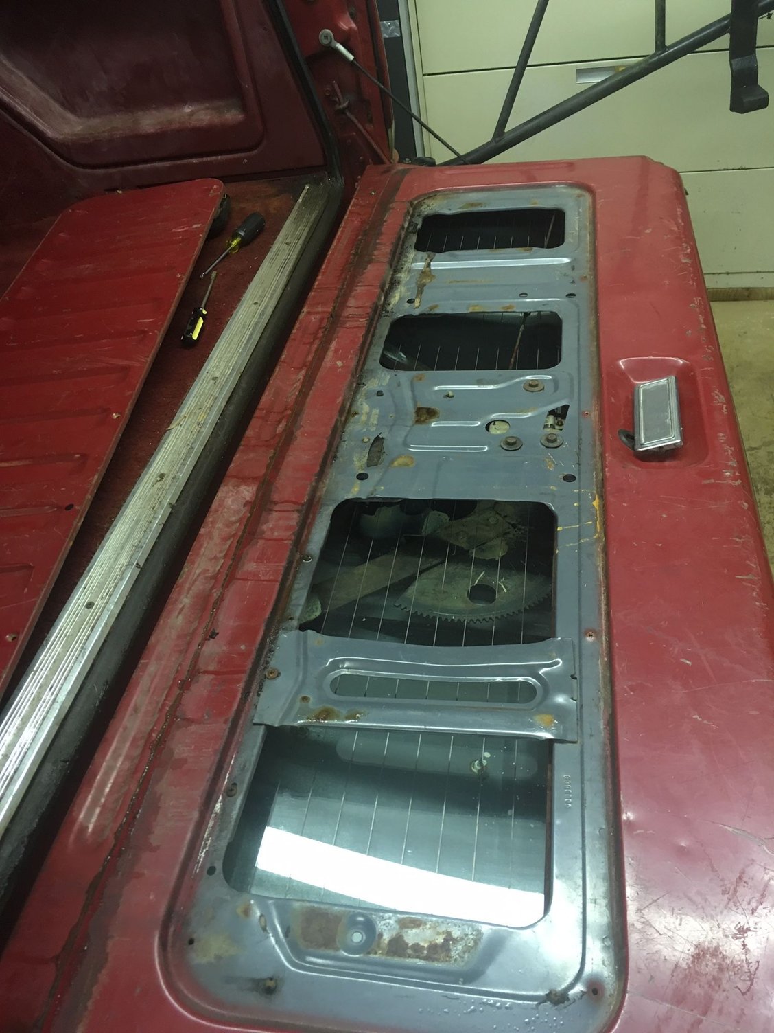

We had the access panel off to get at the trim bolts.
Look at all this stuff I pulled out of the bottom of the tailgate - made sure the drip holes were free and clear too!
Installed the window rubber out of the '96 BKO required drilling a few holes in the fiberglass for some pins.

We also put in the new center console - it didn't quite bolt up but Dad was insistent - especially after he found out that his other trim pieces wouldn't fit!!
