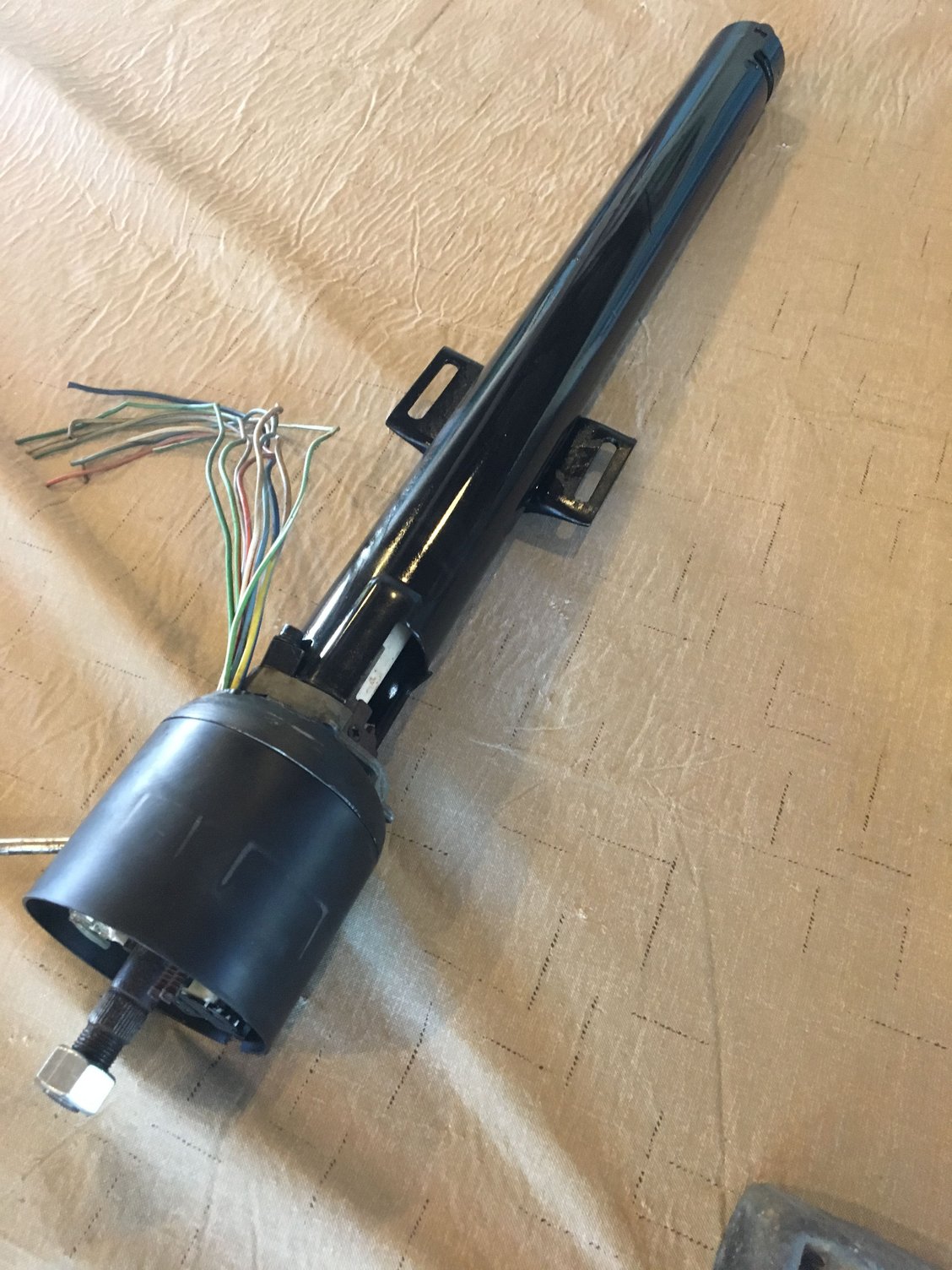

OK, one photo at a time...
Tilt head steering column reassembled w/o auto shift collar..
for some reason the photo did not attach??

tilt head is actuated by turn signal lever

Originally Posted by bajafishnut
Hope my photos can help someone identify what I actually have, and perhaps lead me to the standard shift collar, to replace the auto shift collar.
Why would you want a shift collar? None was used w/a 4 speed originally. This was used instead:
D9TZ-3790-A (replaced D8TZ-3790-B) .. Steering Column Tube Extension (takes the place of the shift collar w/a 4 speed) / Use with Tilt Steering Wheel / Obsolete
1978/79 F100/350, Bronco & Econoline.
btw: 1965/79 Passenger Cars; 1978/91 F100/350, Bronco & Econoline; 1980 Granada/Monarch/Versailles: Tilt wheel operated by pressing the T/S handle forward.
Probably 50% of the people that own these vehicles are unaware they have a tilt wheel.

Thanks very much Bill, and now I know what I have. I only thought of the collar, below the upper part, that holds the directional mechanism, because on evilbay, most of the after market tilt columns, have a reducing collar to blend the tilt head, into the column... Now, the auto columns had a collar, with the auto shift stick in it, and I assumed that some sort of reducing faring had been used. I am looking at a black 4" funnel, which may do the dame job, and cover up the part of the column that is open, below the tilt head... Sometimes, I just have to invent parts, that are not available..., or were never manufactured originally.. We'll see what I can come up with...
