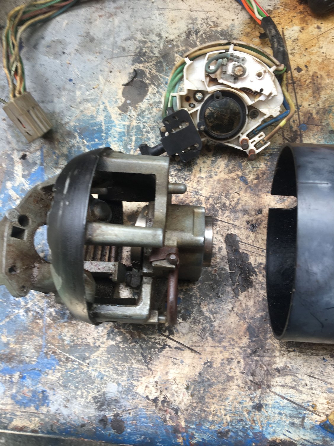

I am giving it another try, due to internet problems...
you can see the two little bearings in the tilt mechanism

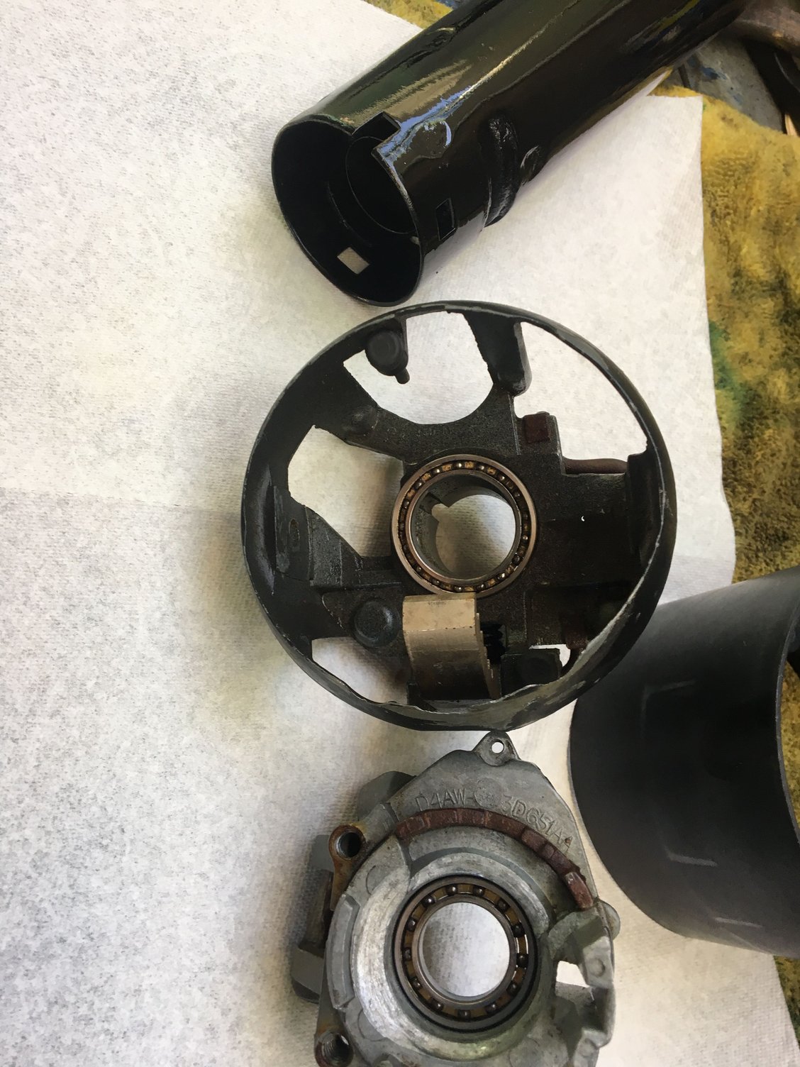

another photo showing the two small bearings.. one on the upper end and one on the lower, inside the tilt mechanism..

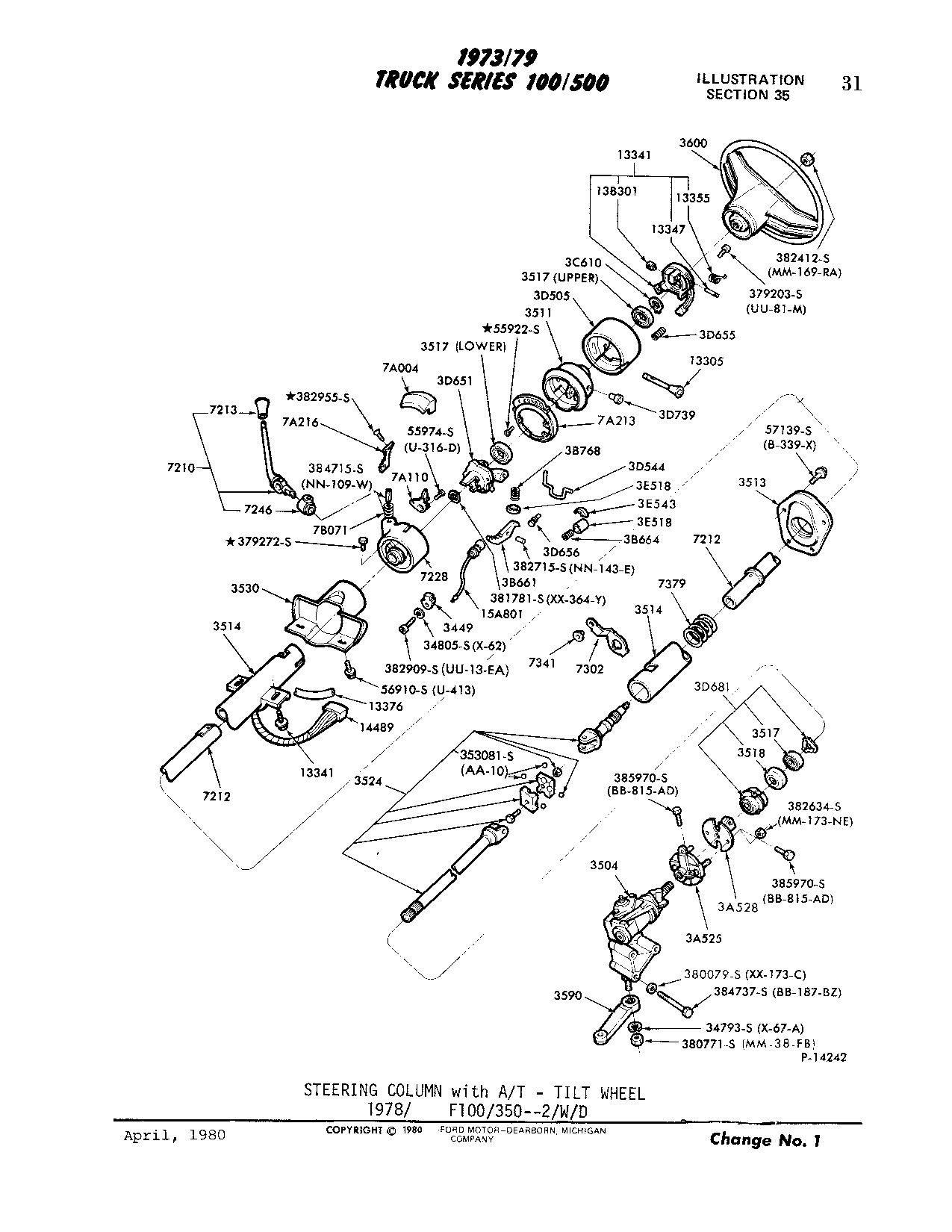

I'm looking at the truck parts catalog pic of the 1978/79 tilt wheel, see no little bearings.

and to ND, there are 2 small bearings in the tilt head, and one at the bottom of the column. I was told at the JY that it was from a 78/79 Ford, F250, and it had the automatic shift collar just under the tilt head. Since my truck is a 4 speed, on the floor, I will not be using the automatic shift collar, nor the shift tube which runs inside the steering column, or the auto shift lever. I believe that on the standard trans trucks, with the tilt steering, there is a reducer bell, that joins the column to the lower collar of the tilt head.

two tilt head bearings shown, in position, and the empty column at the bottom where the lower bearing should be?? Any help with where I can acquire them will be greatly appreciated...
A/T with tilt wheel: Upper pic: 4WD / Lower pic: 2WD

The two tilt head bearings, an upper and lower, which were different sizes of caged and sealed ball bearings, turned out after some persuasion, to be passable for use, so I reinstalled them with some liberal application of bearing grease.
