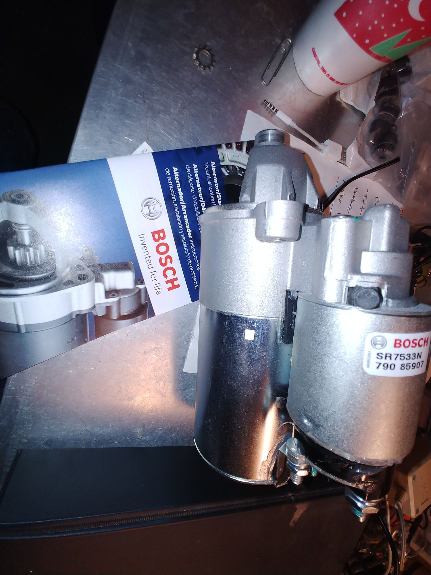

My 2006 E250 has a chronic starter grinding problem. Sometimes it will go weeks without an incident. Other times it will happen multiple times a day. I replaced the starter, no change. Replaced both the negative and positive battery cables with 2 awg marine grade cable along with new battery terminal clamps and a new 10 awg solenoid signal wire, no change.

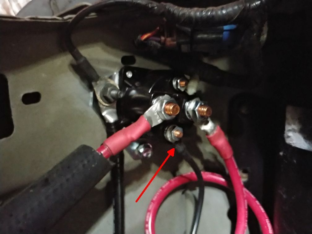

Despite replacing both battery cables, terminal clamps, battery, starter and ring gear, this has continued to be a chronic problem. Most recently to the point that on a couple of occasions, I was concerned that I was not going to get the van started.
So, here's my solution (hopefully)
I bought an old style fender mounted starter relay.
I removed the battery and battery tray.
I disconnected the windshield washer fill tube from the tank.
I removed the ground stud that's just in front of and a little to the left of the battery. I cleaned all mating surfaces of these two items.

Assuming you have the ground strap from engine block to frame installed it's a bendix issue. These starters have an issue with wear and the bendix will not kick out. Was the starter you installed a reman unit or a new?

Then, I chased the starter mounted solenoid trigger wire back up to the connector, disconnected it, (yellow wire) spliced it a new section of 10 awg wire to it and ran it to the s terminal on the new relay which I mounted using the ground stud and one self tapping screw.

I ran 6 awg marine grade wire from the battery to the new relay and then to the starter mounted solenoid. I also ran a new 6 awg ground wire from the battery to the ground stud/base of new relay.

So far it's been a week and all is good. Wish me luck. And oh yeah, one more thing to do...
