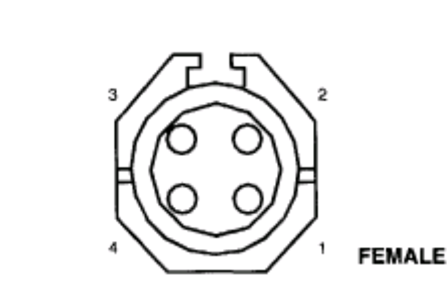

Download Forscan or if you have access to a scanner that can perform " Injector Buzz Test ". The test will allow you to listen to the injectors "click". The test will begin with key on engine off, and will first chatter all the injectors at once. After that the test will begin to "click" each injector in number order, cylinder 1, 2, 3.......ending on cylinder 8. If at any point you don't hear an injector then that is a suspect for a rough running engine.
From there check harness. You can also ohm out the injector coils at the plug to see if a cool is bad. At the injector plug, You would ohm pin 1 to pin 2 for one coil. Then pin 3 to 4 for the other. If you get no reading then it's bad.
Without Ford's scanner (IDS), that's where I'd start.

Originally Posted by 87crewdually
you can also ohm out the injector coils at the plug to see if a cool is bad. At the injector plug, You would ohm pin 1 to pin 2 for one coil. Then pin 3 to 4 for the other. If you get no reading then it's bad.
How do I ohm the injector coils? I have a voltmeter that reads ohms... I just don't know how...

Set the meter to Ohms, or if it has continuity with a tone to that.
First coil check.
One lead tip to the pin shown as 1, then the second to pin 2. If you have an ohm reading (or tone), it's good.
Second coil check.
One lead tip to the pin shown as 3, then the second to pin 4. If you have an ohm reading (or tone), it's good.
Wow that worked wonders. I was able to isolate an injector that was bad, tracked down a new one an hour away.
After changing it out, and getting it running again. It solved about 85% of my problem. There's still a little lag when I step on it (seems like it's not got 100% power.) But the engine is running good now! Thanks!
