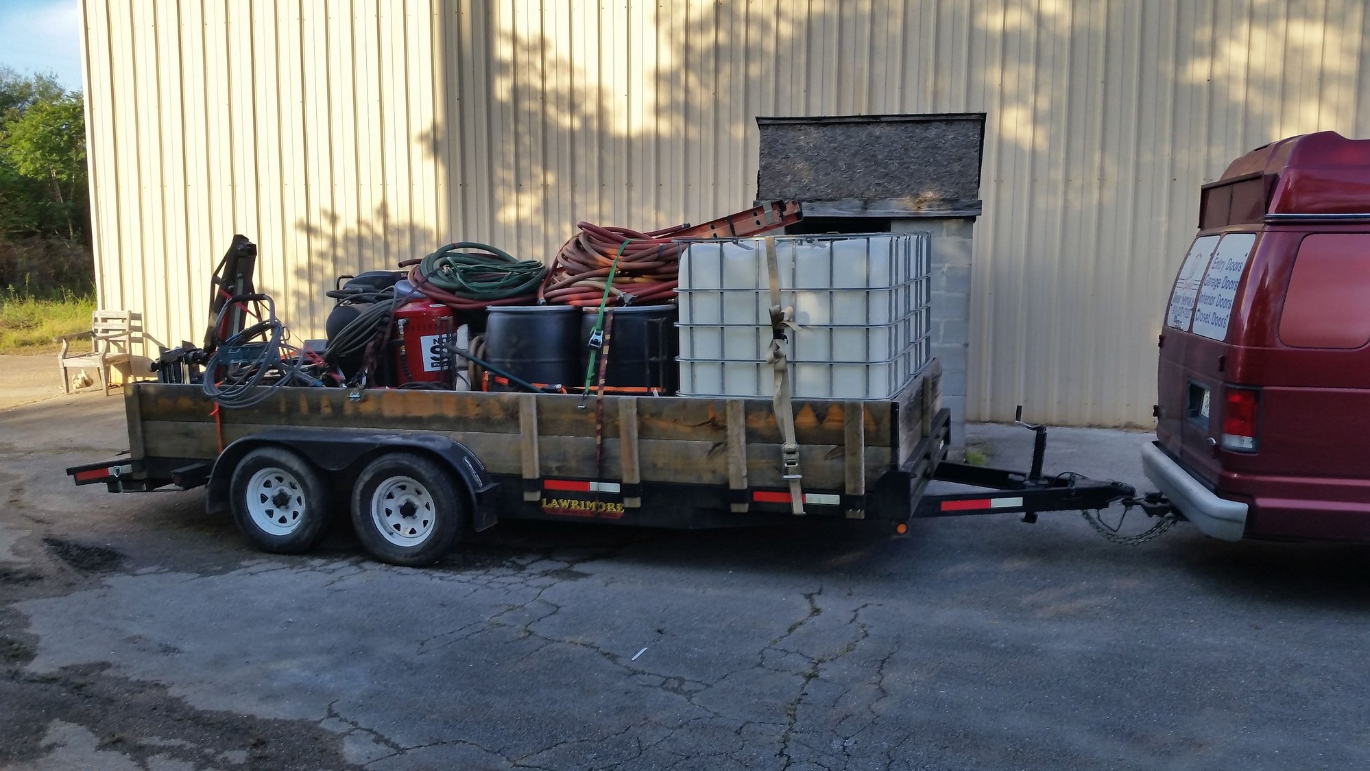

None at all. I get about 12.5 no matter what. A week ago my van was fully loaded and I pulled an 18' trailer full of crap down to Mississippi and got 12.58 mpg. I've owned many vans, all except one were Fords. Fords ride a bit rough. I had an 03 GMC Savanah 3500 as a work vehicle years back and it rode like an SUV. Nice smooth ride.
