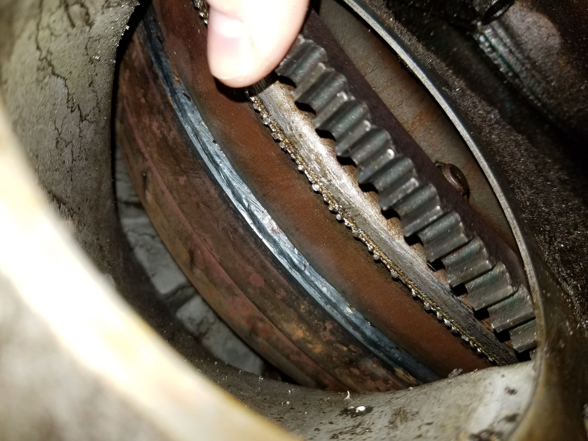

The freaking OEM gear on the flex plate just fell off yesterday.. It ran completely fine and had no noises, vibrations, or problems.. then I went to start it up at lunch time and it made a metal grinding noise. So i think great, starter isn't extending and its grinding against the flex plate.. open it up and I just see the ring sitting there like this.. Its like all the welds around it just broke all at once..

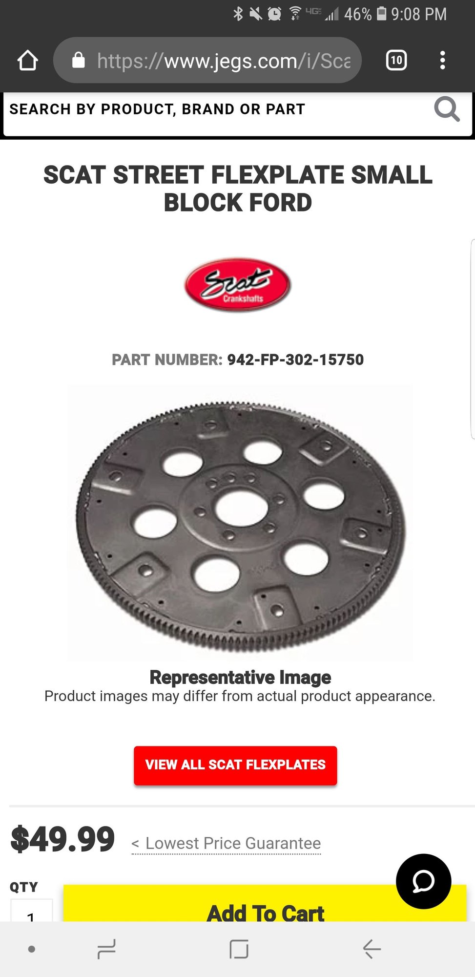

They are heated up and pressed (they really just fall on) for a manual fly wheel. But automatics have flex plates and they are welded on. Like in the photo. This is the plate i am thinking about replacing the broken one with..

That's not a oem flexplate, looking closer the torque converter is also not oem it's a rebuilt. My guess is during a trans rebuild it was swapped. Verify the torque converter is balanced when you have it apart. If you zoom in you can see the torque converter was lathe cut and re welded.

I posted the main issue above, the torque converter is usually what causes this. Especially seeing how poorly welded that reman torque converter is I would bet it's not balanced.
