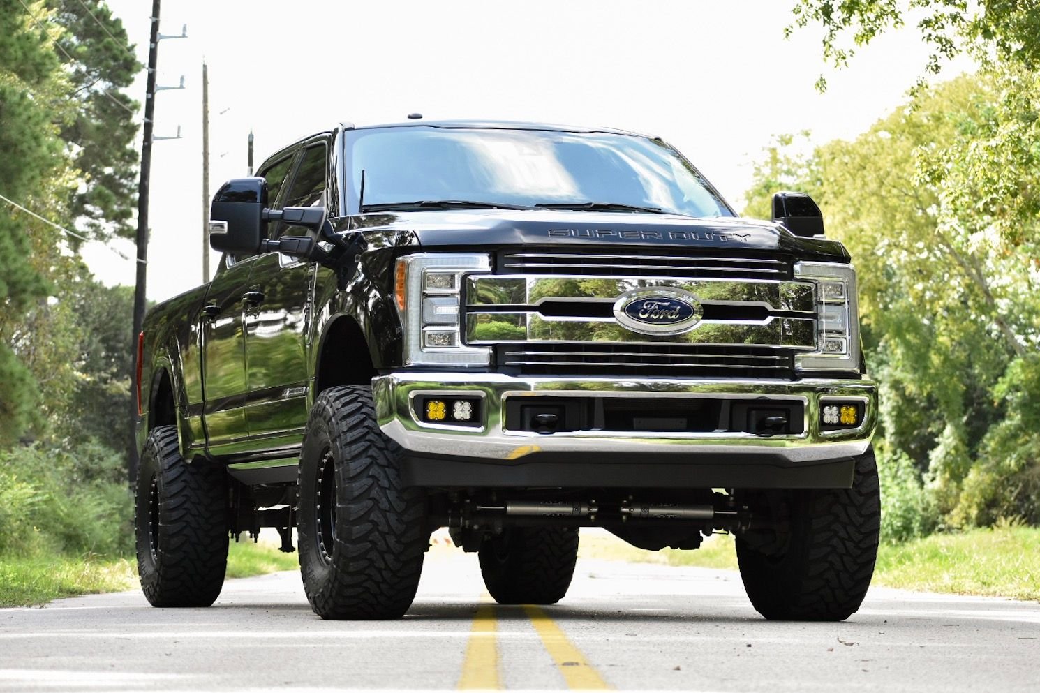

Here's how a 9" wide wheel w/ a 5" BS & 37x13.50's fit for reference.

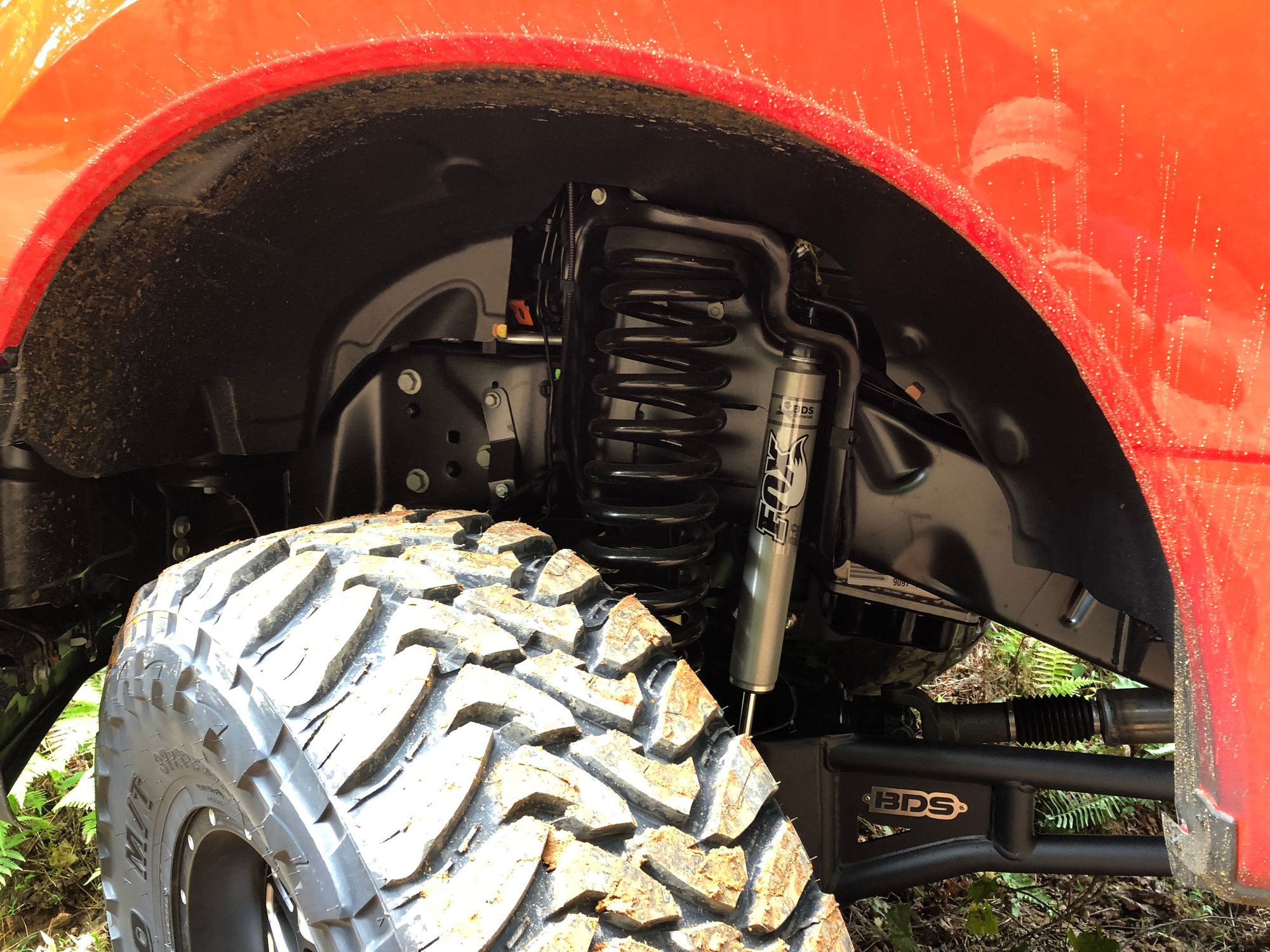

4" lift, 37x13.5, minor trimming of air dam and plastic guard at rear of fender well, great articulation without any further rubbing.
