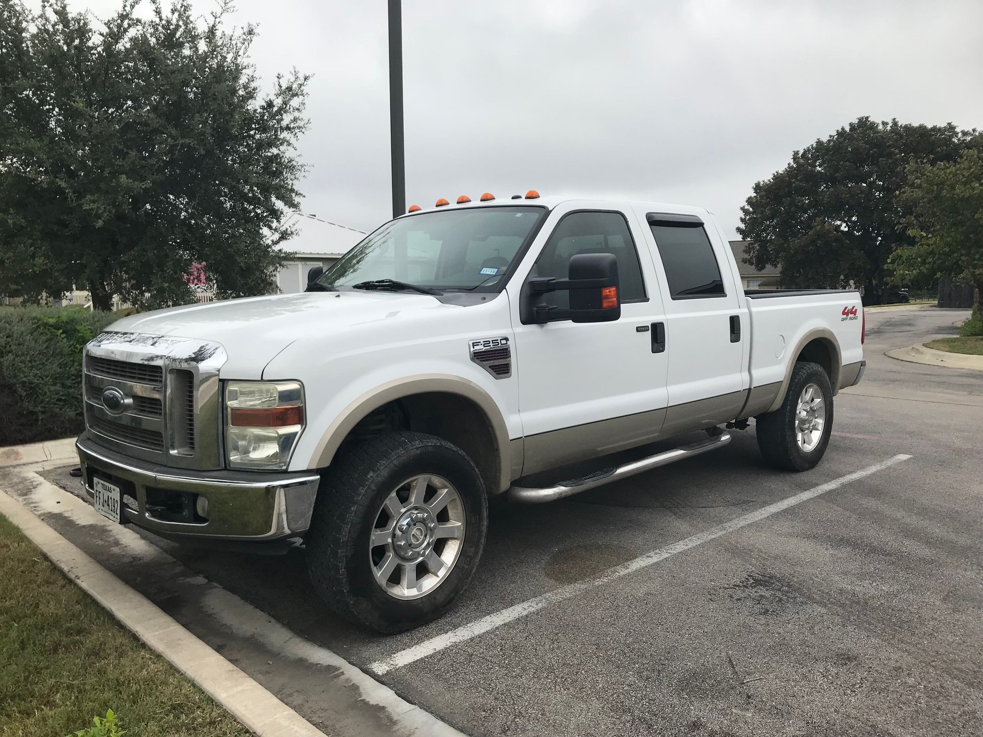

hello guys. So I picked up a new to me 2008 f250 last week. While driving almost every 10-15 seconds the dash, radio, gauges, would cut off and cut on constantly and the battery light was on. When I ran the codes I got a B1317 or high voltage. I measured the voltage through my scanner while driving and in fact it would jump up to 16-17 volts while driving.... not good. I checked the battery connections and the alternator and everything seemed tight and good, so today I replaced the alternator with an ultima 200 AMP reman alternator. First drive with truck absolutely no issues. Second drive the check engine light comes on and I have the same B1317 code, however nothing is cutting off so I am happy about that. Does anyone have any ideas of where I should look next?
