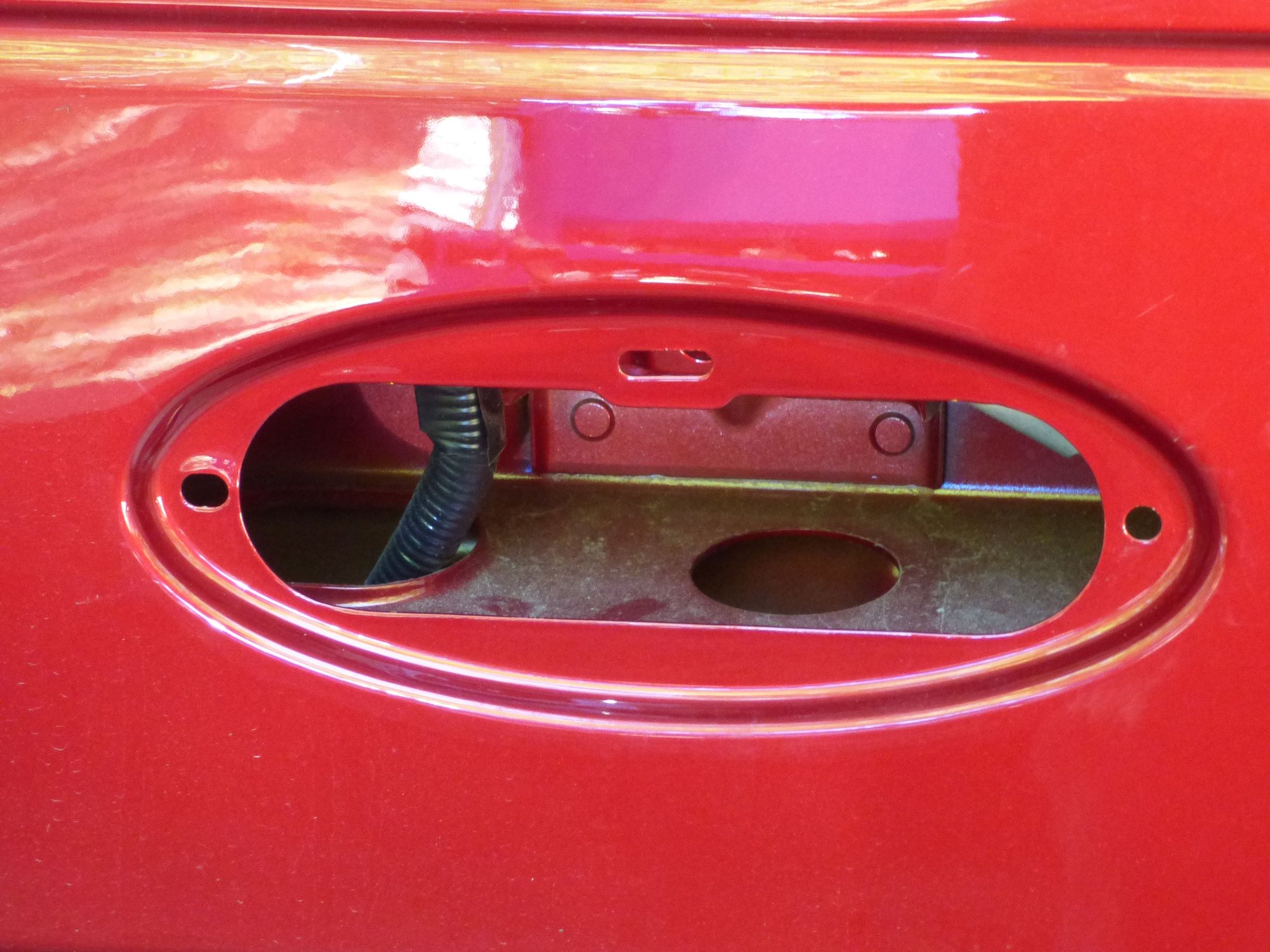

This is what the tgate looks like with the badge removed on my '17 150. No bolts, just 4 or 5 trim clips, and a little double sided trim tape. I just warmed it up with a heat gun and pried it off with a plastic trim tool. Take that access panel off and have a look to be sure there are no bolts on the 250.
Those 2 round holes are for locating pins.
