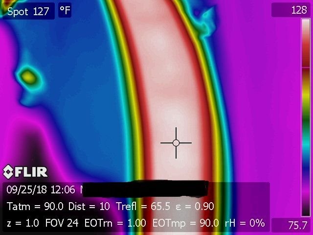

IR Images of drivers side brakes:

127,8° F doesn’t seem that warm for a sticking caliper.
I'm not positive its still sticking, as those images were taken at lunch yesterday after driving back from McDonalds. The sticking caliper issue was from the night before southbound in rush hour traffic. I didn't notice any issues with it northbound after dinner not in rush hour traffic.

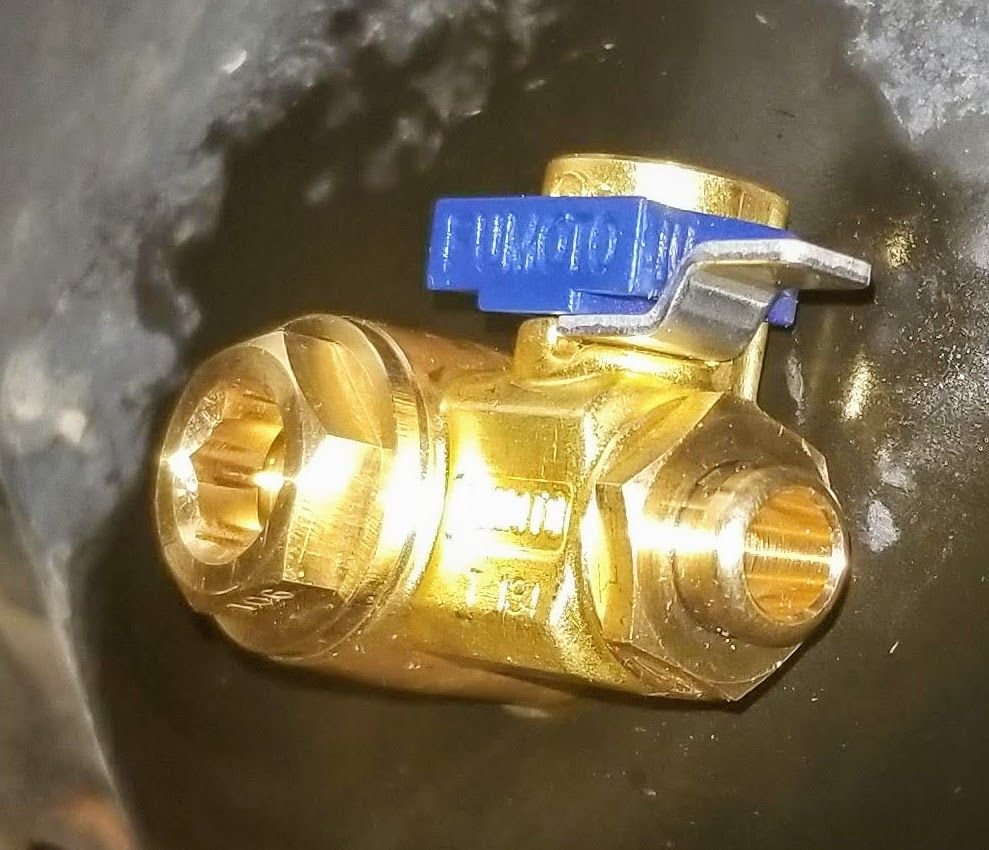

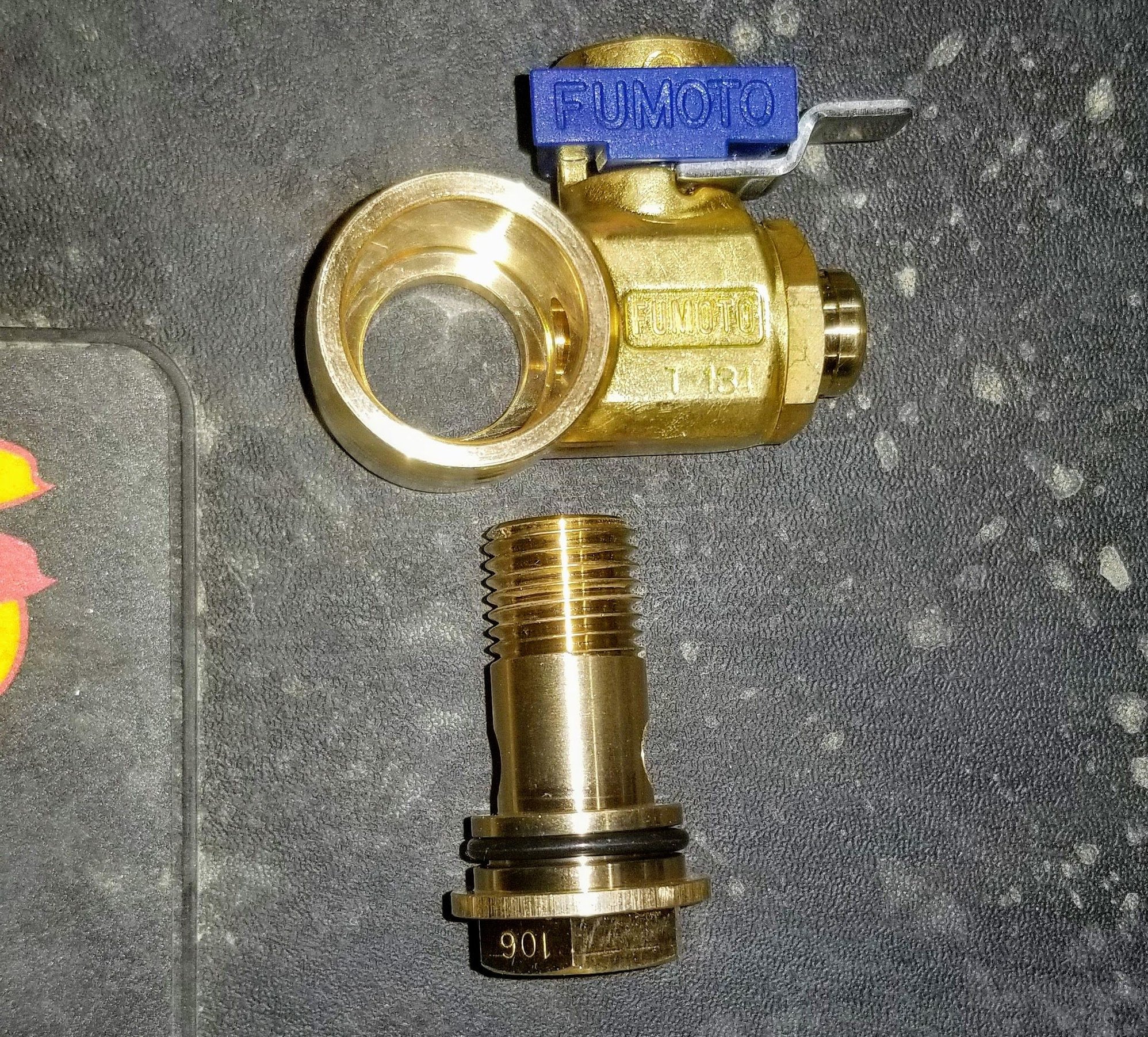

Performed an oil change; 6qts Mobile 1 High Mileage full synthetic, Motocraft FL820S, and a Fumoto drain valve.
Valve in its pieces. Also has a hose with fitting that snaps onto the valve for future oil changes to be much, much quicker.
Gratuitous tool photo:

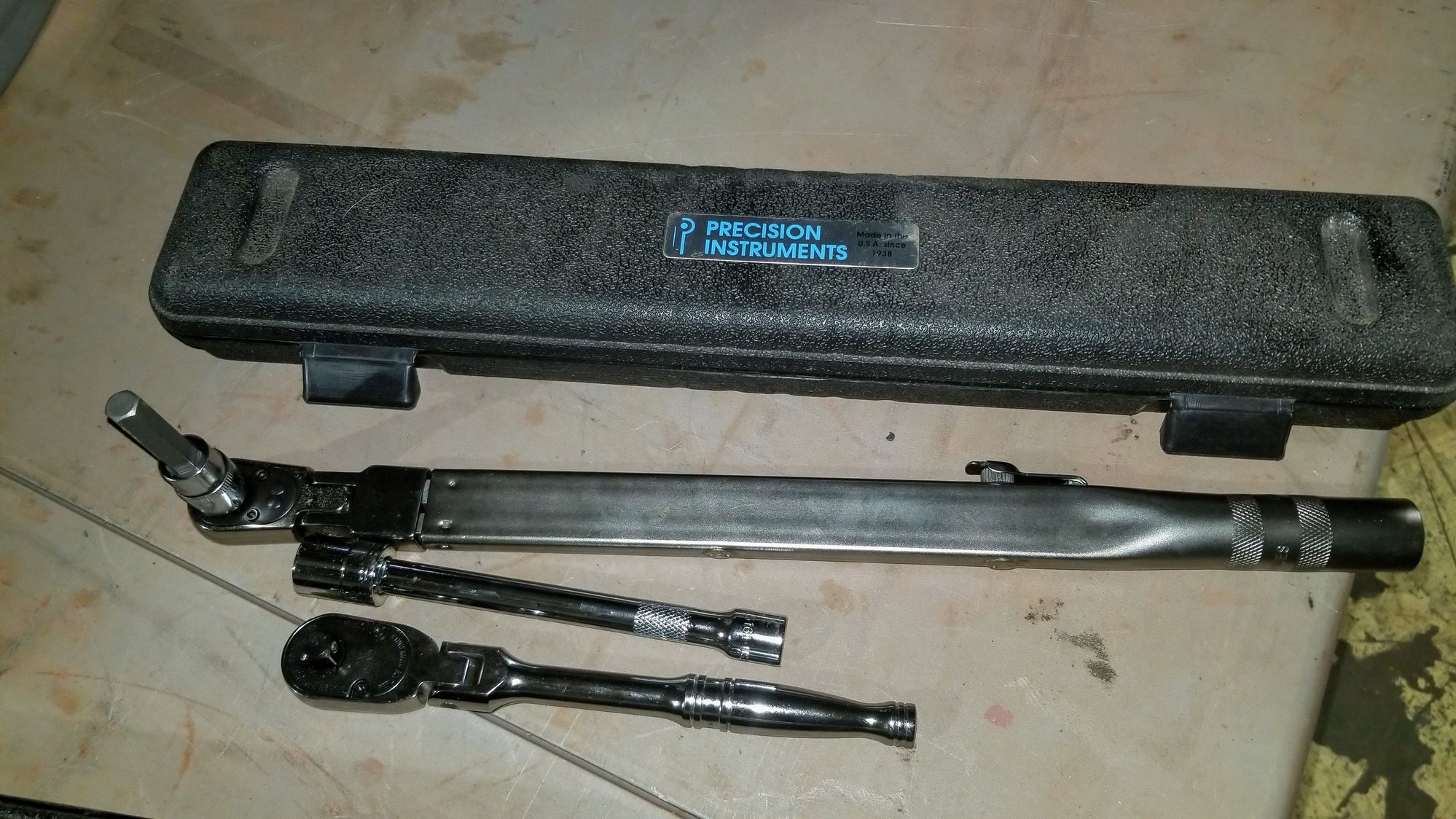

Installed with a slight down angle, pointed to the rear, and torqued to 18ft/lb.
