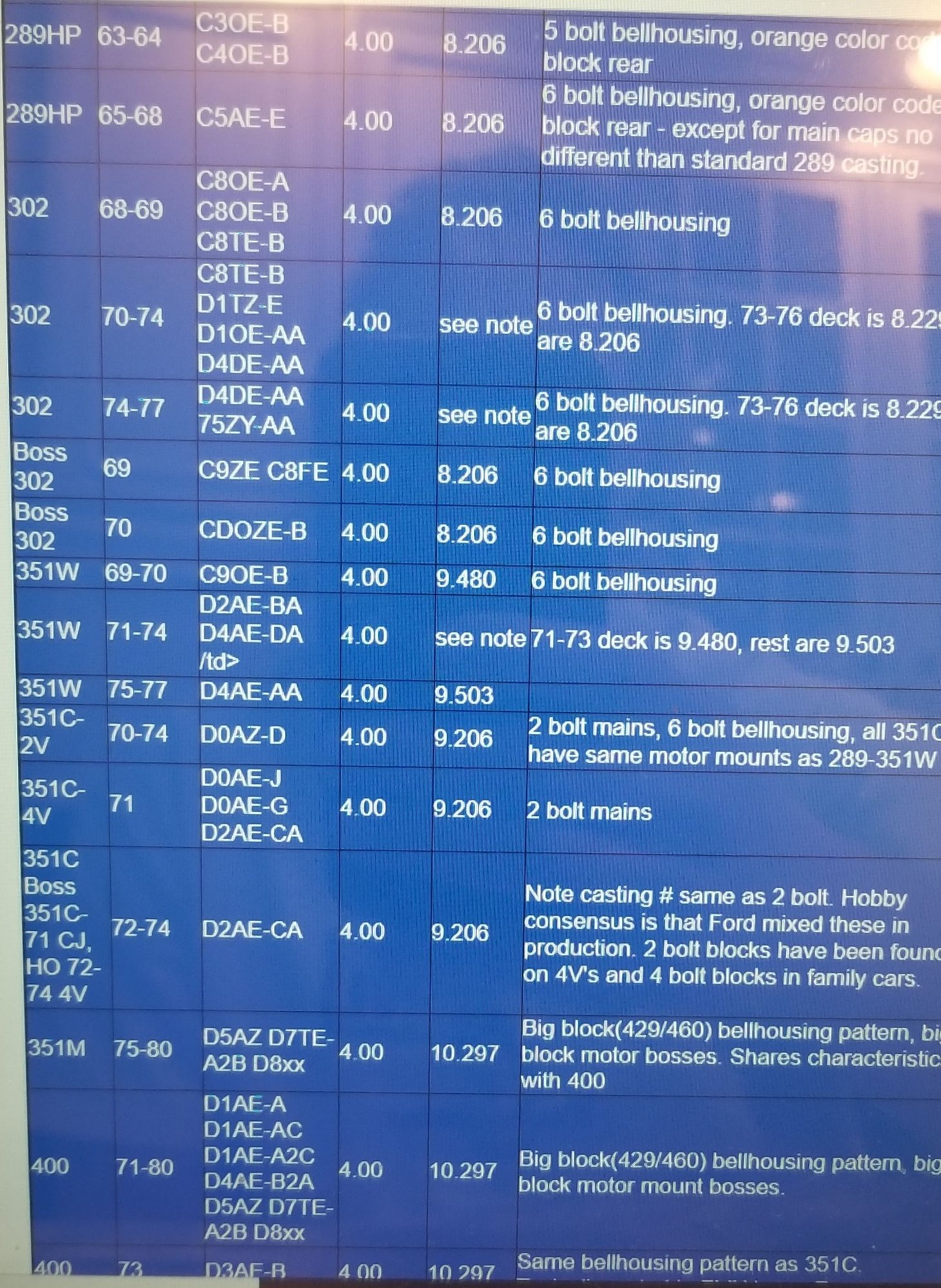

I have been trying to do some google searches but am still confused. My block is a D1AE-6015-A2C. From my homework this is a 400 motor. Is there anyway to verify that easily?

Probably a 400. Unlikely anyone would have rebuilt it as a 351 a some point but stranger things have happened. What state of assembly is it or is it in a vehicle?

Pull a spark plug. Bring that cylinder to TDC. Take a wood dowel put it on the piston and mark it. Move the piston to BDC. Mark the dowel. Measure between the marks,4 inch stroke = 400. 3.5 inch 351M. Easy.

My truck was a 351M and was rebuilt as a 400. The last owner didn't know that, he only knew it was a 400. It took me discovering the difference in clutches to get me to look at the VIN and see that it was originally a 351M. That's probably when it got the Edelbrock Performer intake and Holley 4-barrel. When I took the engine apart I measured the stroke and found 4", then I knew for sure.

Only for sure way to know is to drop the oil pan and look at crank casting. 1K Is 351m and 5m,ma,mab are 400s.

Could have been done by a commercial rebuilder. They were bad about lumping parts in a bin then pulling them out at random to reassemble engines. The OP should look to see if there's a reman tag somewhere on the block. If there's not, it's more'n likely a 400.
