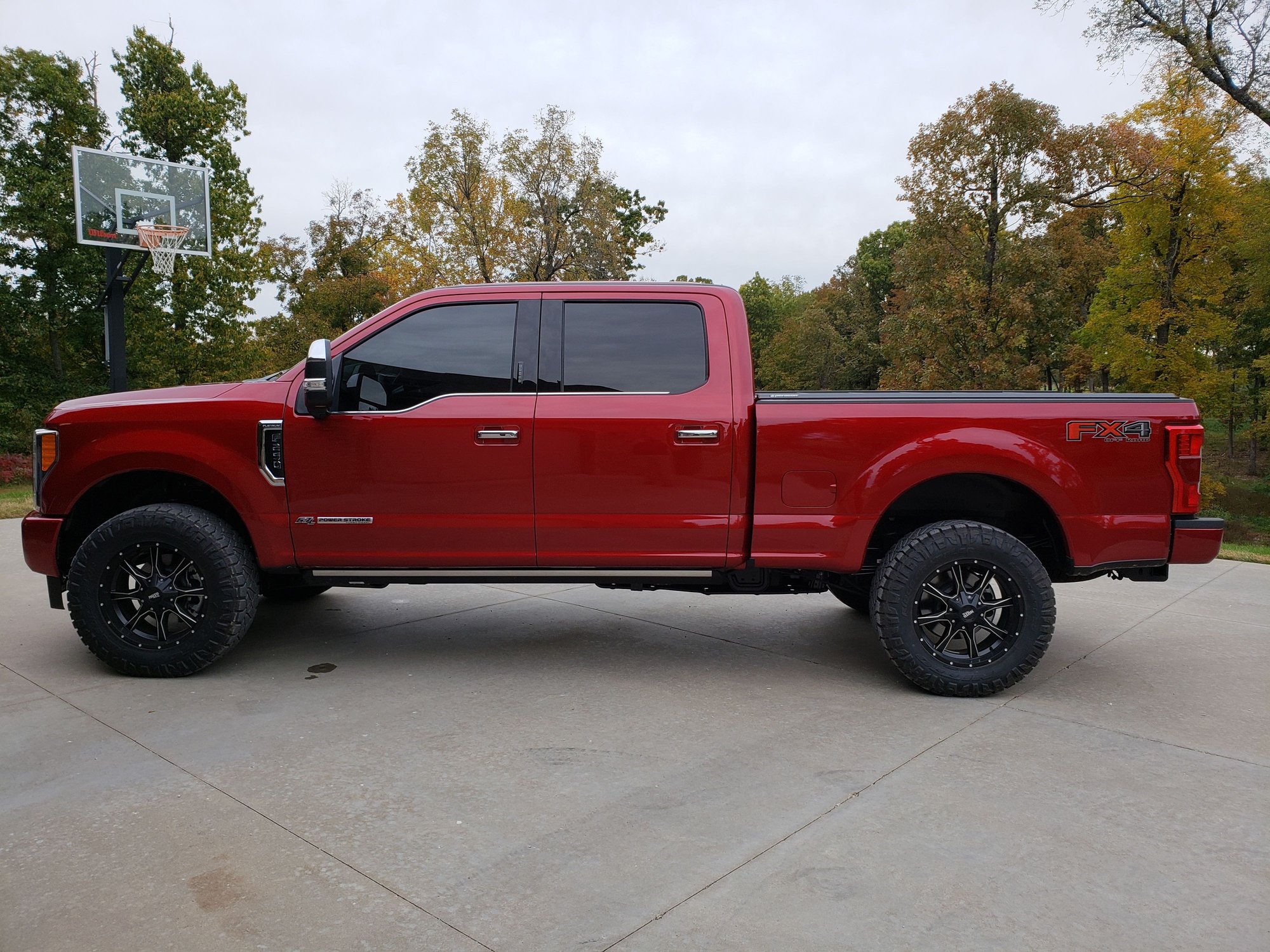

Putting a 2inch Zone on this Friday.
Old Oct 25, 2018 | 11:07 AM
  #45
delorenzomp's Avatar
delorenzomp
Joined: May 2004
Posts: 817
Likes: 18
Gorgeous truck, dryan...Q: are those inner fender liners, 'sprayed-on black', or just shadows, they look great !
