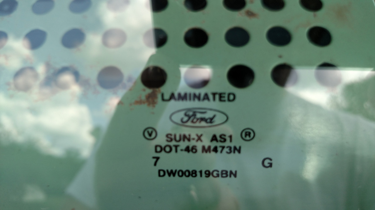

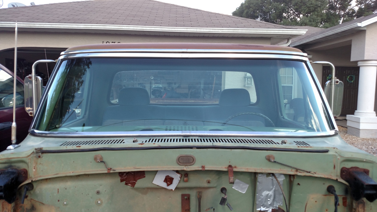

got my new windshield
had a new windshield installed today, they just left. I supplied the gasket, and they used a Ford windshield. my truck has the stainless trim, took two guys 1 1/2 hrs to get it done. worth every bit of the $220 they charged me.

Guarantee you those installers were well experienced given the difficulty level especially with the trim.
