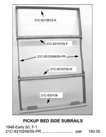

Originally Posted by Blick567
New bedsides dont have this piece and i didn't see it on the catalog.
Looking for help to find the piece that appears to be sitting on top of the front crossmember.
Appears to be a channel running down the inside of the bed.
https://midwestearlyford.com/wp-cont...up-Catalog.pdf See page 93 of this catalog. I think this is what you are talking about?

Those bed frame pieces are just what I need. Didn’t have a Midwest ford catalog. Will now.

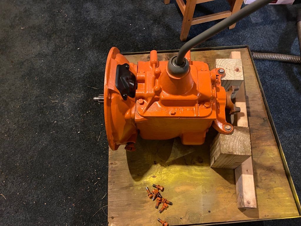

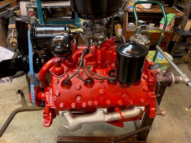

Progress
Not really a help related post more of a progress related. My Dad finished the engine. My son and I sat it in the truck the other day.

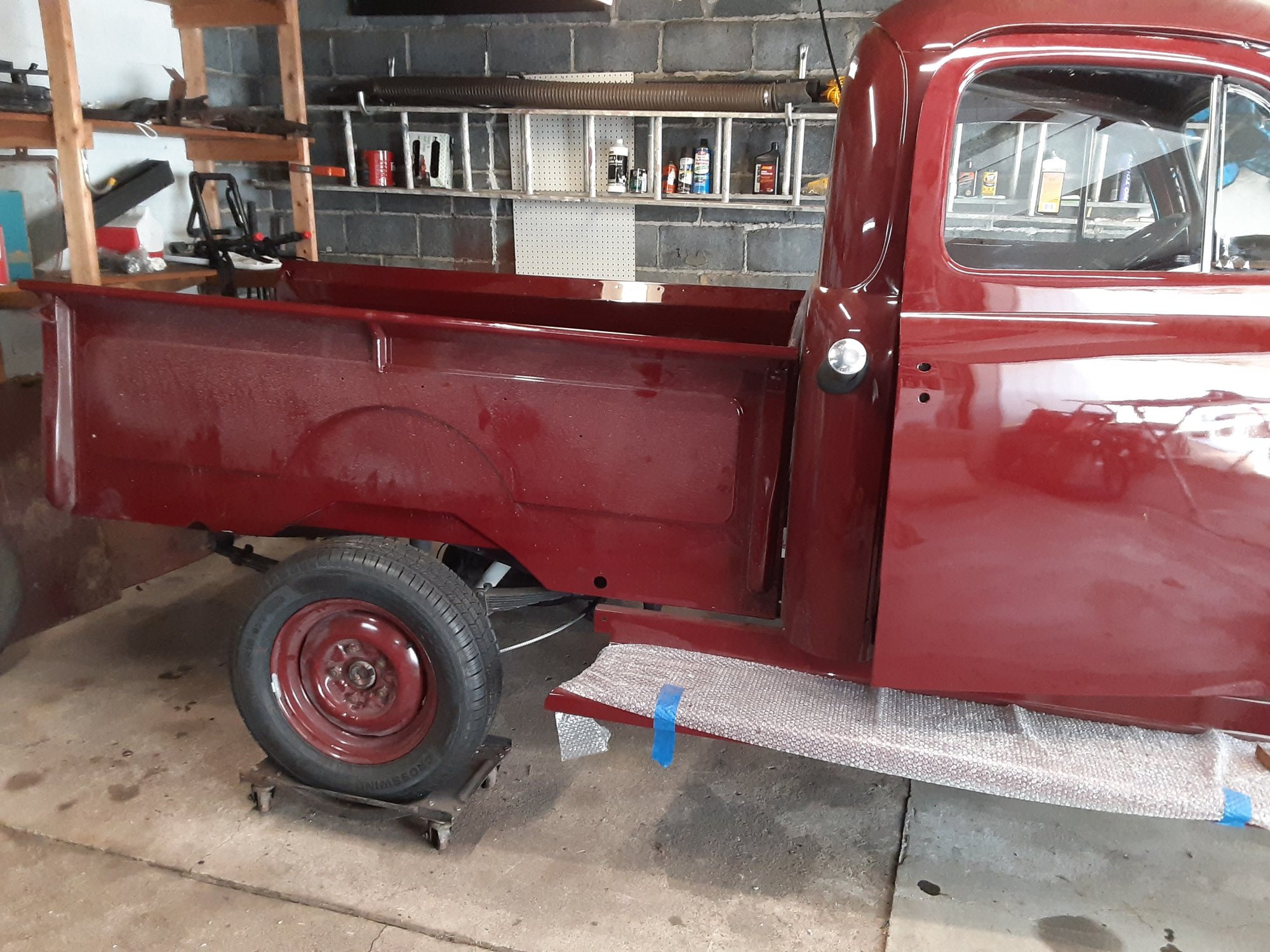

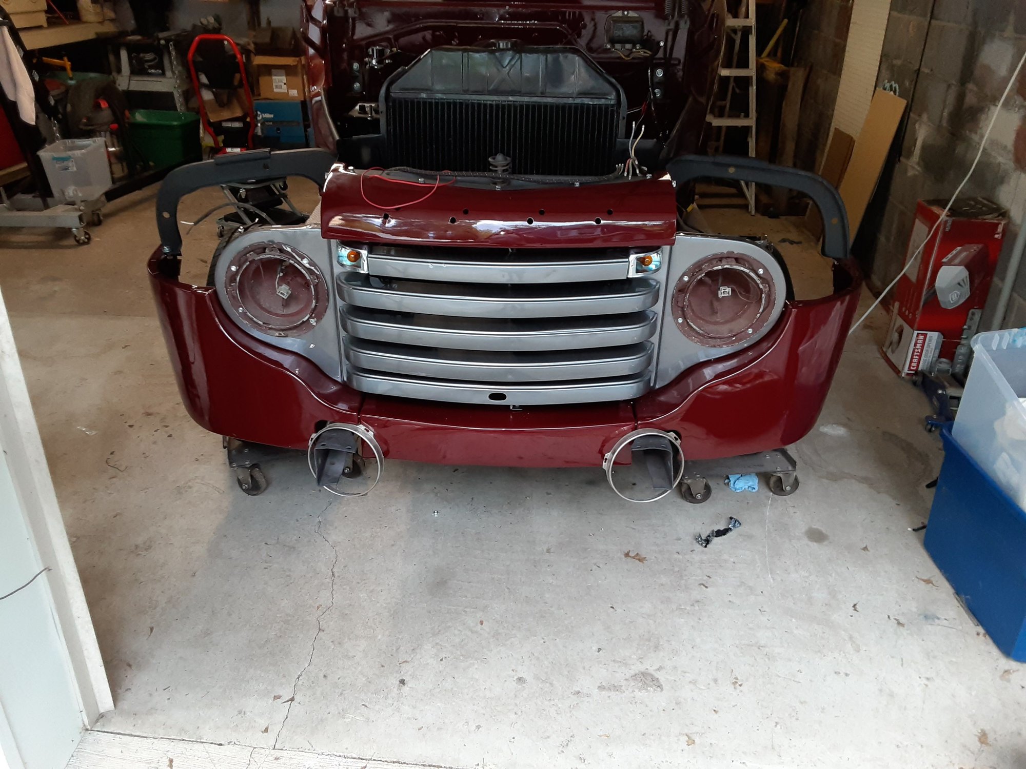

More update pictures.
Set the bed back on today.
Trans rebuilt
My dad and his attention to detail and abilities at 80 amaze me.
Have the front end ready to set next.

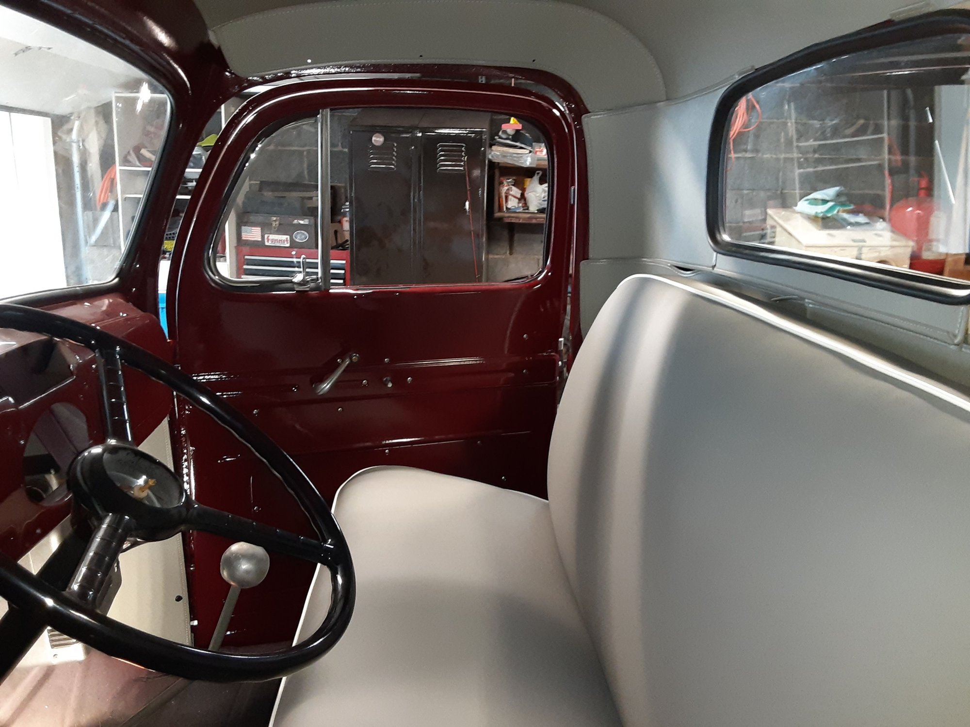

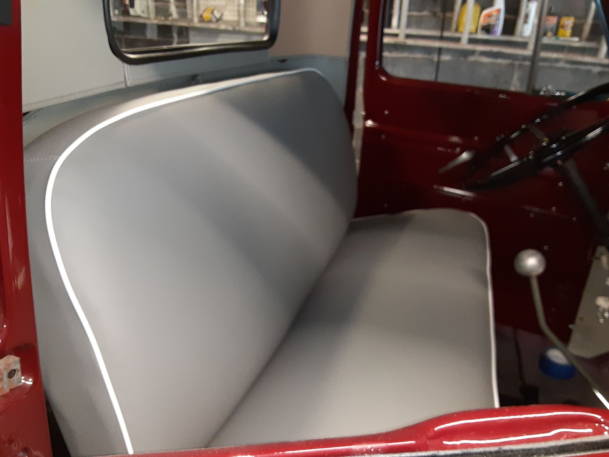

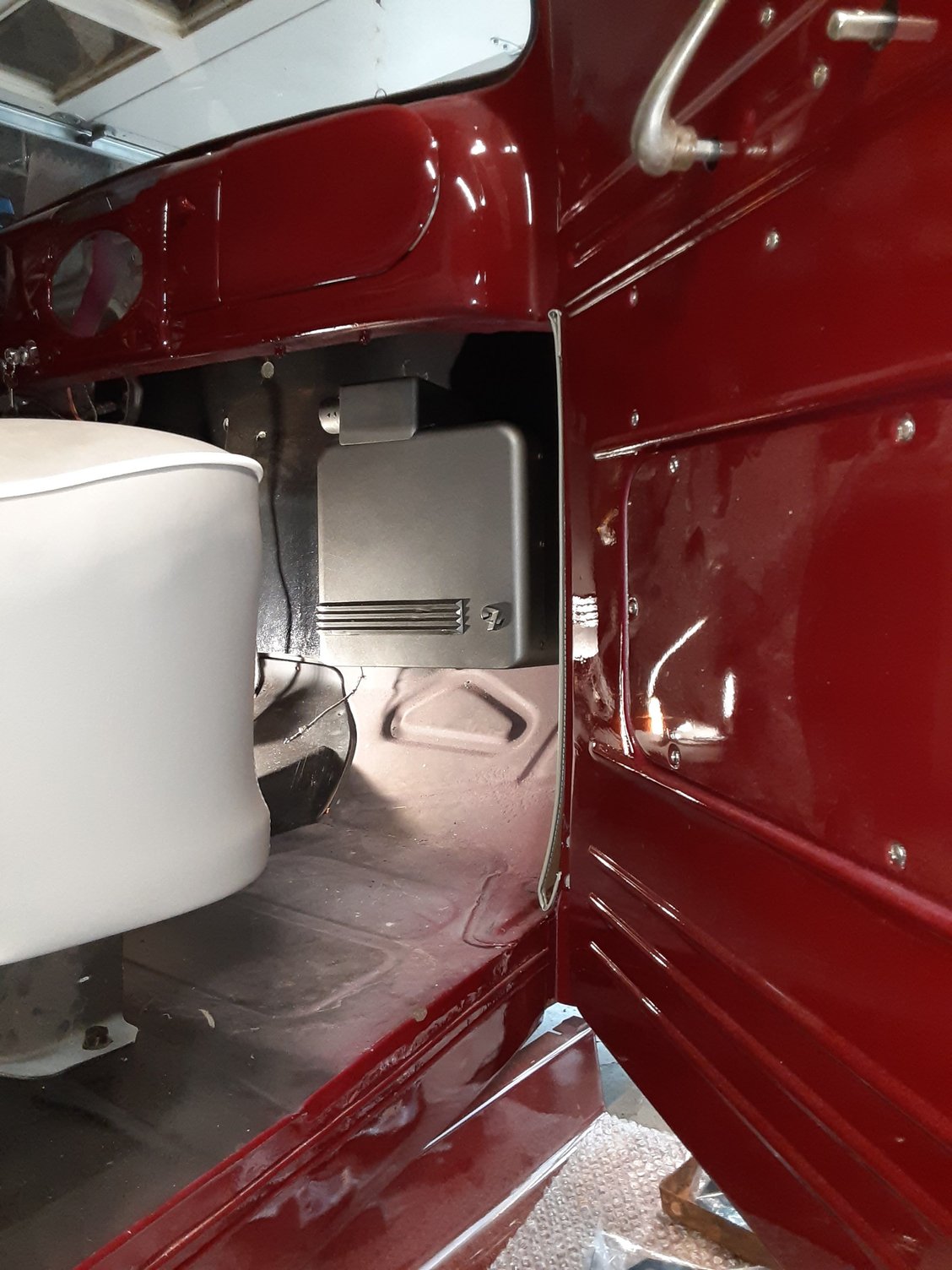

Progress???
I like the seat, didn’t realize how much space it took up inside the cab
All three of my trucks have this heater and all are attached to the firewall in different ways.
Eagle eye the interior trim piece by the window, drivers side. Made backwards, matches the passenger side. I think the material was put on the wrong side or am I supposed to install it upside down
