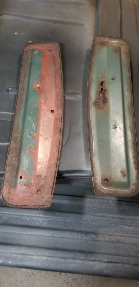

Originally Posted by FortyNiner
Post #28
First pic - still the horn brackets. They fit between the radiator support (the big u-shaped thing) and the inner fenders.
Second/Third pics - not sure on these yet.
Fourth pic - rear fender braces
I believe the 2nd pic piece goes on top of the transmission between the trans and the cover to support the seal around the shift tower on the floor shift trans.
Yup, that's it.

Figured the other piece was the other side horn bracket. Just want to be sure.
The last has to be rear fender braces. I believe.
