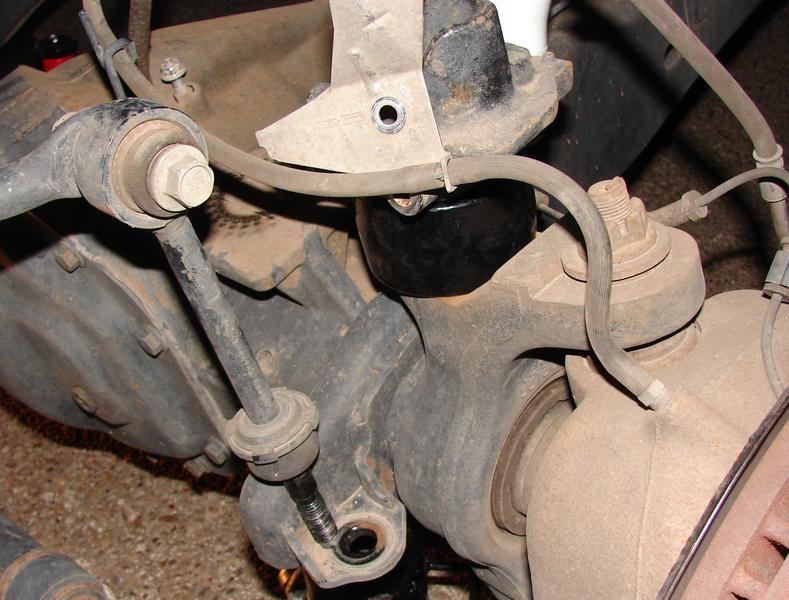

Any idea what size bolt hold these spring perches on to the axle ?
