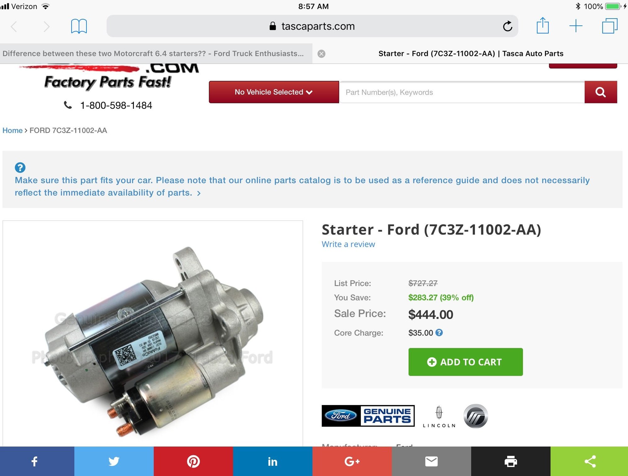

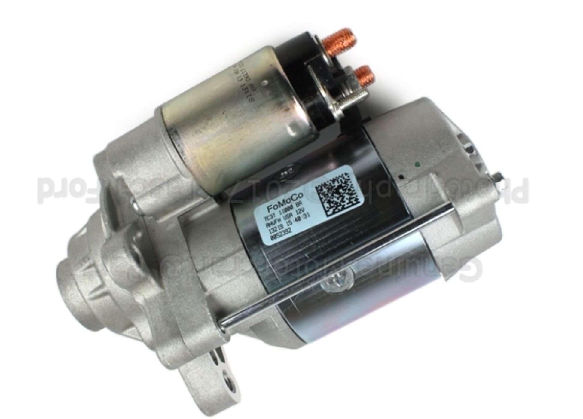

It very well may be the OE part. I came from a company that made parts for the auto manufacturers and sold also to the aftermarket. So we qualified as an “OE”, and parts would be marketed in the aftermarket as coming from OE, or OE quality. They were completely different parts. And there’s the term OE specs. Ford never gives out the specs to anyone, and as a supplier to Ford your not allowed to disseminate the specs or sell the product that you contracted to make for Ford. So I get speptical about descriptions.
OE assembly line Ford parts carry numbers such as 7C3Z-11002-AA, and that’s how I’ve ordered them for 30 years. The Motorcraft line-up, which is Ford’s aftermarket line has a different set of labeling. The SA965 starter may very well be the exact same and it’s RockAuto description may be screwing with my head. Ford appears to be merging the two lines lately.
When I put in the 7C3Z-11002-AA number into one of the Ford dealer search engines it comes up with this. So based on pricing, and despite the core charge, very well can be the same. Note the label on the starter. It’s what I looked for when I bought the eBay starter on a 60k mile truck for around $75.

Thank you, the cheaper one of the two I bought does not have that label. I will stop by the Ford parts counter after work today, and if the more expensive one is not made in China then the one I bought yesterday will be going back to the local diesel shop I purchased it from. I just figured there has to be a difference since they offer both and there is over a $100 price difference.

Update: Had it confirmed by dealer... The cheaper Motorcraft starter that runs ~$220 is a cheaper made in China alternative to the OEM starter that runs $350+.
Place I bought it from insisted that the cheaper one was OEM when I returned the China one just because it was Motorcraft branded. Then they got upset when I pointed out the two different Motorcraft part numbers and the price difference.
