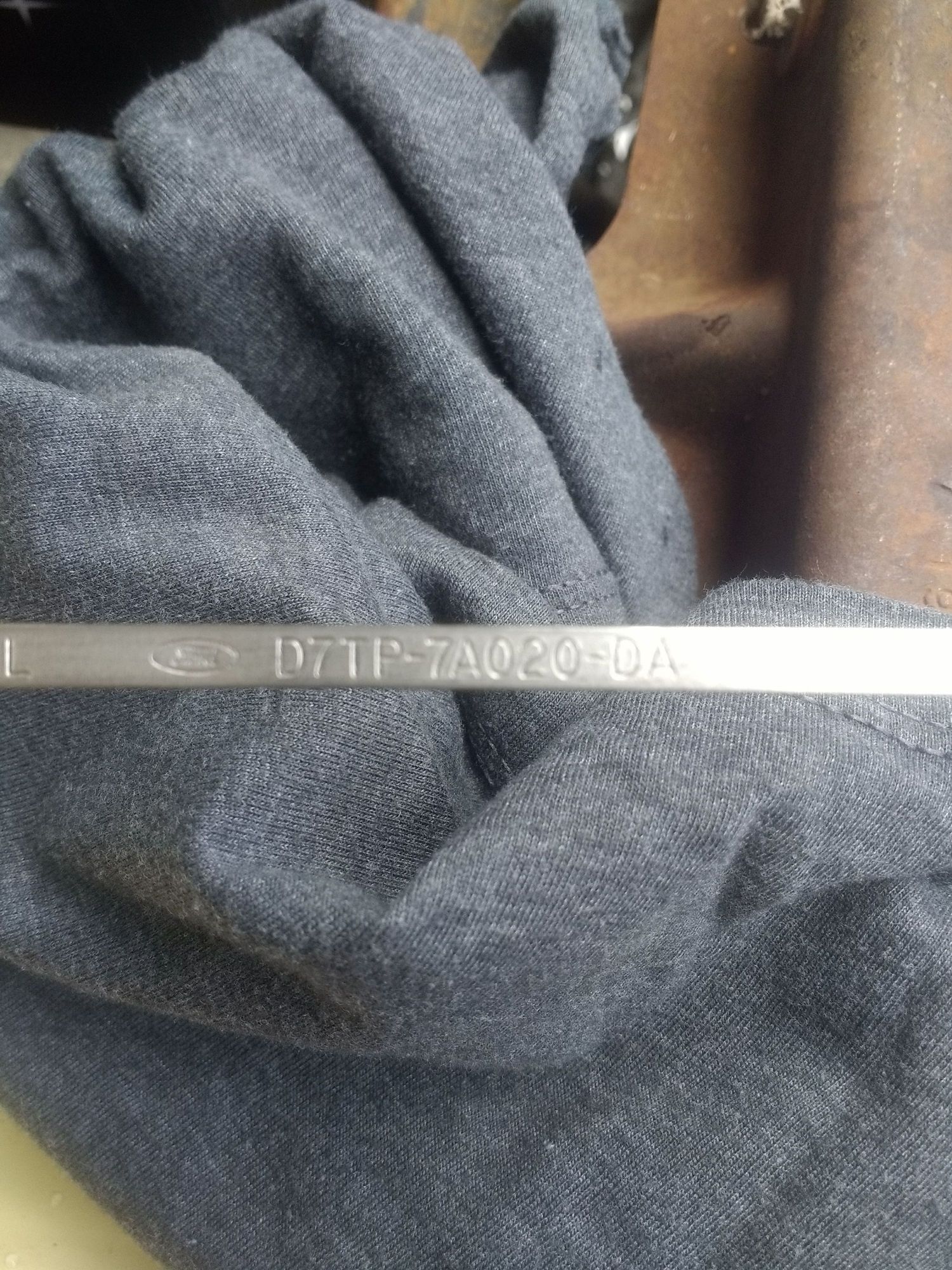

I did NOT check it hot before draining it - mea culpa, I wish I had. I also did not realize it was pints, not quarts. That was stupid of me. Attached are some pictures that show details. FYI that the fluid on the stick is a cold reading, which I know is irrelevant. I'll try to take one hot later today.
tranny pan side-view
cold fluid level
dipstick part detail

Good pic of the number. Thanks.
It's at least in the correct range, being a '77 designed part. I don't know the exact number sequence that says it's for a C6 in a particular application, but I'm sure several people here can verify if it's correct from that number.
Clean fluid at this point!
