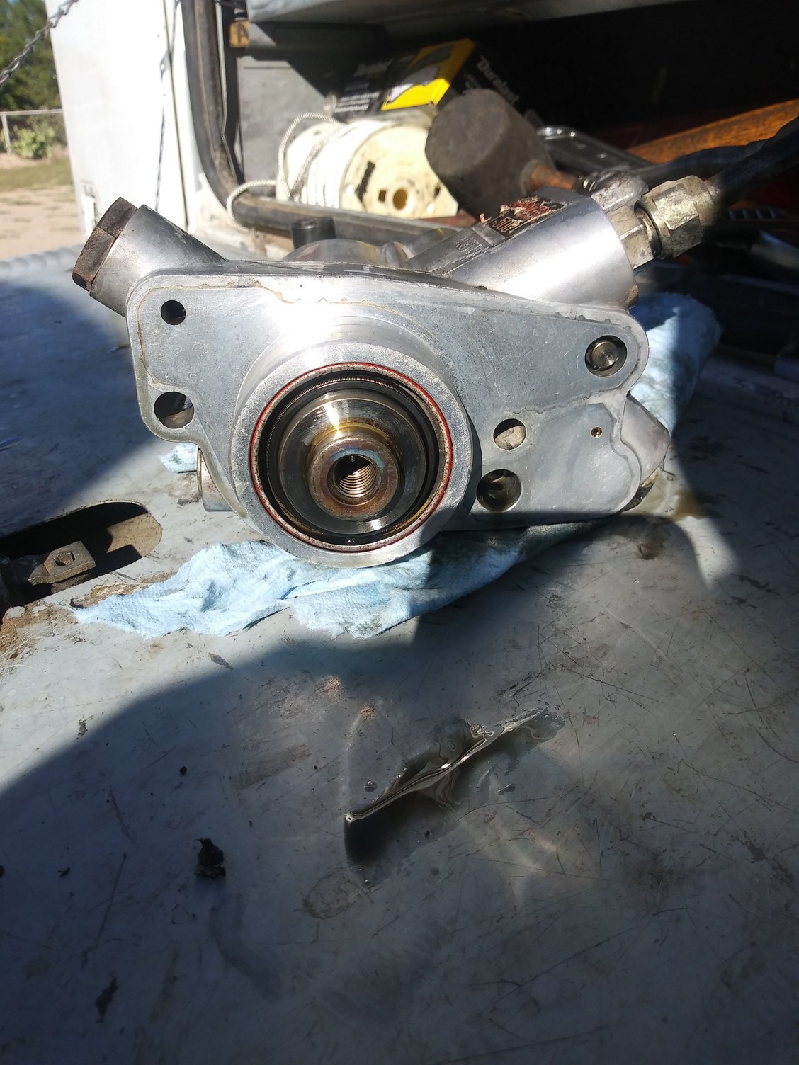

Ok just a little update to this thread.
Took the T500 out and installed one of the working HPOP's, the one with the OBS fittings looked good (clean) the other HPOP had a stripped fitting so no good and also looked kinfmd of dirty from the "non serviceable" plug. Started to pour ill update as soon as this storm calms down, ill I need it to fill the resevoir with oil and I should be good to go. Ill update in the AM to see if it drained or not, wish me luck...

Went to test drive the truck, and holy **** I forgot how ****ty these stock 15° pumps are, after working the air out almost 75 miles of driving and doing WOT runs in my hot tune, first thoughts are higher EGT's by like 75° in flat ground, smokey at @ WOT in my hot tune (with the t500 never did it) and has a bit of a delay on acceleration (never did this with the t500) and the whole reason I send my original HPOP to Joey almost 4 years ago the dam CEL... Ahhhhggg I hate it lol... Im running out of oil. Time to send out the other pump to......
Need help here, recently theres been a couple of threads of guys complaining of how they have had bad units from Joey and how difficult it is to get in touch directly with him, now im second guessing if I should go with another vendor
Thoughts?

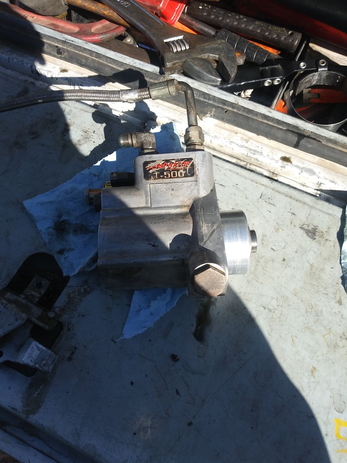

Heres the t-500 taken out just cause you monkeys like pictures lol... And yes you see all that sun and it started to pour not even five minutes later, freaking weird climate.

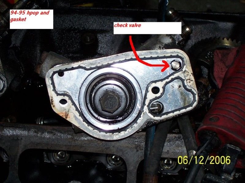

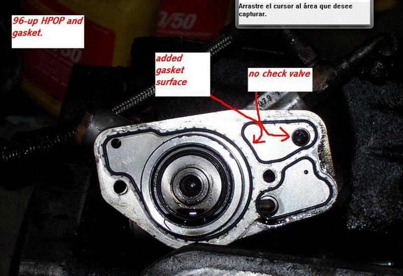

Originally Posted by Action4478
There are 2 check valves IIRC in the oil cooler
yup, one you can see with the filter removed and the is on the back side of the filter housing

Which gasket did you use
