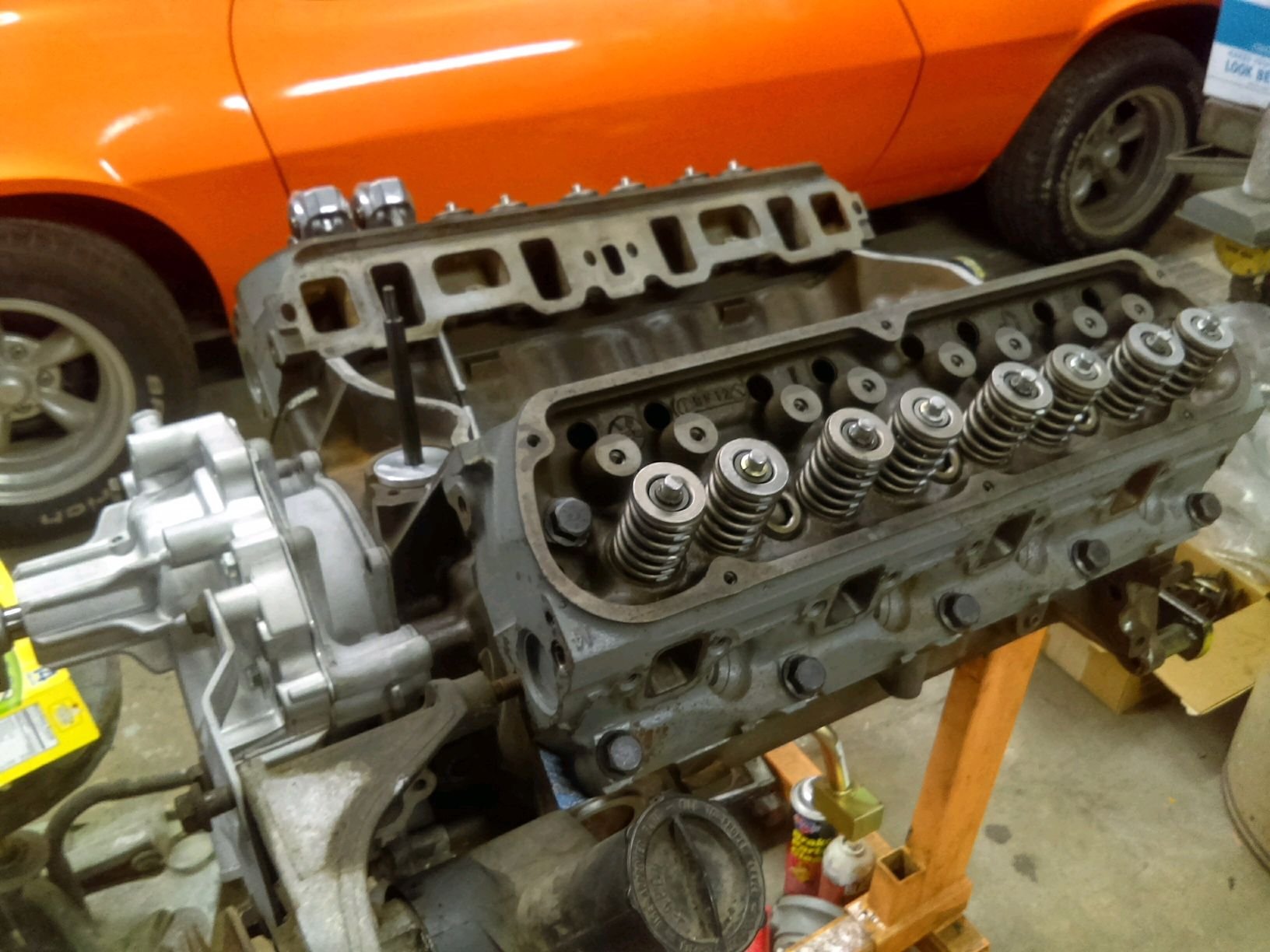

My 63 has a 351W (started life with an inline 6). Anyway nice as the engine is it has low oil pressure when it is warmed up. First thought was to put a new oil pump in but then it maybe main bearings or........... Talking to a friend we decided to find a doner engine to rework. Well in out search we came across an already rebuilt block 30 over with new crank bearing etc 0 miles. Next came a couple of flowed Mustang GT heads with new valves and guides etc basically 0 hours. Chose a "mild" upgrade in cam. Roller rockers, high flow oil pump added. Engine will be ready to drop in taking my nice rocker covers, inlet manifold, Edlebrock, and Mallory ignition etc. When the old engine comes out we have power steering and brakes to install before the new engine gets installed. Cant wait.

Heads are together nearly ready for paint.

Looking good. That should be a strong runner. But I would be cautious about running that HV oil pump if that engine has standard bearing clearances that tends to put a tremendous load on the distributor gear and cam gear. Ford Racing lists that in the top 5 reasons for distributor gear failure.
That's good to know thanks
