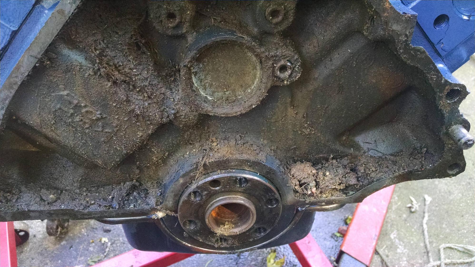

Octoberish last year I decided to finally put the 71 up as the 302 was showing it's wear. It had little oil pressure, tons of valvetrain noise, and was burning coolant. I decided on rebuilding the engine in the spring. Well, I weighed my options for rebuilders in my area, and settled on a friend who was starting a speed shop as he estimated about the same time that all the other shops did, and I wanted to help out his growing business. I knew he was plenty skilled to rebuild a stock 302. My chief complaints were a noisy rod, low oil pressure, and blown headgaskset.
Anyways, after countless delays, ignored phone calls, voicemails, and texts, he finally gets the engine finished after 20 weeks. This is what I got back:
He claimed this engine was hot tanked, but all this dirt on the back seems to say otherwise. We noticed the old, rusty flexplate bolts didn't have any tool marks on them, so I don't believe he even touched the rotating assembly.

I don't believe your friend is actually a friend. Good to hear the crate engine is doing well.

I'm happy to hear you like to promote small business' as I do. But it looks like your "acquaintance" gave you back a different JY engine. Either there was something special about your old engine that he wanted or he screwed something up rebuilding it. And didn't have the funds to recover. Glad to hear the crate engine worked out.
