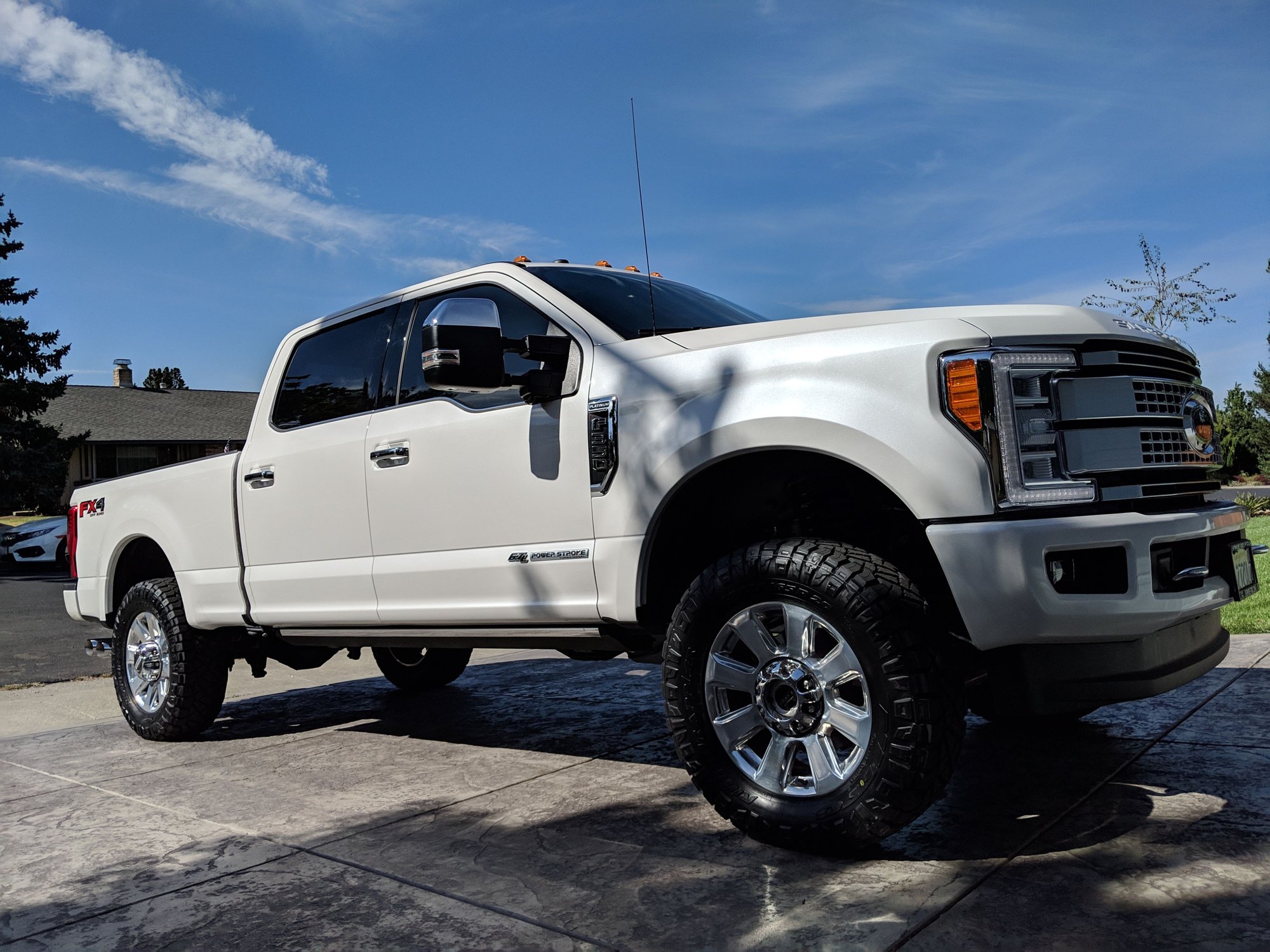

Installed the Carli 2.5" leveling kit with Fox 2.0s yesterday on my 2018 F350 and I am loving the ride! I skipped their trackbar and went with the Redilift bracket (corrects geometry as well as re centers the axle).
For tires, I went with Nitto Ridge Grapplers (295/65/R20).
You won't go wrong with Carli!
