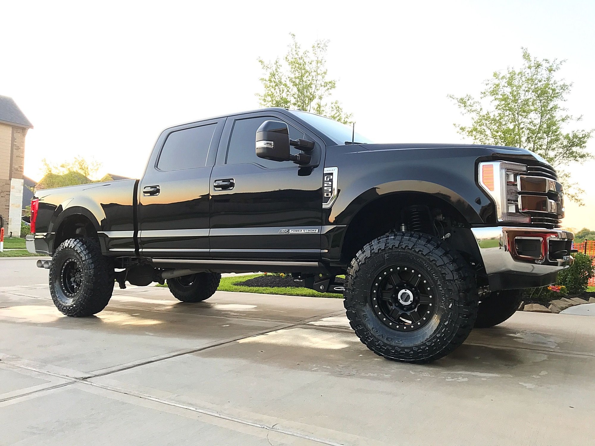

brenta can you attach some some pics of your rig? I'd like to see what it looks like with the4.5 lift and 37's. you have any rubbing issues??

Here's a picture of my truck comparing the before and after from when it was stock, and then after I installed the 4.5" lift and temporarily ran 37x13.50r20 Toyo MT's on the stock wheels.
And a second picture with the new 37x13.50r17 Toyo MT's on 17" forged beadlock wheels from Innov8 Racing.
37x13.50's on stock wheels rubs (37x12.50's wont), and 37x13.50' on the new aftermarket wheels (9" wide w/ 5" backspacing) clear perfectly with no rubbing whatsoever. If you have more questions, I have a new thread started specific to my upgrades, or you can PM me. Don't wanna thread-jack, lol.
