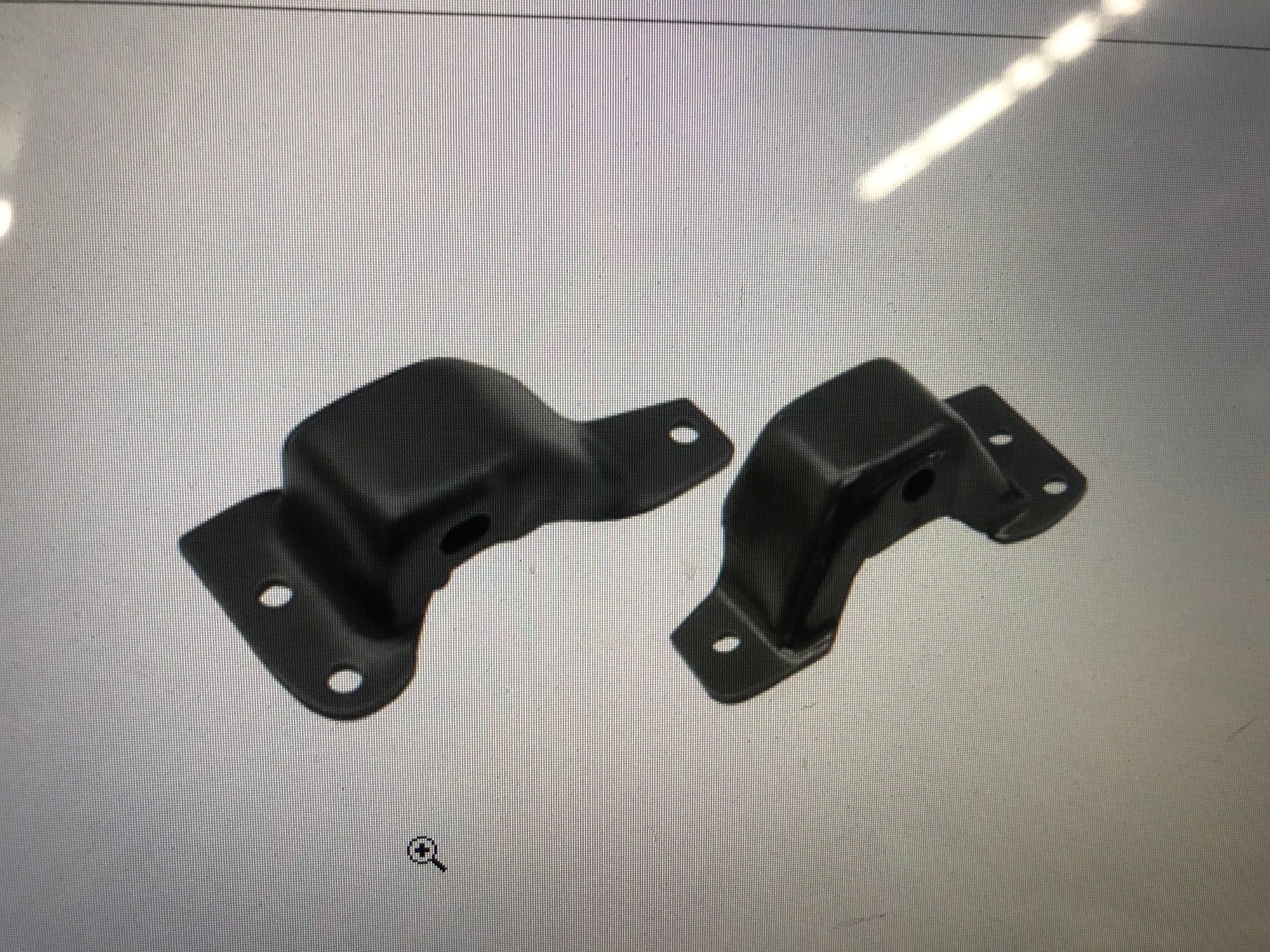

The towers in the link on # 12 are not the right ones. They are for a 4WD. The mounts alans77crew has are correct, if they are from an F-series, but you also need the frame mounts(perches) that go with them.

What exactly is the between the 2-wheel and 4- wheel perches DB429SCJ?

this is 2wd and the 2nd are 4wd

Alright then the first ones are 4wd the second are 2wd

2wd sits on the cross member 4wd mounts on the frame

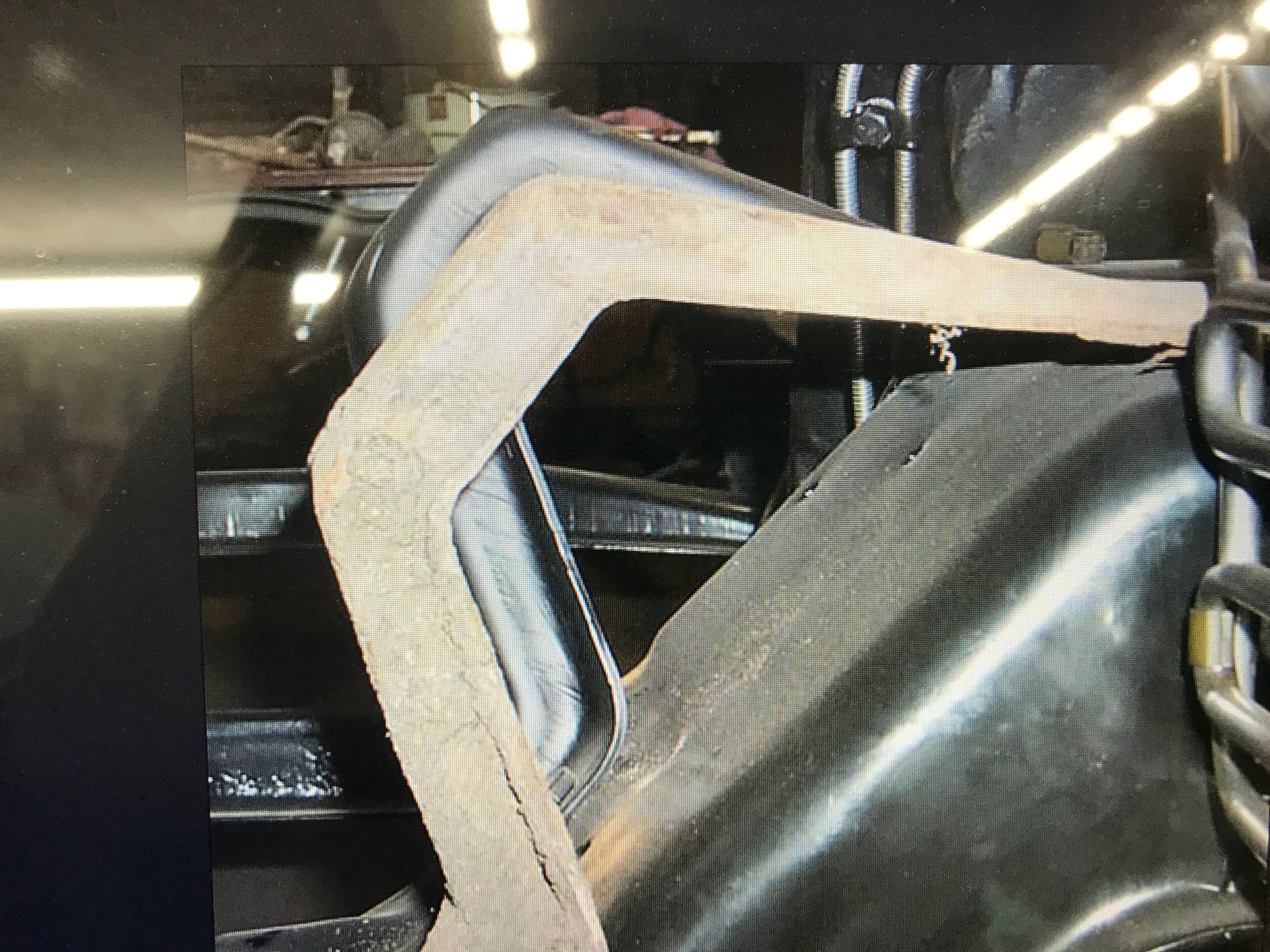

From: Idaho
Here is a better picture
