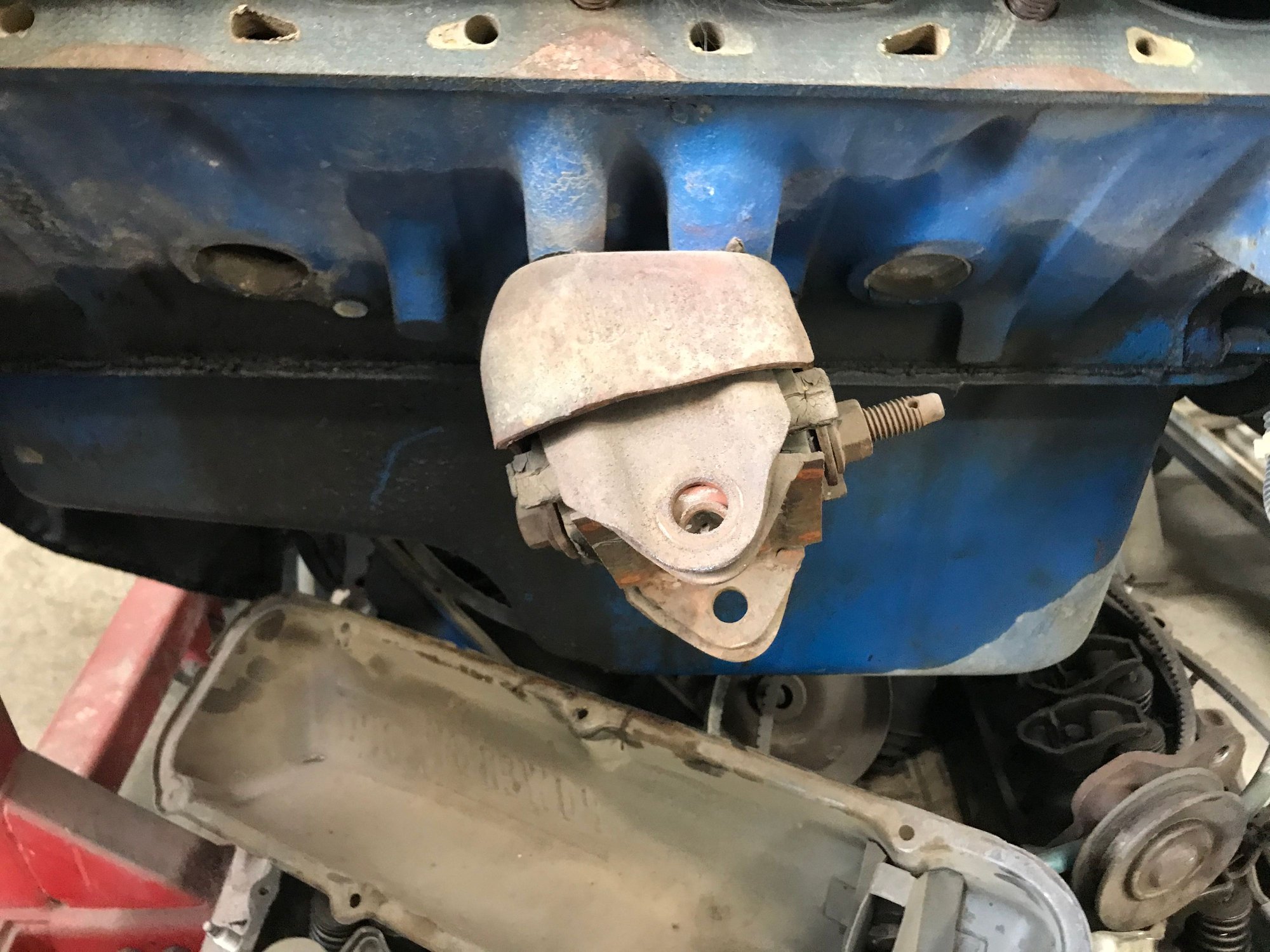

I have a set still on a 460 in my shop! will these do?

sorry thought you were looking for mounts and cups
