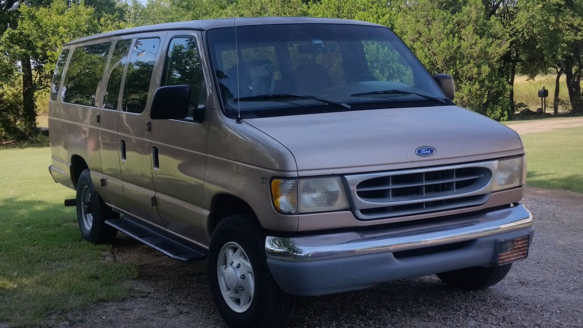

Hello all, I am new to the forum. Also new to my 97 E350 van. I recently bought it from the UPS folks and it shows 118,000 miles. However, the odometer wasn't working. A CAR FAX check shows the miles to be pretty close, so I don't think the odometer gear has been broken very long. The van has the V10 Triton engine also. Anyway, I ordered a replacement odometer gear and followed a youtube video on how to replace it and I got it in without any problem. Before the repair, all the gauges worked with the exception of the odometer. After I replaced the odometer gear, now only the speedometer and odometer work. None of the other gauges work. All the idiot lights work, turn signals, etc. Just the gauges are out. I thought maybe I shorted something out when I put the three plugs into the back of the instrument cluster when I put it back together. I checked all the fuses. Everything looks fine.
After doing a bit of research on the internet I thought maybe I somehow shorted out the whole cluster. I ordered a rebuilt one. I got it in the mail yesterday. Installed it today. I have the same problem I had before, so something is messed up somewhere.
Anyone have a possible solution? Anyone had this issue before?
