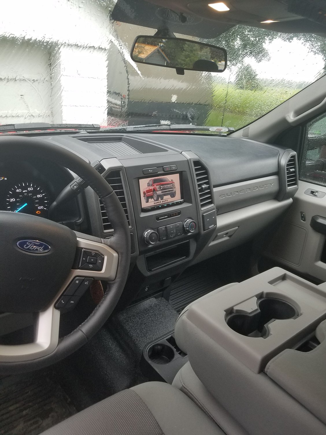

If you don't mind can you go into a little bit more detail about adding the steering wheel. I wanted to do it but a few people said it couldn't be done including the 4d guys.
It was said that there would be no harness or interface parts in the truck for the wheel. I have an 18 250 STX with no sync. I also have a cargo camera and nobi=ody could promise me that I could retain that.

the cargo camera im not sure how it connects to the factory radio (if its a seperate video imput or shares the same as the rear cam and is switched before the radio) the steering wheel is plug and play it comes with the harness all you have to do is plug in and turn on the audio buttons in forscan, the only button on the right that doesnt work is the sync voice command ( because of no sync module) volume, media, phone on and off all work

Thanks for your reply. I’m pretty sure the cameras both go to one place and then to the radio, I’m thinking I only have one camera plug.
Good to hear about the wheel, I think I will order one.
