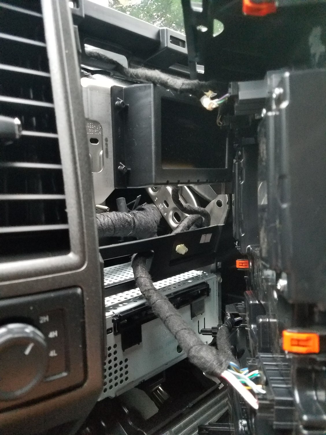

Old Sep 9, 2018 | 07:04 PM
2018f250stx's Avatar
2018f250stx
Joined: Aug 2018
Posts: 119
From: Norwalk ohio
Old 4.3
Old Sep 9, 2018 | 07:07 PM
2018f250stx
Joined: Aug 2018
Posts: 119
From: Norwalk ohio
New testing before clean up
Old Sep 9, 2018 | 07:11 PM
2018f250stx
Joined: Aug 2018
Posts: 119
From: Norwalk ohio
Before
Old Sep 9, 2018 | 07:13 PM
2018f250stx
Joined: Aug 2018
Posts: 119
From: Norwalk ohio
After
