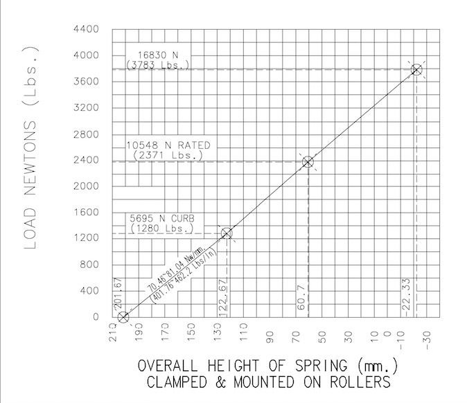

450 lbs/in is the spring will compress 1 inch when you apply 450 pounds to it. 2" would require 900 pounds. these leaf springs are not progressive rate.
this is exactly how the entire engineering and suspension community describes springs not me making stuff up.
Here is the actual graph from Fords Blue prints on the Excursions rear leaf springs that show that the rate is indeed linear for the entire travel, this graph is not a calculation but actual test results in a spring test jig.

Well, pirate, if that is the case, then they are putting a lot more design work into them than I gave them credit for. I stand corrected about truck springs rates.
Although all the springs I made as a gunsmith never had linear rates no matter what tapers I put on them.
Edit: Ahh, yes. I should have thought about that. spring pack vs single springs. Pack is progressive to keep rate even. I would bet the fronts with only 2 leaves are not as linear.
