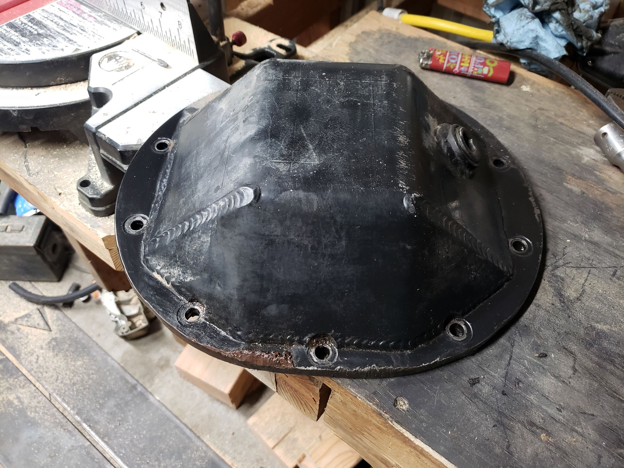

I worry more about dragging the rear cover over rocks in offroad application.
Here's the rear cover on my rear jeep axle. This cover hasn't seen many trails miles as jeeps always in my shop.
Cover has a 1/2" ring the rest is 3/8" beeeeeeef
The thin stamped covers tend bend and pull off the face causeing leaks
Yes I had a impact with a build skylark. It drive under the rear of my cummins out of the blue.
