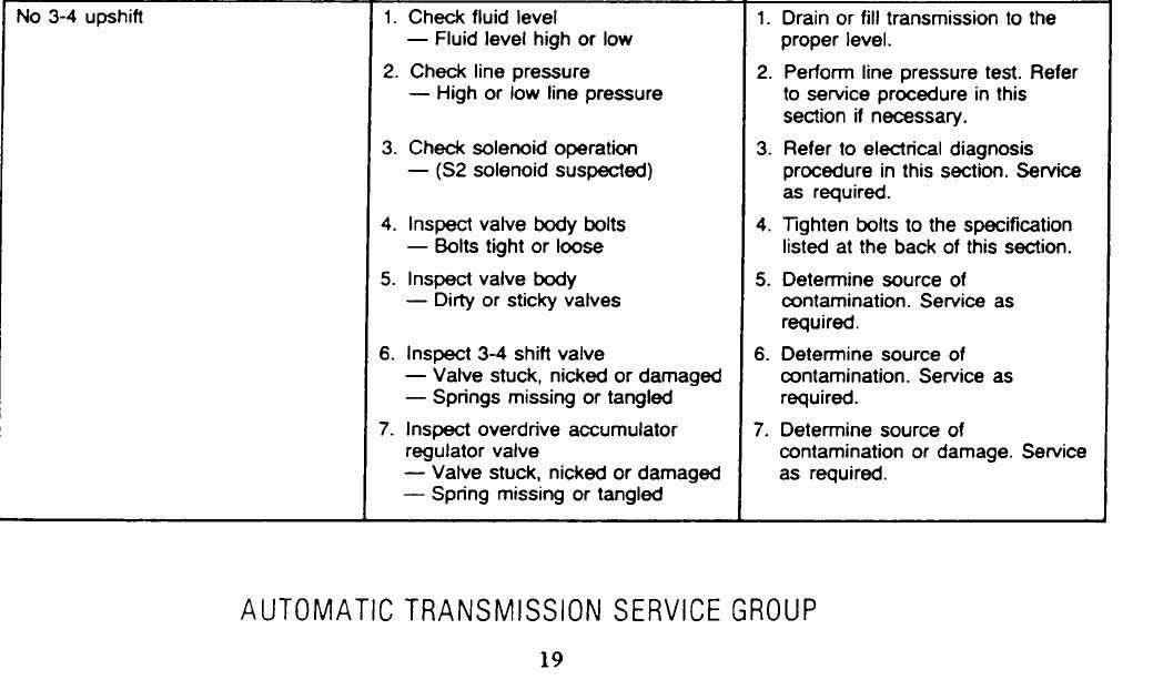

Well first off,this part was wrong for any IDI truck:
D36420B/31A-110A Solenoid Pack Assembly 95- up
You need the 89-94 pack.I can't explain why it ever worked though,only that it shouldn't never have lol.You can use a 95-97 E4OD and even a 4R100 trans if you want but the 89-94 pack is one of the older parts that must be used.

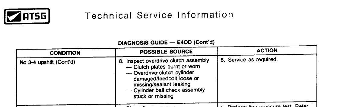

Next,here is the list of reasons why you might not get a shift into OD:

I wouldn't abandon the trans.Look at the list of possibilities.You could simply have a sticking valve and or broken/tangled springs in the valve body causing the issue.No need to drop the trans to inspect this.I would take it to a trans shop if your not up to it and just get it fixed since it's a nice reman.
