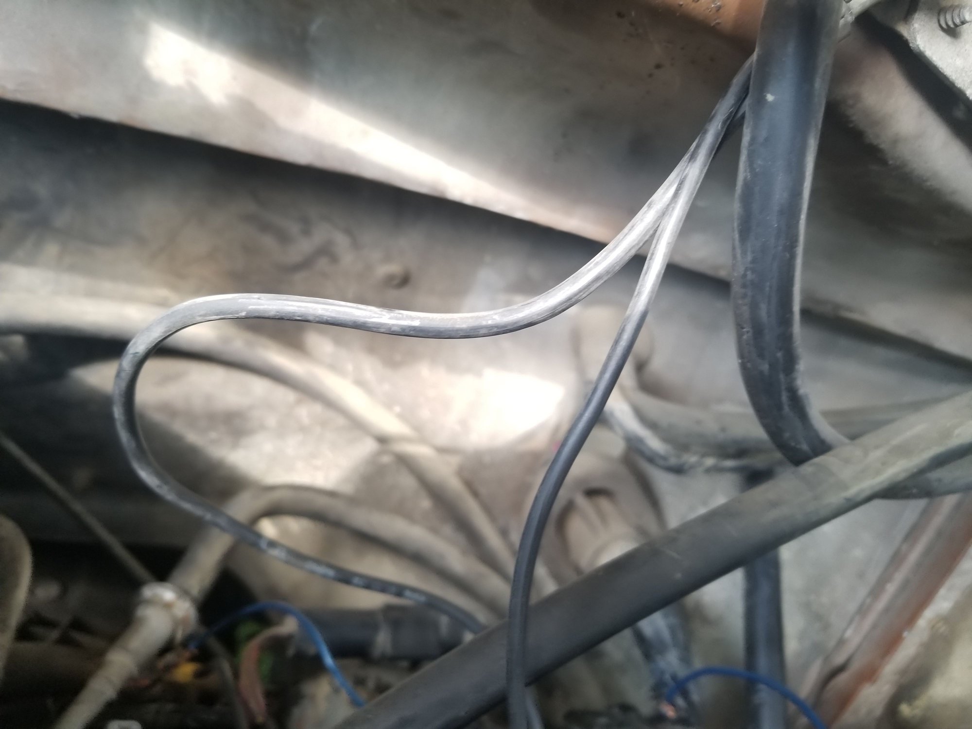

I forgot lol 86 ford f150 302 and i think its a ground.
it comes off the block to the wiper motor ground and runs into a connector that use 2 split into wires until i touch it lol

The start of the wire

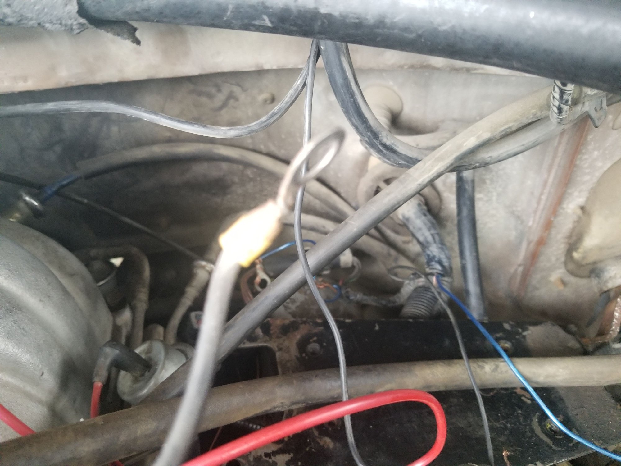

Here where it spilts off into 2 wires until the other one broke 2 second wire was bare and shorted out

Shorted out?
If it is a ground it should not short out but then again if it is a ground for a high amp device when that wire was put to ground it could spark and look like it shorted out.
You are checking it by ohms what do you get for volts with everything turned off and then test for volts like when you saw the spark or short.
Not seeing that wire in person it is hard to say what it is or goes to.
