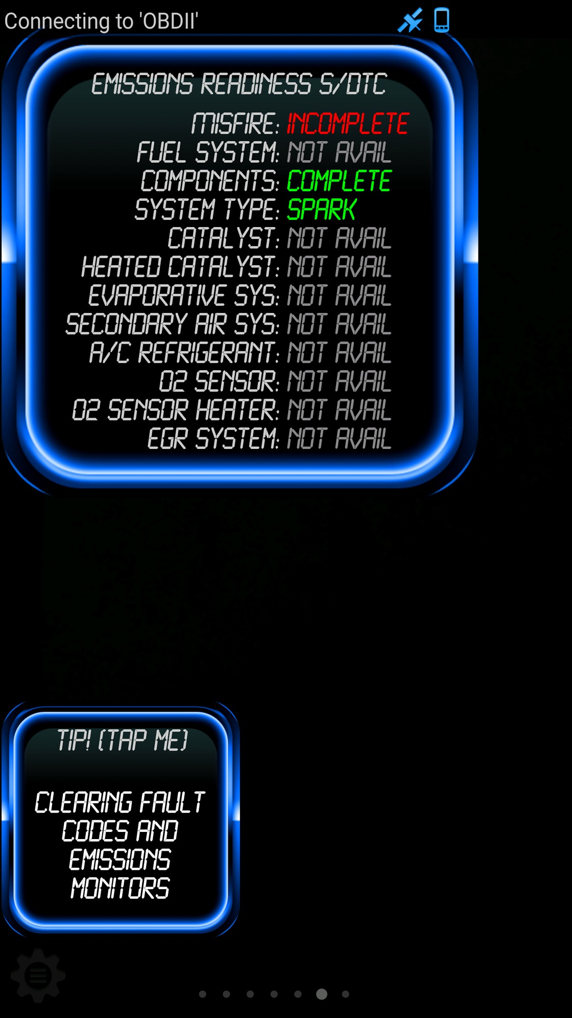

Well it is original as far as I know. It has its cat and egr system in place. Here is a screen shot of my readiness monitors from my Torque app. I just did a repair and had to clear a DTC, so one show it needs to complete.

Get the monitors to complete and as far as I know you should be good.

As was able to get the misfire to complete and took it in and passed my smog.

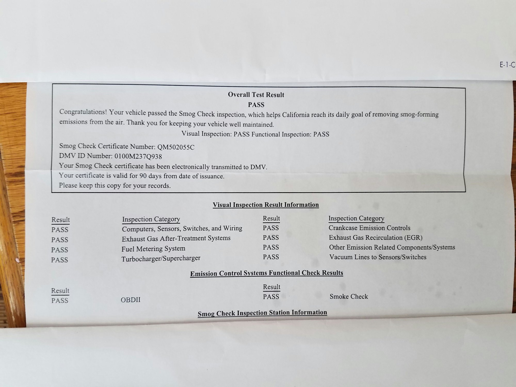

Well here's the update, it passed. They did a visual to make sure all the emissions equipment was in place, checked the computer for codes, and a smoke test.
