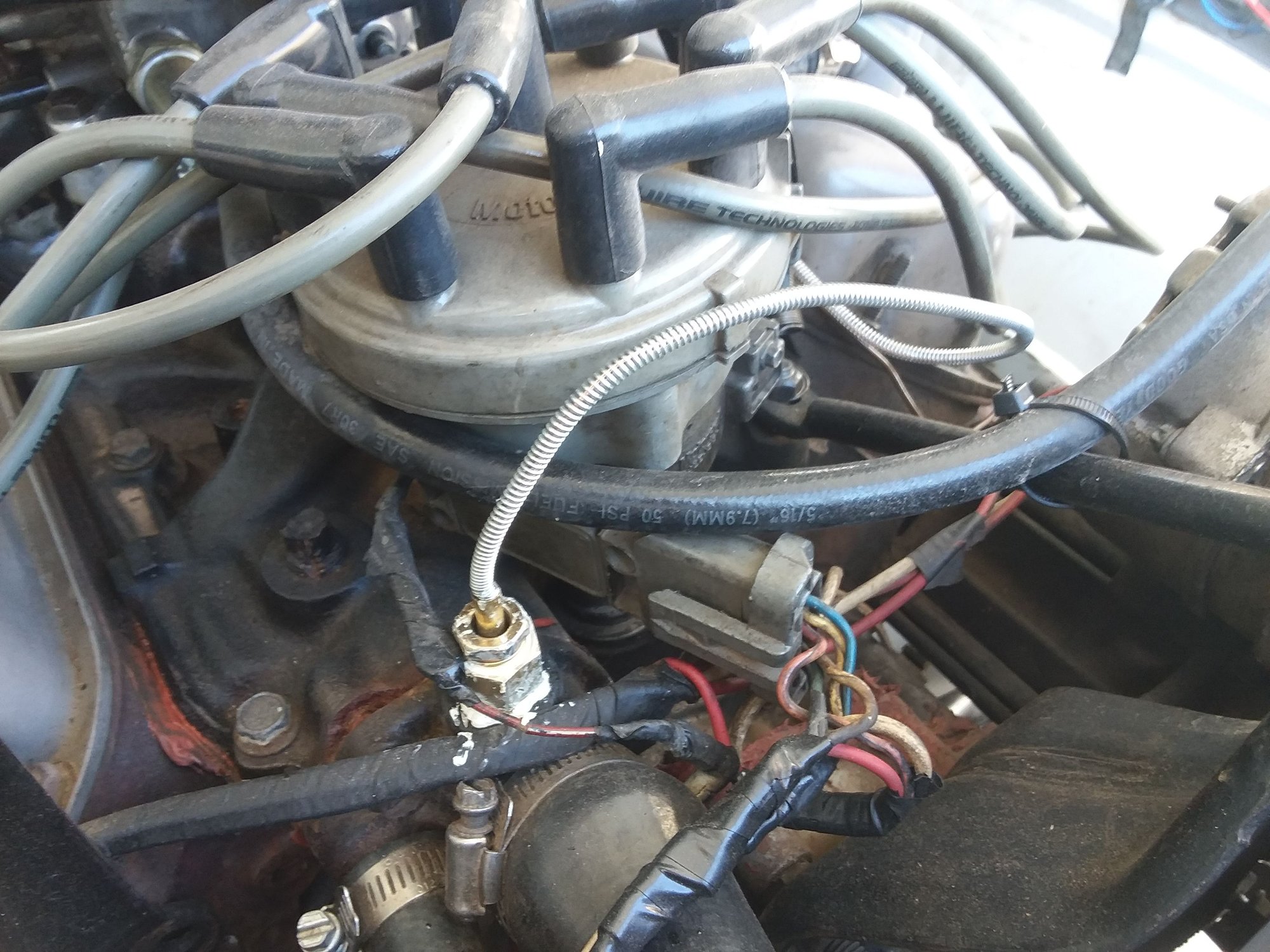

That distributor looks to be from a vehicle with EEC-IV, it's computer controlled. All you can do is set the initial timing and you have to disconnect a single wire connector, "that I can't see in your picture" to do that. Your acceleration problems may be more complex that you think. You are going to have to figure out exactly what you've got ,"year and model" in order to sort everything out. Worst case you can switch it to a regular distributor and carburetor. Is there an engine driven mechanical fuel pump on that engine?

Crop, does the distributor look proper?
The firing order suggests that I have a 351 Windsor. Is that consistent with the photo(s)?

Read post #7, that distributor has to be in a system with sensors they all need to be connected and working and from what I'm seeing in your pictures I bet they're not.

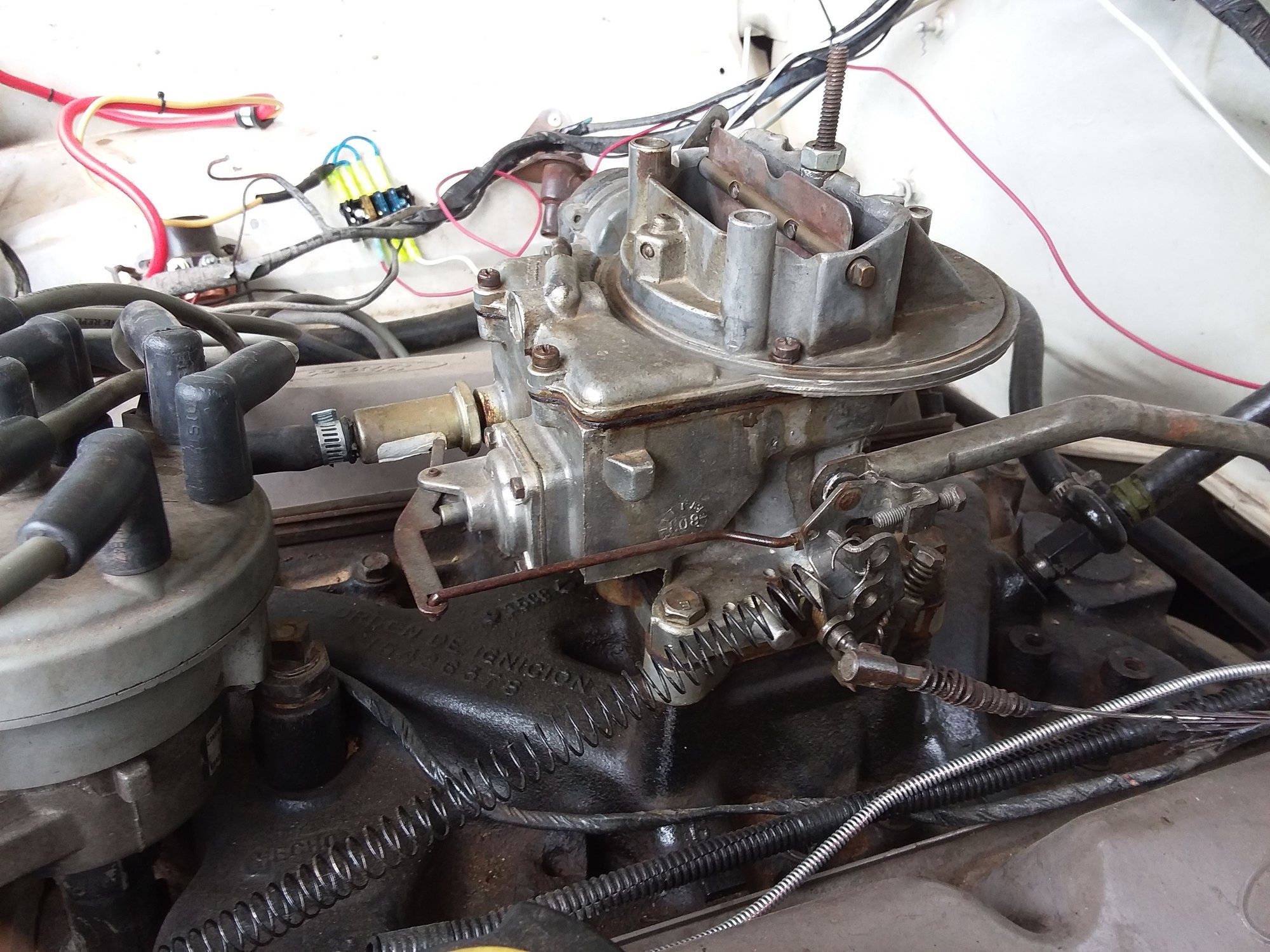

Image of carburetor.
I see no provision for a mechanical fuel pump. It has an electric pump mounted to the frame.
The wires from the distributor - two go to the coil, and the balance appear to go to the voltage regulator - no computer box anywhere.

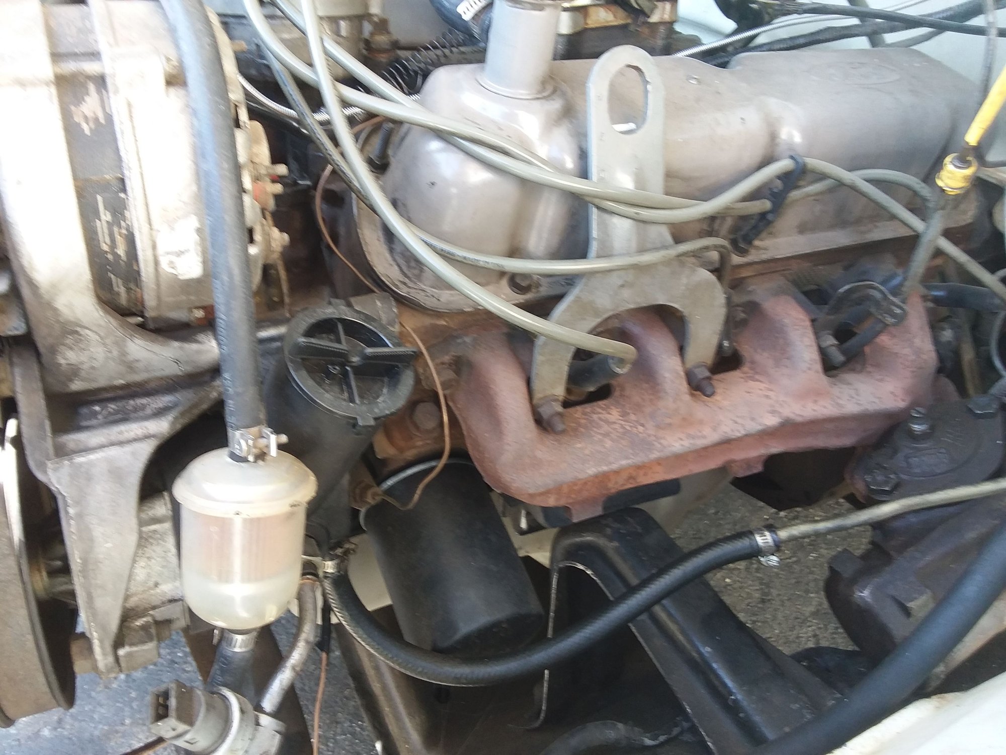

I saw your post after I made the reply. The exhaust manifolds have sensors, though they are not connected to anything.

I think the voltage regulator you are referring to is actually the ignition control module. Like I said that distributor cannot work without sensors the engine may start and sorta run but it ain't going to ever work right. Your best and cheapest bet is to change to a regular distributor and the simplest way is to get one of those Chevrolet looking HEI's. But before you jump off that cliff you have to know for sure if your engine has a regular flat tappet cam or a roller cam. Because they use different distributor gear material and if you get it wrong it will destroy your cam.
