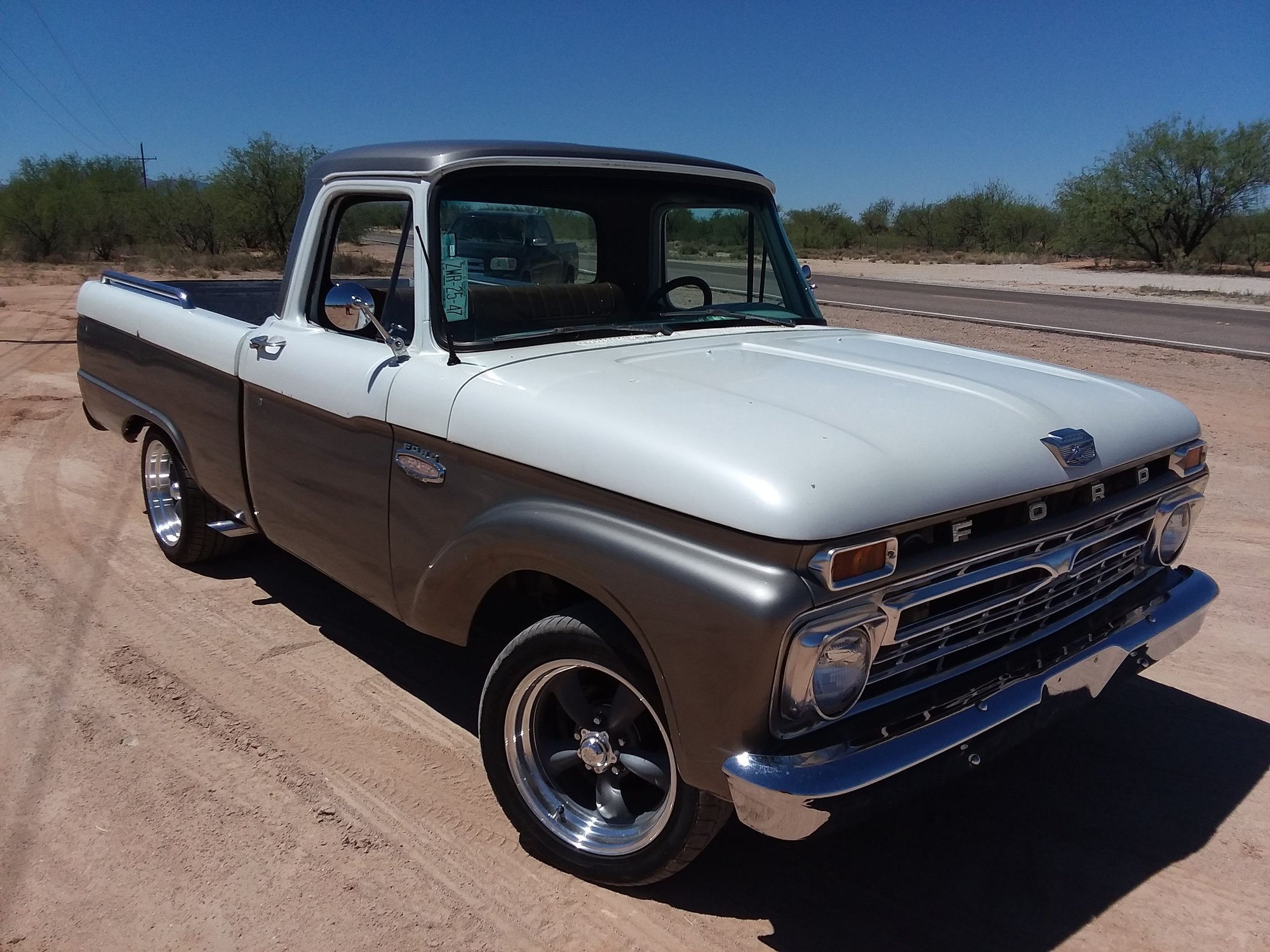

Well you've got a pretty good looking truck. And if was born and raised in AZ. then you shouldn't have much rust if any. Sounds like you have a project though welcome to the club.

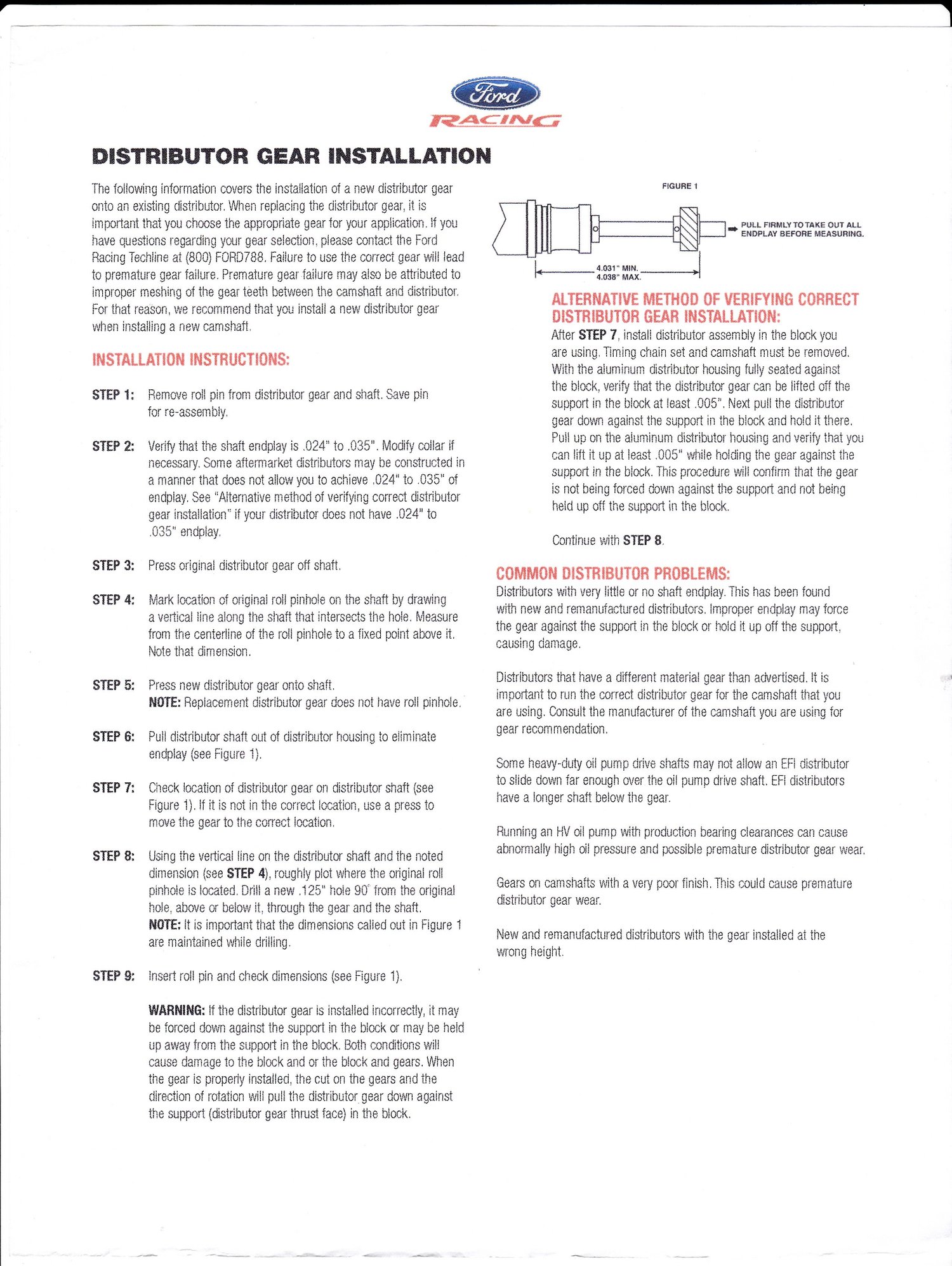

All indications are that the distributor is the cause of my woes. Plenty of non-computer ones out there. Apparently shaft length is important. Gear composition is important too!

In any case, I have ordered a distributor that is compatible with a factory roller cam. Interesting that the distributor of the distributor (!) claims a 5-inch shaft, and my OEM distributor has a 5.5-inch shaft. I suspect the difference is just a one inch versus one and a half inch overlap of the distributor and oil pump driveshaft, and will not be of consequence. I will measure ad fit carefully when it arrives.

I should have mentioned that the EFI distributors had a longer shaft below the gear. That is why the difference in length. Just make sure the oil pump drive rod is fully engaged. I don't believe that will be an issue. Here is a page from Ford Racing on distributors and how to check the gear position it also points out some common problems they have encountered. Like I said in one of my other posts the Chinamen have a real problem getting that gear on in the right spot. So be sure and check that before you run it.
