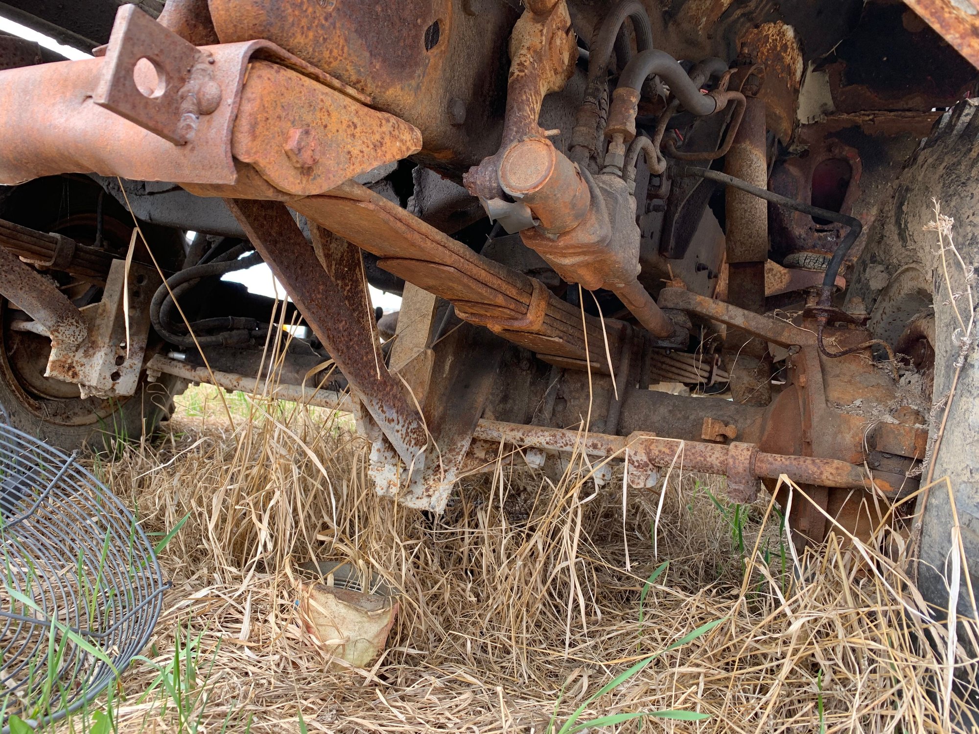

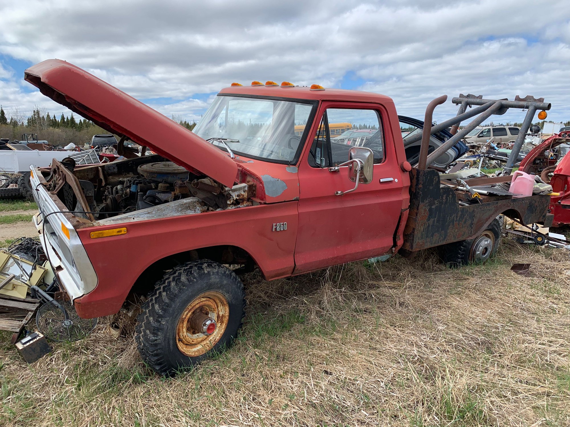

70s f250 custom
what looks to be a d60 but think its a closed knuckle d44
also found a SD f250
i think its a d60 but might be a D50 solid axle
so now debating witch axles to grab for my truck! no mater what il need to rebuild both axles ! each set is 500$ the guy want's

If you pick the 70's axle, during your fabrication you will notice the pumpkin is awfully close to the front crossmember on the 80's frame. People usually have to run a small lift for it to clear.
Sometime later Ford went to coil springs on their f350's. I think they are dana 60's. Don't know if the coil spring pockets would line up with the f150 spring pockets or not.

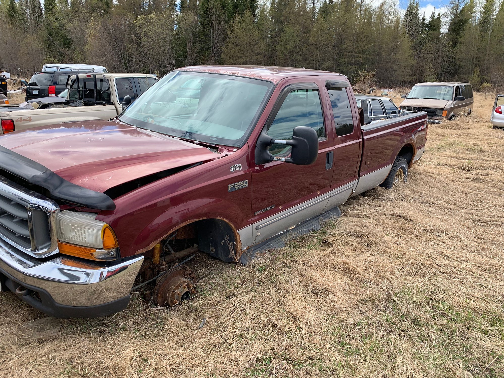

well got my self 03 superduty axles D60 and rear matching but will need full rebuilds ! for free ! also got a donor truck a 97 f250 single cab long box with a 7.3 and 4x4 manual that recently flip and ditch and some how only the body went to **** and the rad and waterpump! so now this project just took a new turn ! plan now is full bullnose body swap ! get a RSK and insert my new SD axles going to A/C delete and try run the 85's climate controls setup prob try salvage the hydroboost powersteer from the obs just now im debating if i can run the bullnose interior but custom dash setup! might just try retrofit the obs gauge cluster into the bullnose dash and hack at the wiering isolate all 7.3 **** together on its own fuse box and the auxiliary stuff like lights/heat/wipers/sound system and what ever on its own fusee box and wiering!! also due to going to free up the frame from the body might sand blast the frame and fresh primer and paint ! also thinking 4" DP with 4" exhaust , full engien rebuild, E-fuel conversion , maybe stage one injectors and upgraded HPOP and if i can locate a inter cooler might also try fit it under the hood!
she seen better days !
picking the donor in style !
started to take it apart! frame is all good! no stress marks looks like the body lift saved the frame
hmm what can i salvage
will need new radiator, belt, waterpump and clutch fan!
