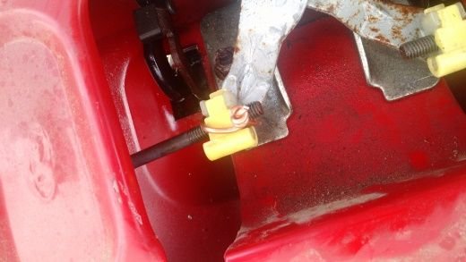

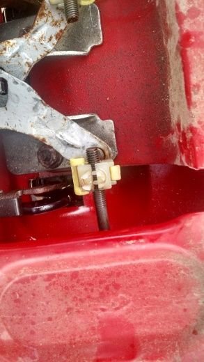

I'm a sweat ball now. Fixed the linkage issue. 8 T30 head screws to take the access plate off so of course I had to go get another T30 bit because I couldn't find the one I had. Once the plate was off the problem was obvious. There is a plastic holder on the threaded end of the linkage that snaps into a hole. The little ears that hold it in the hole were broke off so it would not stay. I really didn't want to order one and wait and I really didn't want to go rummage thru a salvage yard to find another one sooooo.... I rigged it. Stripped off a 6" piece of solid copper wire and used it like a wire tie. Spritzed the whole mechanism with WD for lubrication since it's never been opened and it is a 96 Ranger. Tested it out several dozen times and it is rock solid so if it lasts me a few years then great.
ears broke off the plastic holder
rigged and solid and the whole works spritzed with WD
