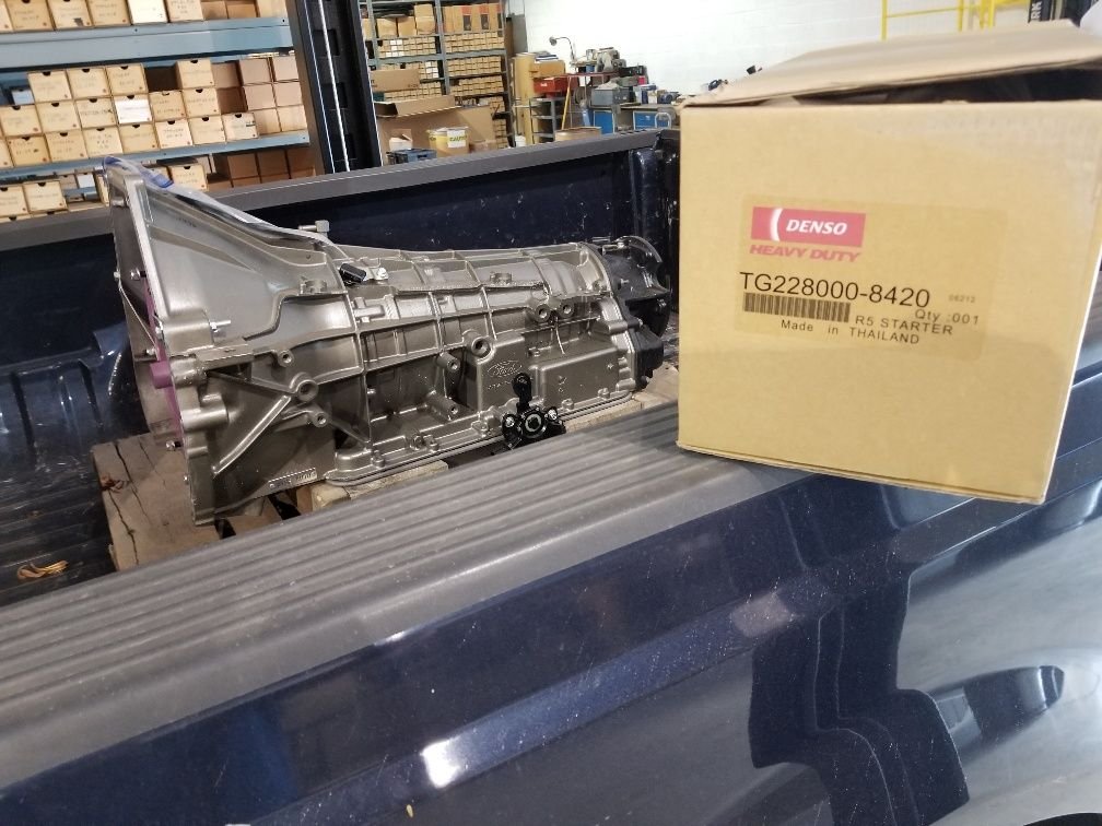

Finally got everything done. Also at the same time had both drive shafts rebuilt added a 6.0 cooler and a original Denso starter from CNCFAB. During the tear down I discovered my flexplate has seen better days. So off to Ford to buy a new flex plate.
First impressions: Shifts firm not to harsh. I'm still breaking it in but the Precision converter definitely locks up much better then the stock one. Only put 60+- miles on her so far.
Can't wait to see how the 2K stall on the converter works with my set up. In about 600 miles.

Congrats on the new built tranny. When I was 4r100 shopping a year ago, the Wyse stage 2 was one of the options I considered. I ended up with a built unit from a reputable local shop for about the same the Wyse unit would have cost after the 6.0 cooler and installation.
good luck with the new unit. The guys on the .org speak highly of the Sam Wyse builds.

Trans is a beauty! Look forward to hearing how it works once you have some miles and maybe some towing on it. Do you know the stall on the converter?
Went with a 2k stall. Just a little more than stock.

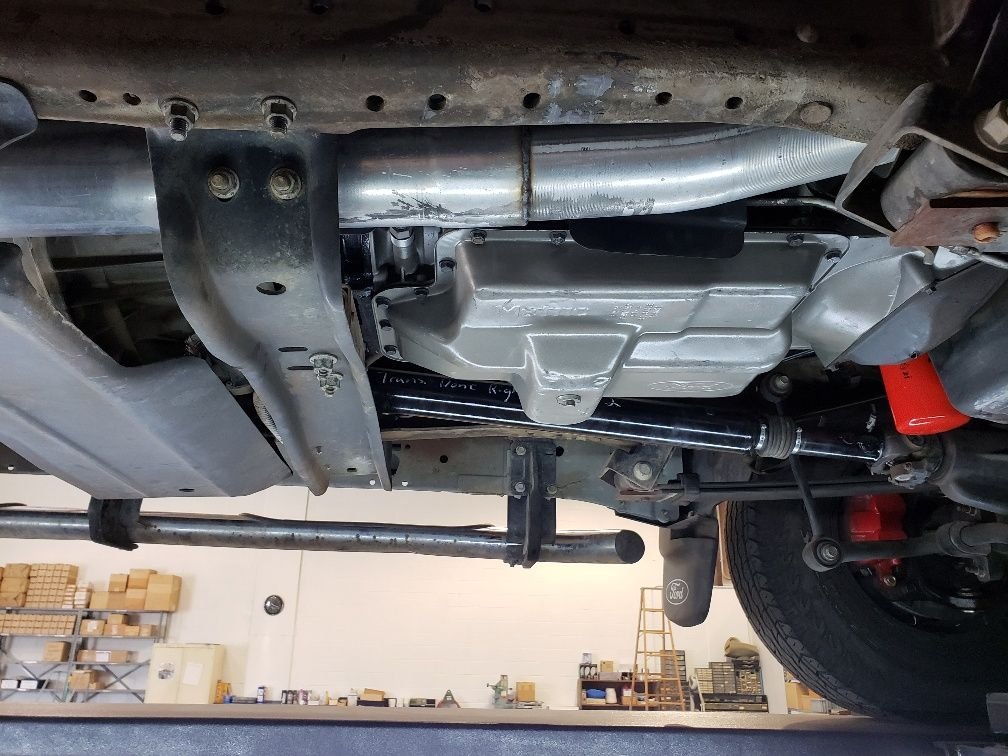

Old Aug 14, 2018 | 11:59 AM
Macmathews's Avatar
Macmathews
Joined: Dec 2009
Posts: 661
Trans looks amazing - Keep us posted..
Also please share the details on the drive shafts
Kyle
Thanks!!
I had a local shop tear both of them down completely. Sand blast replace the u joints with Spicer greasable u joints. Had the slip shafts gone thru and a Spicer center support bearing installed. And had both of them balanced. Also had them remove all the factory weights before balancing began.
Well worth the expense. Trucks butter smooth now at freeway speeds.
