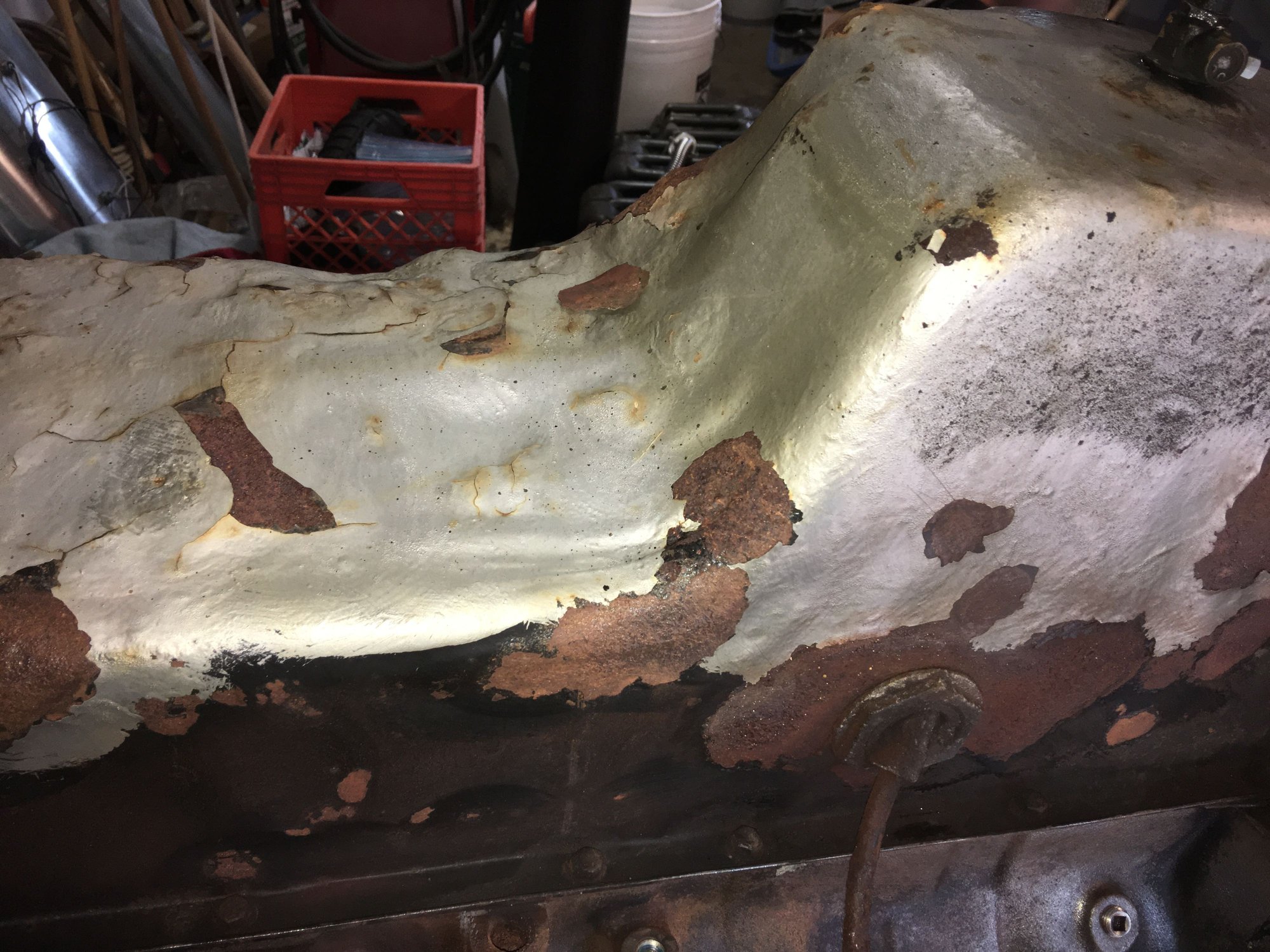

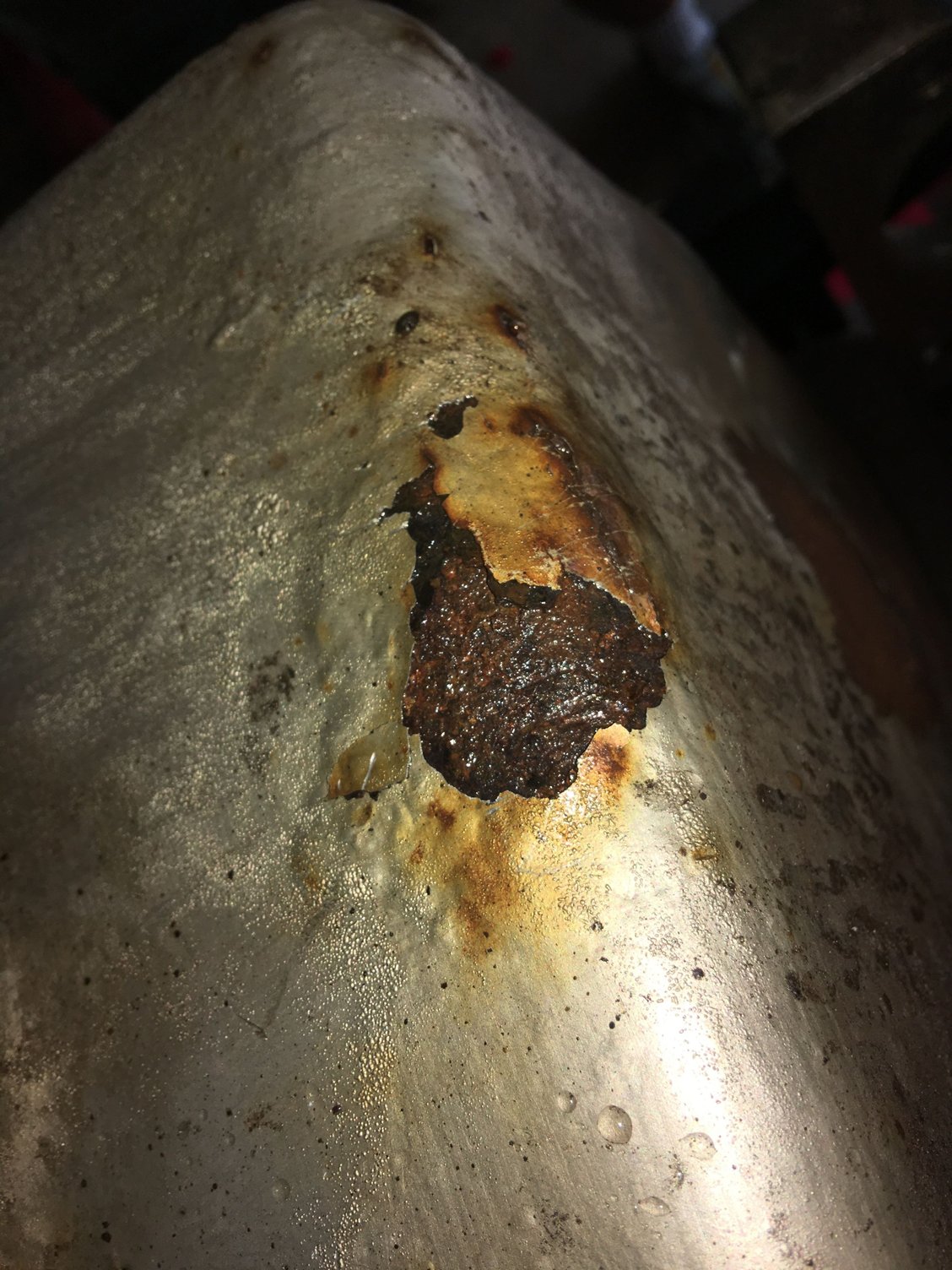

have the engine out replacing the oil pan. Wondering if I should replace the lifters while it’s out. I have no problem with hem at all but it would be real easy to do at the moment. Truck has 230k on it. Im also open to suggestions of other item to address while the engine is out. Parts being replaced are: oil pump, oil pan (using adhesive not the gasket) piston cooler jets (brazed), harmonic balancer, rear main seal, turbo rebuild w/ new wheel, exhaust manifolds, up pipes, dipstick tube assy, steering gear, considering injector cups and prongs (stock injectors), Head gaskets (just because I want to check valves and pistons), glow plugs, power steering pump and hoses, a/c condenser, motor mounts, fuel lines on engine and flex lines that connect to them. I think that’s everything. I’ve been running Rotella t6 synthetic since I purchased the truck at 93k and all looks great inside. Thanks in advance for any recommendations.
