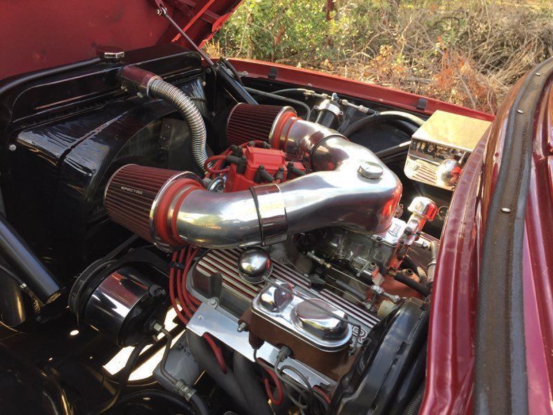

I'm running a Ford Racing Crate Engine, a 427 Windsor, which uses similar heads to your 302. I have installed a Ford Racing small block header set which, unfortunately, is no longer produced. This one:
It has 2.5 inch diameter exhaust collectors with threaded bungs for O2 sensors for the EFI system. I will install this Magnaflow exhaust system kit made for the 48-50 F1 flathead engine. That kit has 2.5 inch exhaust pipes.
https://www.magnaflow.com/products/1...exhaust-system
I hope this will give you some ideas on what to use.
