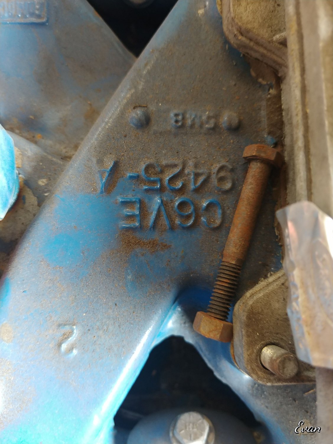

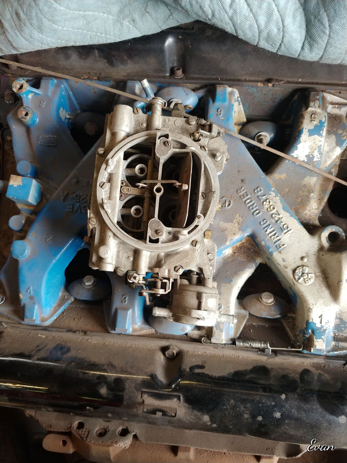

So I checked out the motor. The number on the intake is c6ve so that would be a 462?

Old Aug 3, 2018 | 11:58 AM
85e150's Avatar
85e150
Joined: Apr 2004
Posts: 34,475
Likes: 2,800
462, RUN!!!!!

Yea... Thats a bummer I got really excited when he said it was a 460
Old Aug 3, 2018 | 01:51 PM
somethingclever's Avatar
somethingclever
Joined: Dec 2008
Posts: 3,211
Likes: 321
From: SW PA
Yep def 462
Old Aug 3, 2018 | 02:40 PM
mark a.'s Avatar
mark a.
Joined: Mar 2004
Posts: 8,922
Likes: 153
Boat anchor....
