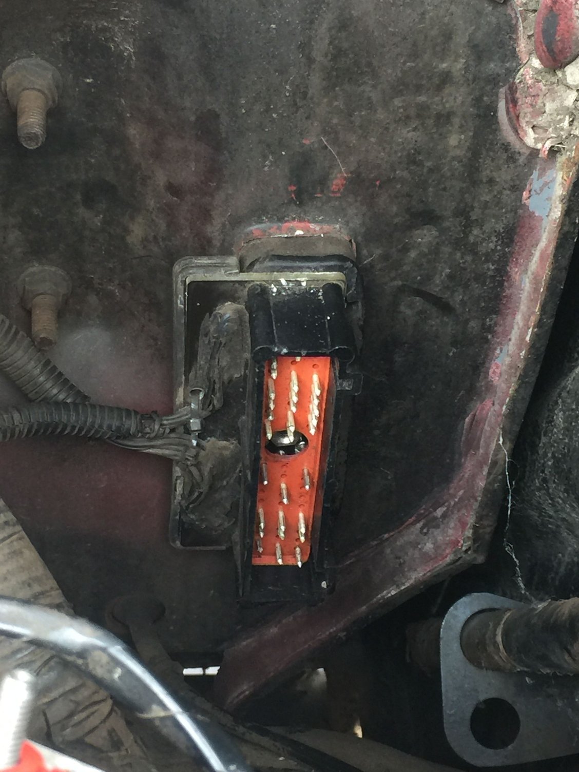

Trying to replace the ecm on my 88 f350. I’ve undone the 10mm bolt from the wiring harness and pulled the harness. It seems there is another plate with some wires in it that is still attached. Ecm won’t come out through the dash with them attached of course. Do I pull hard or is there a connector I haven’t found yet?

On the 8th gen trucks like yours,the ECM's come out though the inside of the cab.Remove the kick panel and you can access it there.On the 9th gens (92-96/97hd) they come out through the engine bay like your trying.

Found out why my setup is a little weird. I forgot I had the Ford Motorsports mad conversion kit. Hey it was 17 years ago! So I got the old ecm out and find that it’s not a stock ecm. That means my used one doesn’t work right. It fires up which is better than I got before. But obviously not running right. I think it’s a Mustang ecm but not positive. Anybody with experience on this particular system? Thx
