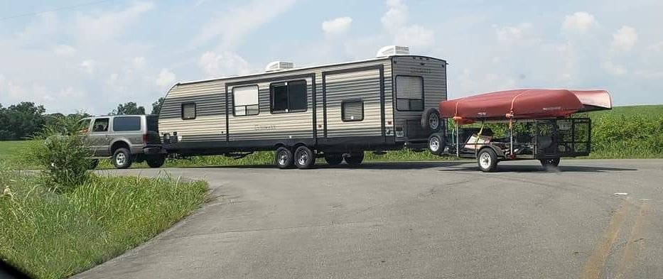

I finally took the Excursion up to Ft Mountain State Park this weekend. This is the first time I feel like its towing ability has been tested. It's a 2100' change in elevation spread out over about 8 miles but the grade isn't constant so there's a few flat spots interspersed between some pretty steep grades. I was pulling my Cherokee 304BH which scales just over 10k and a small trailer loaded with canoes and kayaks. I found that I could easily go faster than I could take the curves and was able to accelerate at any point during the climb so those 4.88 gears are paying off. The transmission finally leveled off at about 215° and the engine temp reached 228° a couple of times. I'm wondering what kind of temps others have seen in similar situations? 90° ambient temp, 25-40 mph, RPM ranging from 2500-4000. She did put some oil out from somewhere...guessing either rear main or trans front seal because it dripped some down onto the exhaust from out of the bottom of the bell housing...wasn't much but it only takes a few drops on a hot exhaust to make a bunch of smoke.

Is that allowed in GA? Most states require a fifth wheel for double towing.
