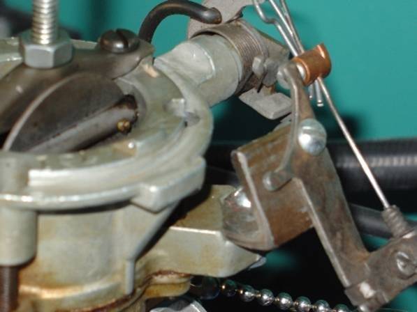

Since you just added manal control to the choke housing it could be hanging up on the fast idle cam a bit . In normal operation the fast idle cam adjusts when the throttle is depressed . If you are trying to move the choke with the throttle released you may be dragging on the fast idle cam, a good rule of thumb with these choke cap setups is to have have the throttle depressed a bit when using the manual choke True manual chokes have a different set ups for the fast idle cam that negates this issue. Do not worry about the choke pull down it will have no affect on your manual operation and is just along for the ride now..
Now to the core of the issue , your support of the cable sheath it is not close enough to the end of the cable. If you look at manual chokes the support is quite close to the end of the cable.
See below pic of a carter 1BBL with manual choke. You will have to find a way to secure the cable sheath closer to the end. This will solve your problem.
Thanks for pointing that out, I didn't even look at that part in his picture. The manual choke kits used to come with a small universal L bracket for that purpose. Everything you get like this that is universal always takes a bit of engineering to get it working correctly.

Sounds good. I drove a few places today and it seems to work great after a few adjustments I made this morning.
My kit came with a bracket. I'll see if I can mount it on the carburetor body or something, but there isn't a whole lot of real estate for space in the area.
Since my cable comes up from below the carburetor rather than the side, it's a little hard to get a bracket near it.
