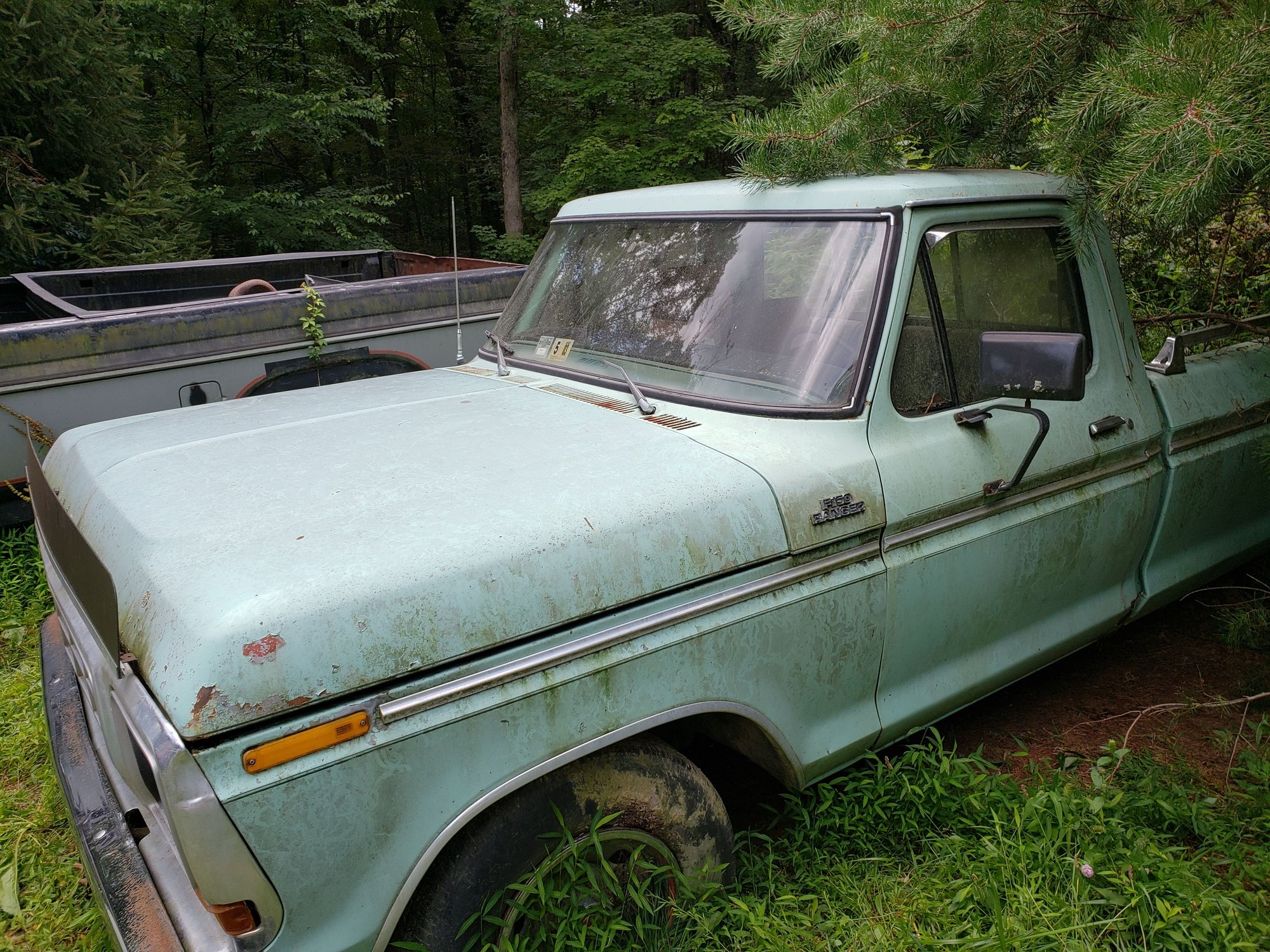

I found out it's a 79 with 78 lights lol but have you done this

Like the truck. It has the narrow dent trim like my Magnus.
